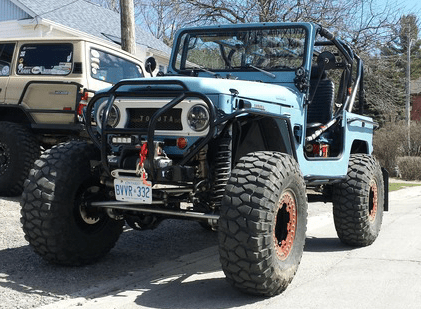

I run coils and radius arms on mine with a 5" stretch out front and 3 to 4" out back with fj60 leaf packs outboarded and soa'd (gotta measure the actual wheel base one day). It rides pretty damn great with the coils and compared to the rear end the front is a lot smoother and less jarring over the bumps. Could probably use a sway bar but thats another story.

So, what you are doing is turning the FJ40 into a more modern design. Actually, it becomes less FJ40 with every mod. That said, it is fine as each person has his/her desire for what they want in a vehicle. I have seen FJ40s that all that was Toyota was some body parts. The FJ40/45 were built for toughness and not creature comforts. You can tell from later models, 1982/83, that comforts were coming. The FJ80 was real comfort compared to the FJ40. I am a purist but I do respect mods that people do.

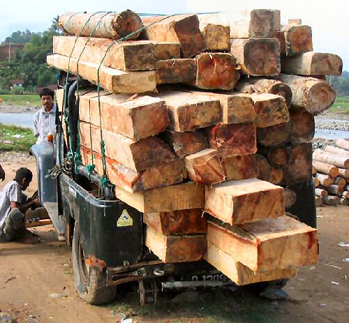

Here is an image from MUD here of a hard working FJ45 , doing what it was built for.

I don't and will never haul massive logs with mine just like the majority of people in this site so.....
