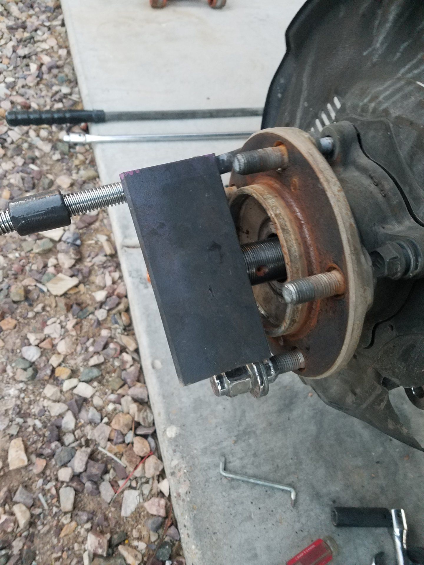

I used angle iron, lug nut, and c clamp to press the axle out. View attachment 1493225
I noticed you loosened the hub bearing bolts. They are not necessary to remove for tundra conversion. The entire steering knuckle comes out, once you disconnect both control arms, tie rod end and kdss end link. Hub bearing bolts are only removed when replacing the hub and bearing. Bearings are pressed into hub.
The picture was from when I did the brake conversion .
Just seemed helpful, as i used the same technique the first time i did the suspension.
