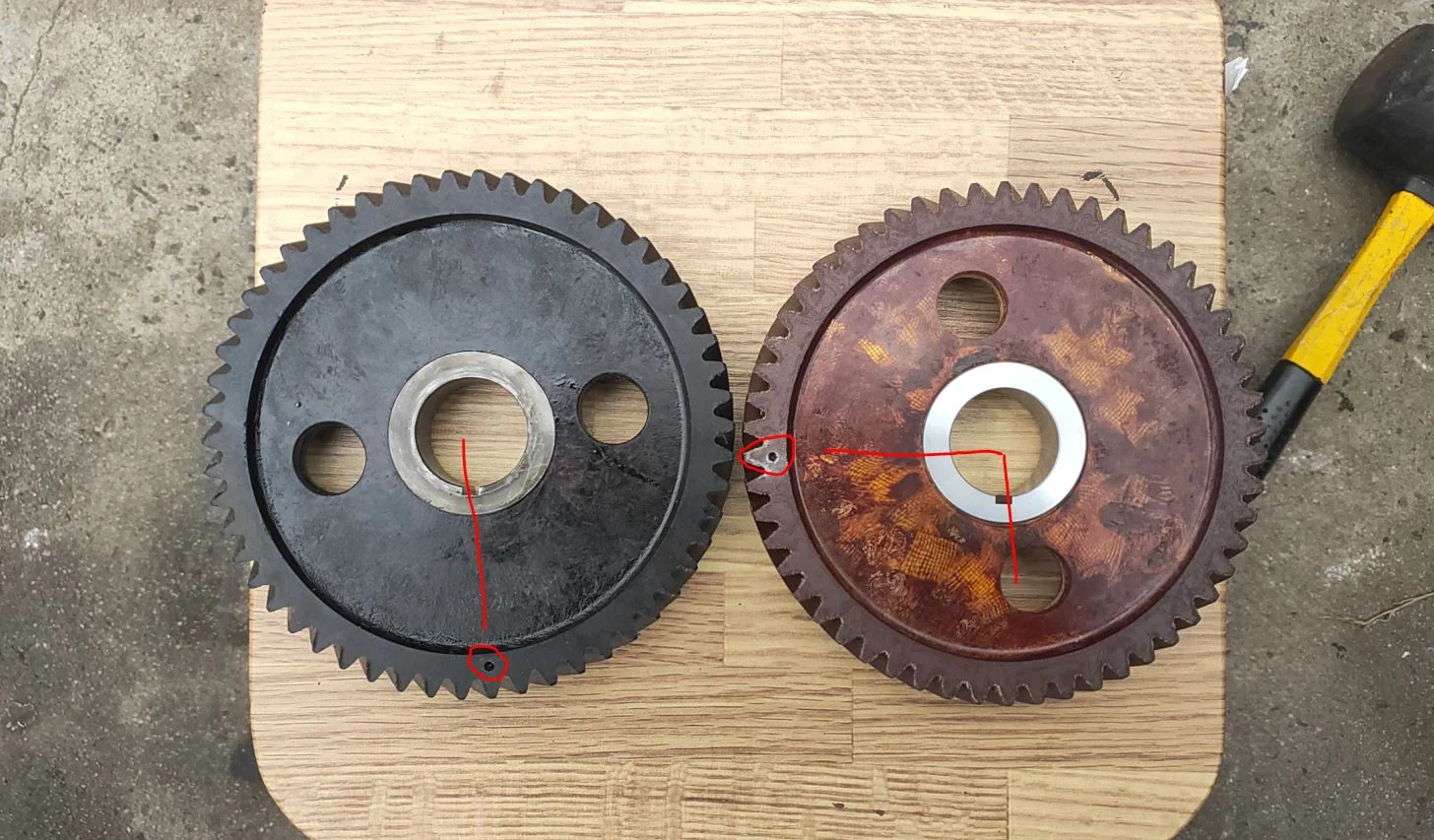

I'm not crazy... 3fe cam gear slipped 10 degrees

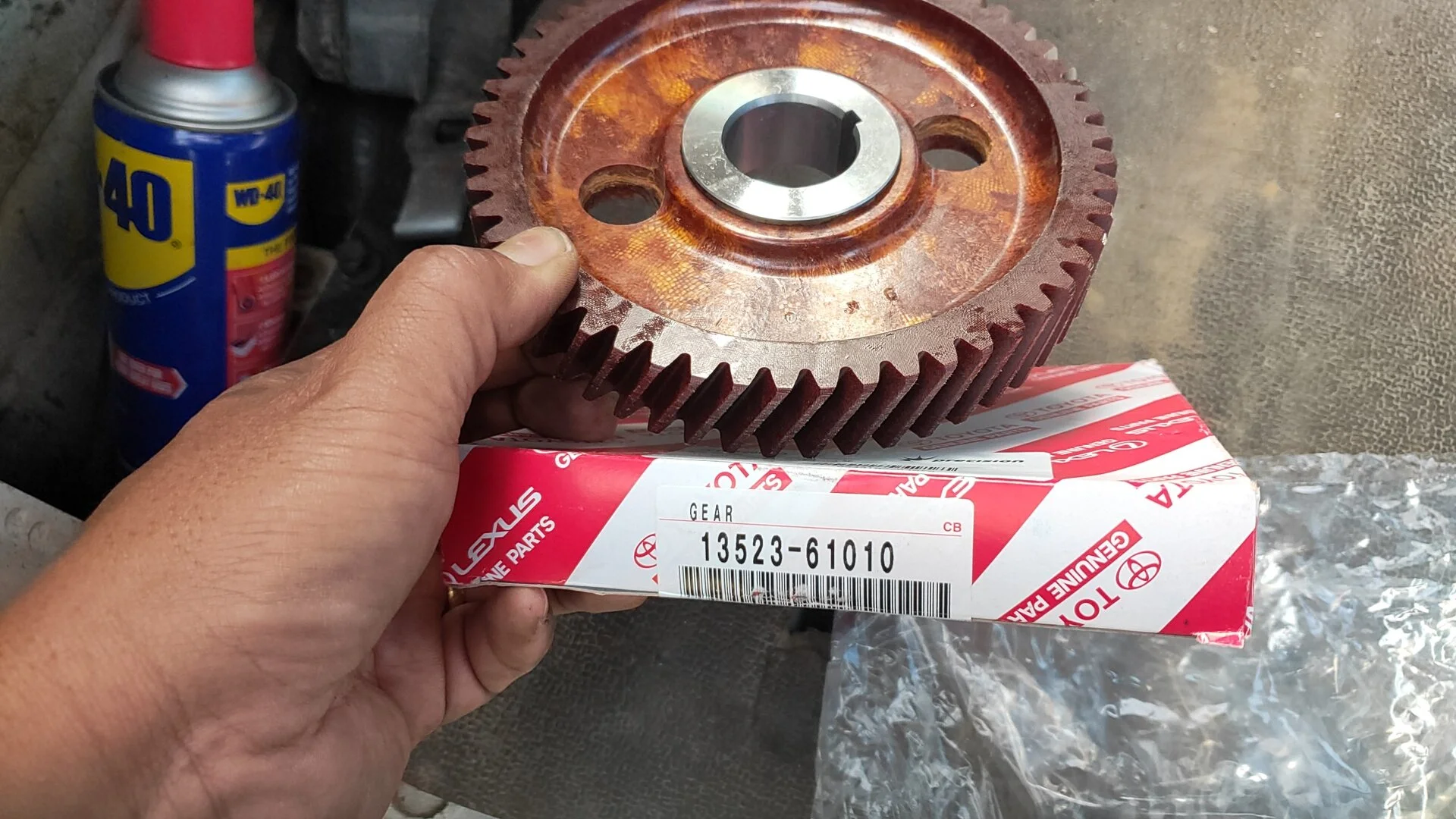

I went with a new Toyota composite gear, because I have yet to see any threads on those failing and if this one lasted 200k+, why not stay stock? Not trying to argue, I am just curious as to why everyone seems to always go metal.

Yes, the fiber composite gear is a known weakness. Toyota changed from fiber composite (early F) to all metal (mid F) then to a steel outer gear with elastomer ring (late F & all 2F) then back to the composite. It was done to reduce gear whine.

If any one cares, the cam is out and I was able to get a better video of what is happening. The composite gear is rotating on the metal center hub. Any thoughts on how this might have happened? In all my searching I can not find anyone else with this issue in a 3fe...

My gear slipped much more than yours. Let's say... 90 deg!
It was a blessing in disguise as the engine wouldn't run at all (no compression) and did not have the chance to burn valves etc.
I "simply" replaced it and all worked normally now. No bent valves/pushrods etc. phew!
