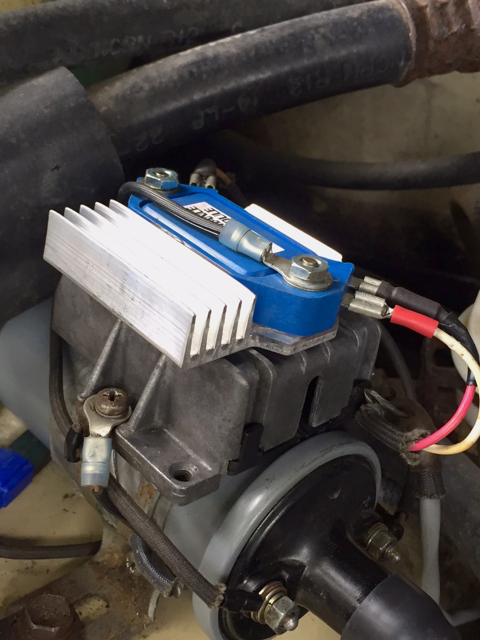

Late update on my cheapo igniter repair.
My truck had begun running rough after about an hour of driving--misfiring, backfiring, barely staying alive, etc. Every time it did this, though, it would be fine again after cooling back down for a bit. After ruling out vacuum leaks, I figured that the igniter was overheating. In testing this, I managed to kill my igniter. That's fine, I figured, I'll just have to get another $15 GM HEI four pin igniter and put a regular heat sink on it. Clearly the aluminum case from the OE igniter wasn't enough, and a better heat sink should solve the problem.
In looking for a good heat sink, I came across the following:
http://www.amazon.com/gp/product/B0012P2EQU?tag=ihco-20
I had to drill out the mounting holes so that the igniter would sit on it flush, without hitting the innermost cooling fin, but that was pretty easy.
Installed in the truck, the new igniter with the new heat sink now looks like this:
I haven't had the chance to drive it long enough to see if it gives me the same problem with overheating, but I'm cautiously optimistic.
Well that's a pretty interesting find. Has it run well otherwise, with the GM module? I'm very curious to find out if there are any differences (performance, economy, smoothness when running, etc) between any of the performance (or even OEM spec) GM HEI modules and an OEM Toyota igniter.
