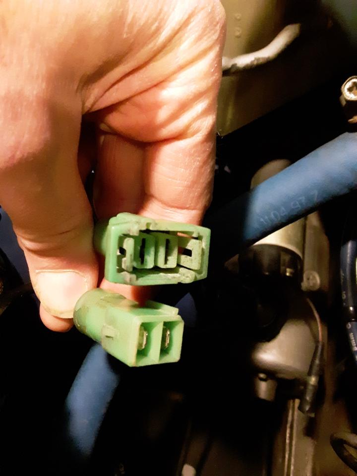

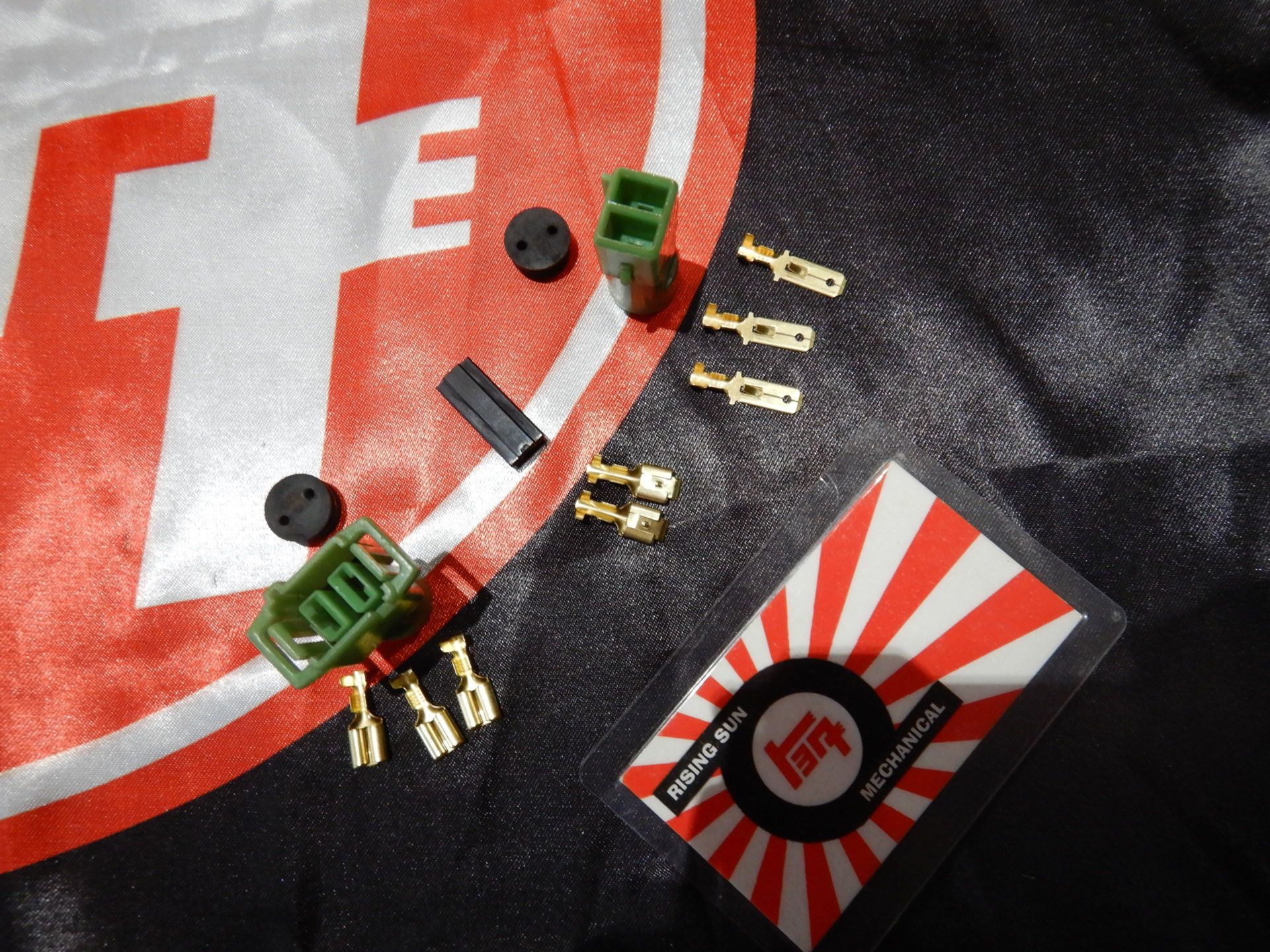

I don't need the connector on the main harness (No. 4 in the photo) but I could use the corresponding one from an igniter/coil harness that plugs into it. If you have one PM me. Or the harness...

Images for Matt
It's the lower of the two plugs I need (male). Same as the Outer Vent Control Valve on a charcoal canister.
Thx

I'm picking up a connector or two from RAGINGMATT to make up the new coil harness and will initially run a coil with a primary resistance of 2.9Ω which is within factory spec for an internally resisted coil (2.6-4.0Ω). If points life is short I'll add in a ballast resistor...if I can find one that keeps me below that 4.0Ω max. Likely it will be easier to buy a different coil with lower resistance.

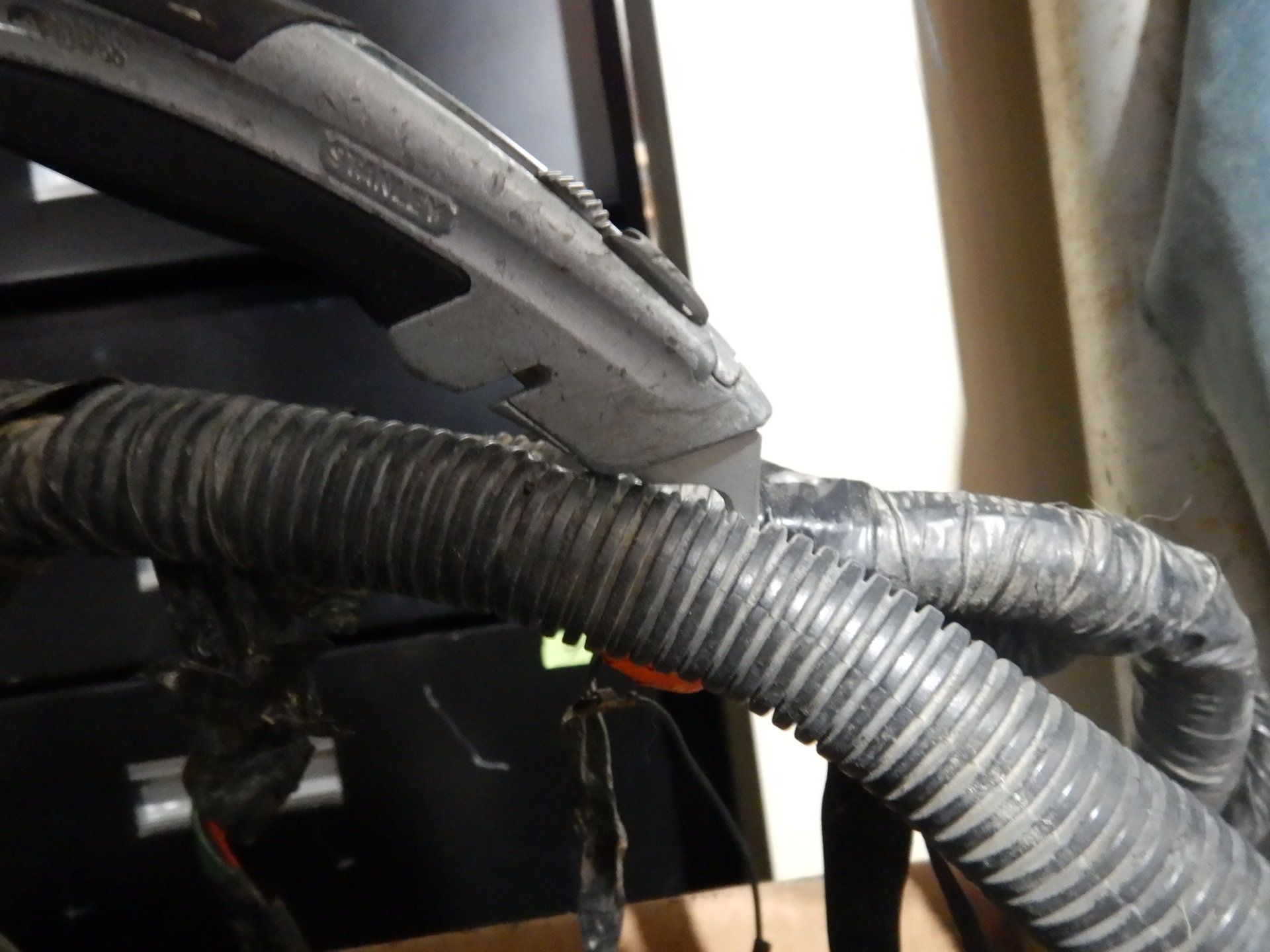

I was curious so i hacked into mine.

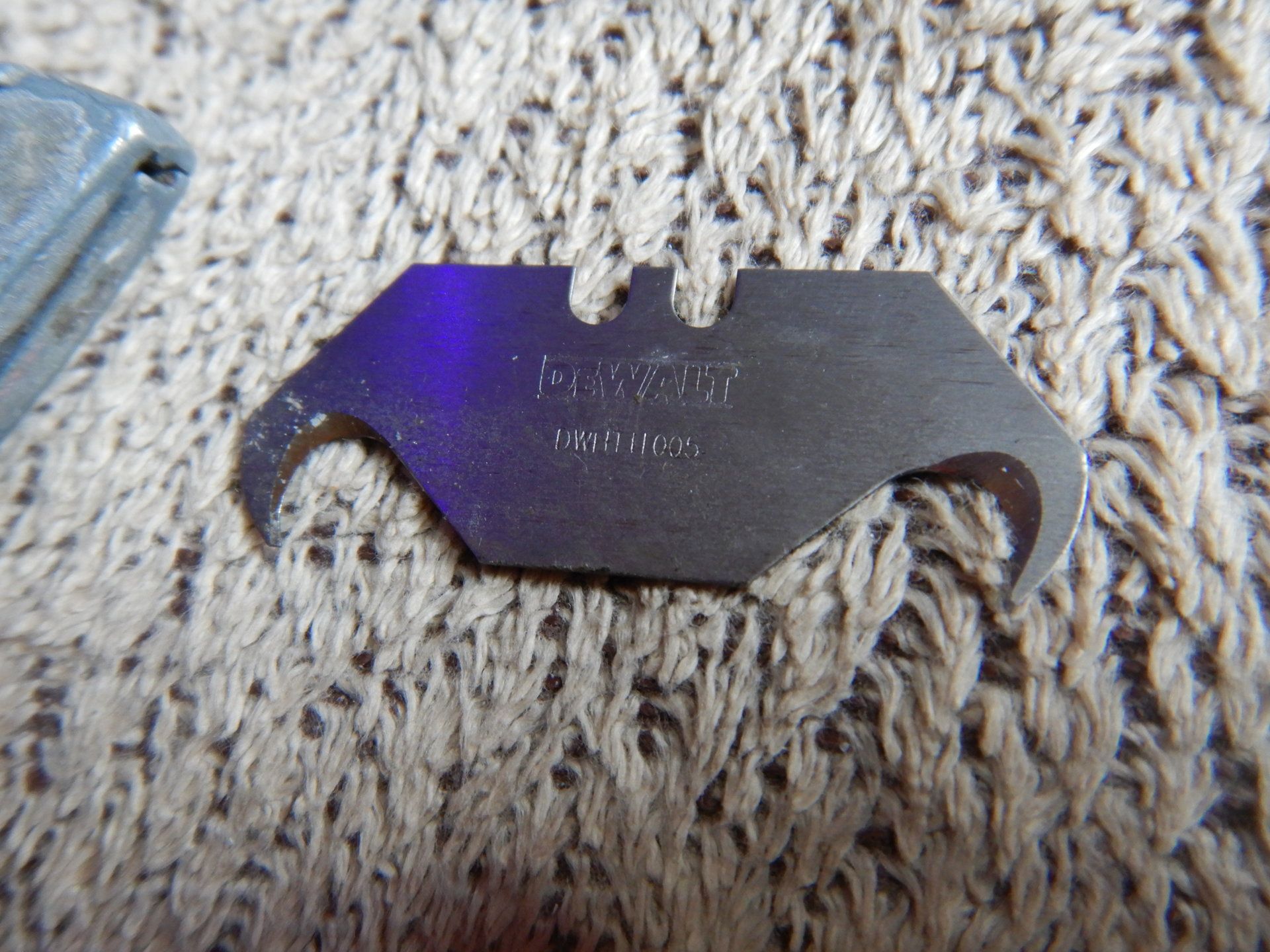

i want to throw something out there , while u guys are Splaying Harnesses open .
i have found these to be 100% positive in every way shape , & form . if u dont know about them already , its the Most efficient
way to remove the outer Harness Jacket , wont cut or nick wires , and Most important Very Safe , as u pull the Hook Blade Towards u
motion . using a straight Blade is Outdated & Dangerous , I switched up after 16 stitches a few years ago Splaying a Harness
and the knife slipped and went right across the top of my Left hand .
just my :

*Thanks for the suggestion Matt. I’ve cut myself more times than I’d like to admit. Had to give myself a few stitches a time or two as well. I will look for your gut hook blade.
