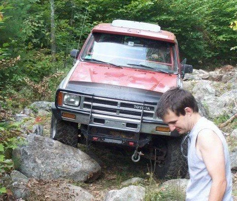

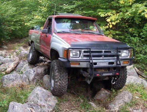

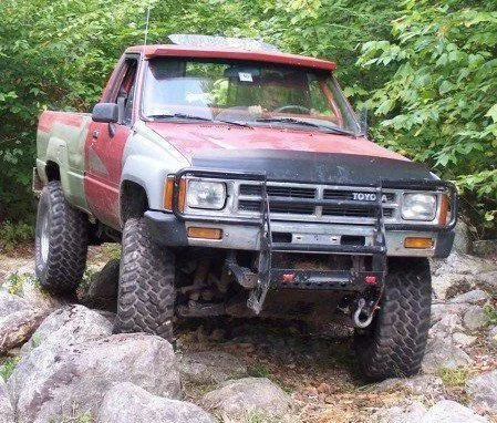

So what's your point with the link Nate???? The short about the Total Chaos kit?? Seriously if that is the exent of your reading you need to do more before telling someone total BS here. PLEASE show me where it talks about the larger t-bars NOT limiting travel. Bottom line is if you are using the stock A-arms and their geomerty any bar larger than stock will KILL your designed travel. PERIOD. Been there done that. Even with my long travel kit, larger 25mm t-bars SUCK compaired to the stock bars in regard to flex. On the street and high speed it's a COMPLETELY different story.
I just have to add this also. In your pics I see no front wheel travel and you are traversing the rocks down hill, which usally loads the front end and forces even stiff springs to flex. If your front doesn't flex with it's loaded it an't worth a s**t. If you can get the front to flex on a climb, unloaded then you are gaing groud.....like this:
