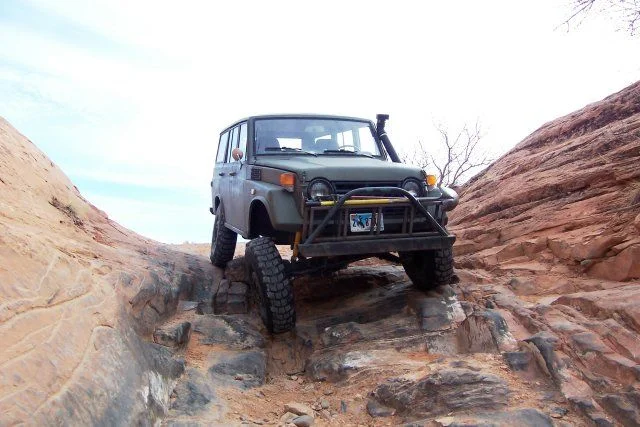

I said nothing about a stock 55/40.
attachment.php
It also depends on what sort of terrain you're wheeling as well that determines the progression of the build/ design. For some areas, height and flex might be more important than something else like stability or even weight carrying capacity.
Solid front axles work awesomely. Combined with lower gears and lockers, the trucks are extremely capable. However, I'm also a big proponent of wheeling the rig you have, unless you know what purpose you're building the vehicle for. SFA sometimes seems like a bandwagon that many jump on and criticize the factory IFS for, even when the limits of the capability haven't been reached. Besides, as you said, one thing just cascades into another. :beer:
You never said you were talking about a modded 55/40 series either. I took the wrong guess :whoops:.
