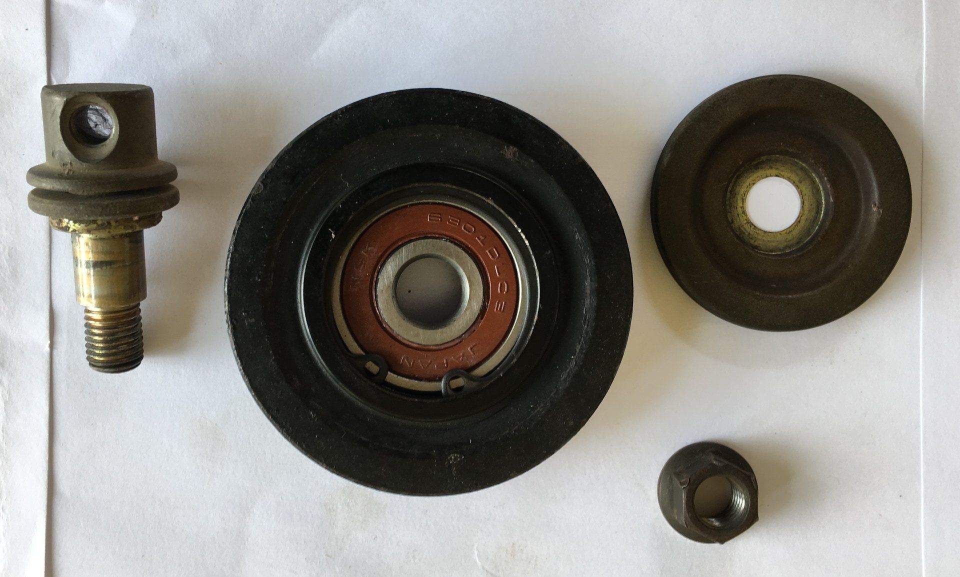

If this is the idler in question, it's (as the gentlemen above indicated) a normal ball bearing, NSK, Timken, SKF, etc.
The bearing number is 6301 DUC 3, i am not a bearing specialist and I believe the last 3 letters and digit correspond to some standard of protection or what covers the balls inside, something like the IP of water & dust ingress.
The pic above is for a bearing I just replaced, and its easy, snap ring off, brass rod and hammer, 6301 is the size (both external & internal)

This is the A/C idler pully assy, NOT the alternator idler.
Yup. That is a good, easy replacement for the AC. NOT the same as the alternator idler pulley. The alternator idler pulley is actually pretty useless. Appears to be designed to reduce belt slap/noise. We have removed/discarded many of these and nobody has noticed/complained about any additional noise.
