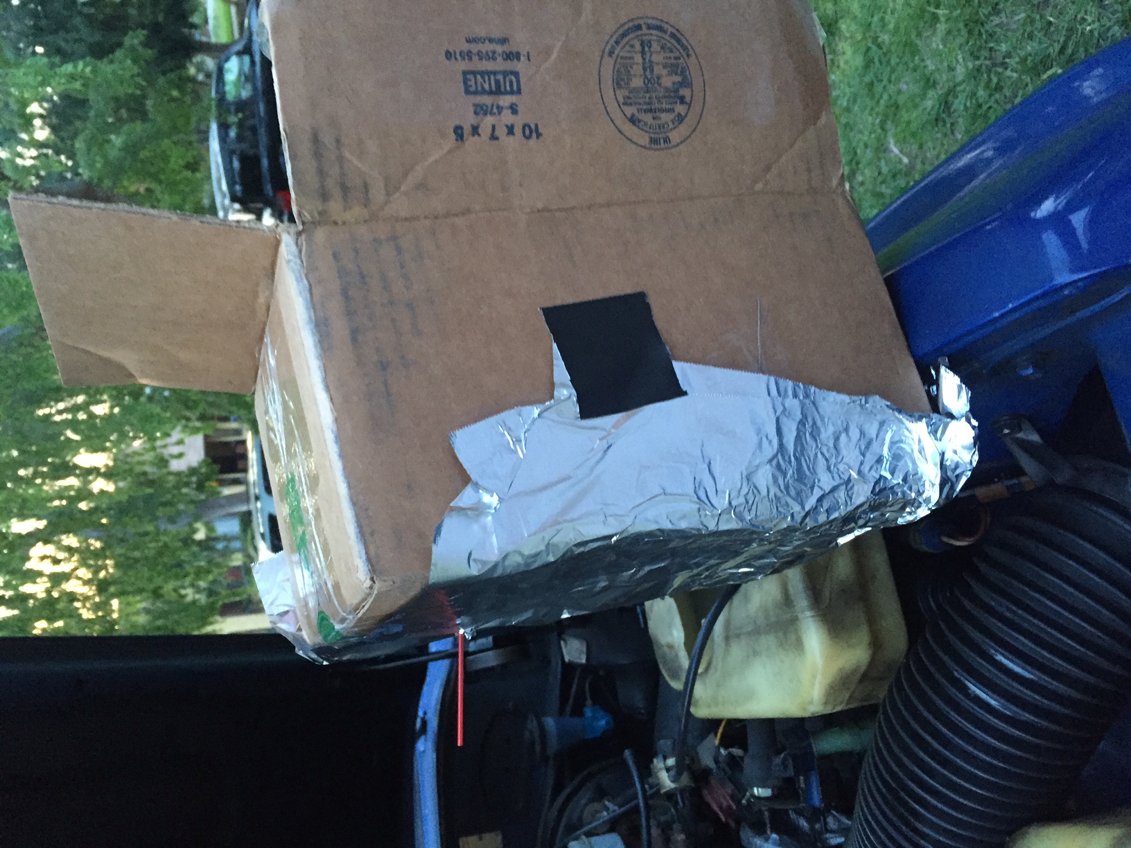

got me some carb cleaner and a fire extinguisher. Don't have a welding glove though. How does one sub with a piece of cardboard? Im a musician and value my hands :)
And am I just spraying into the big hole on the carb top? (I.e. Not into the brass tubes)
Dig my ghetto rig
Carb didn't backfire (I didn't know a carb could backfire to be honest)... so can't say how it would have held up. I have no problem spending $14 but the two hours to get there and back with a car that won't idle isn't so appealing. Nor is killing the only time I had to work on the truck this weekend. It worked out fine :)
