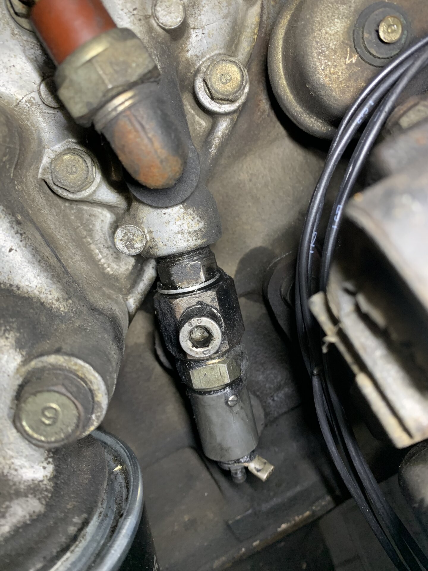

Hi guys, could you help me to identify component near oil switch? ( BJ 42 1982 @ 24v )
what is red components ?
usually I see that oil switch is in right side instead left like mine, is there different if oil switch is on right or left side ?
thx
thx
Is it a glow plug and some spacers/extenders? There should be only a plug and the oil pressure sender instead of that ”oil switch” what ever it is…

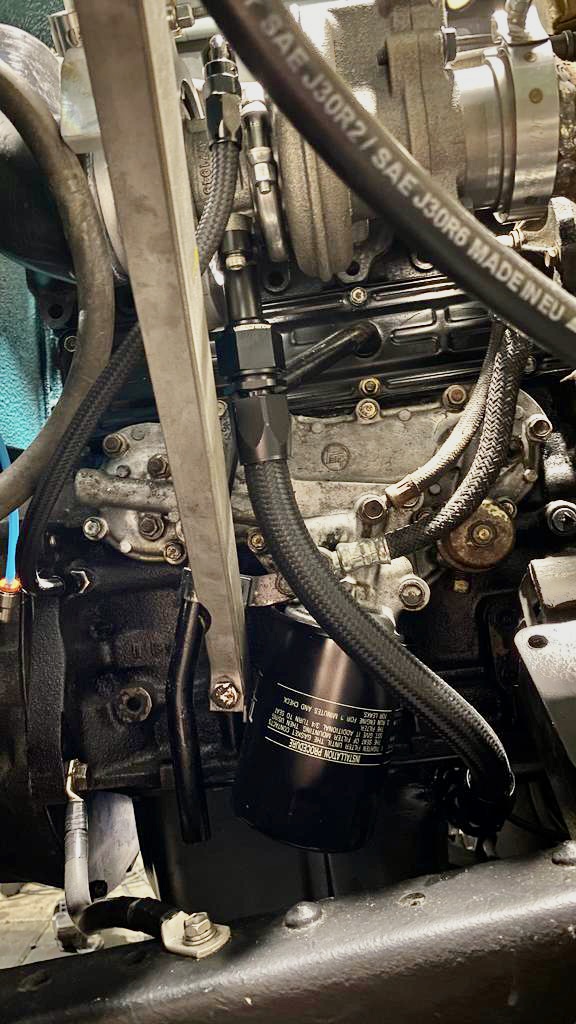

This is how mine looks:
