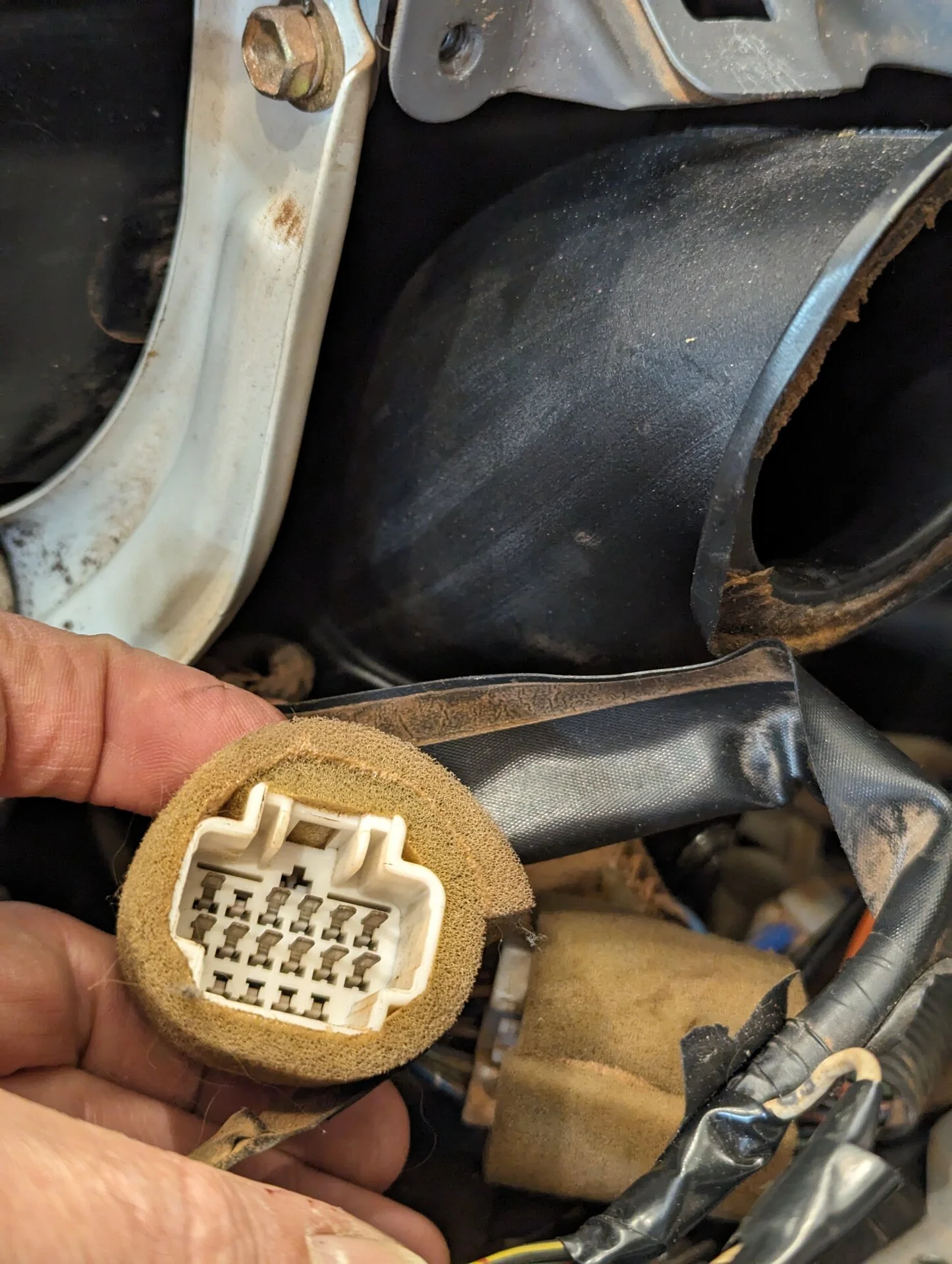

Located near the heater controls in the dash. 1995 HZJ75 24v...
Hello,
From memory.
First picture, left to right: rear wiper, fog light. I am not sure about the other two.
Second picture: clock.
Hope this helps.
Juan
So that says to me that this truck, which is very basic with no rear wiper, no clock and no fog lights originally, has a harness in it to support those things, that might be awesome.

Hello,
Number 3 is the connector for the left-hand speaker.
Number 2 is the main ignition/engine harness. I have not seen it unplugged.
Number 5 is for the power mirrors.
Number 4 may be the hazard switch, which has a different setup in Europe spec trucks.
One of the bulbs below Number 1 is for the air filter warning. The other is not used. I am not sure about Number 1.
Hope this helps.
Juan
#2 is not plugged in and the truck runs as it should. Might it be for trucks with some other engine or transmission?
Hello,
I took the chance to check.
The images below are from a 1995 FZJ73.
This is the left side of the instrument panel. This is the power mirror control connector. Above is the power source connector for the two bulbs on the left side of the panel. In the background, it is possible to see the pink wire for the left speaker.
This is the left speaker connector.
This is the connector for the H4 switch, on the right side of the instrument panel.
This is the connector for the blower fan switch.
This connector is unused on gasoline engines. Blower fan switch connector on the right.
You can see part of Number 2 in the background.
Regarding Number 2, it is used on gasoline engine trucks.
Juan
