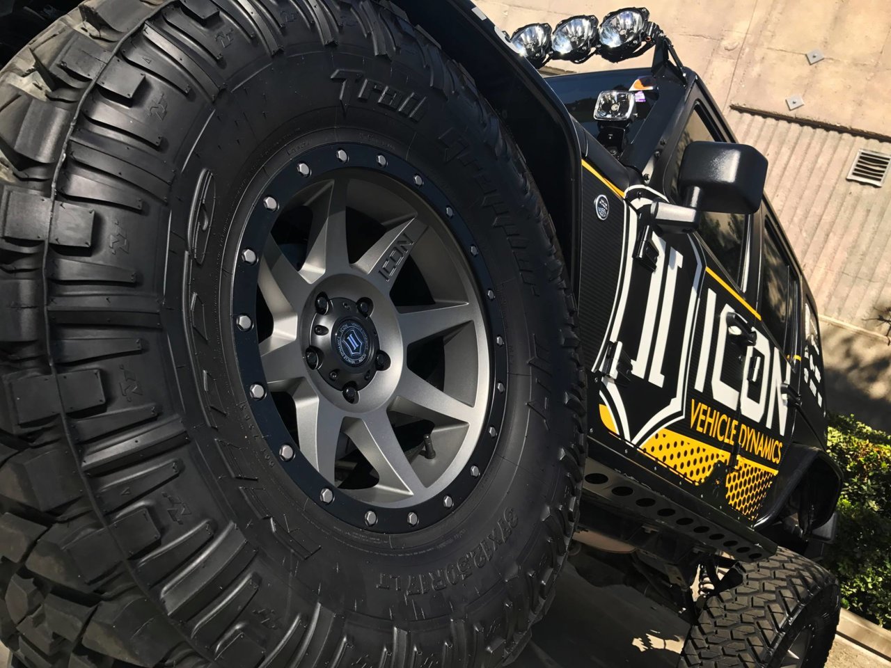

I found this on another forum from 10/5/17:
5x150 is in the works for rebounds, rebound will not be a 5.75" backspacing like the six speed. It will probably be between 4.75 and 5.
22218316_1701298366559935_4115665938105701057_o-jpg.89383
22179737_1701298376559934_7088526620267871540_o-jpg.89384
22135306_1418656481563829_170230862134230010_o-jpg.89385
I spoke with Icon last week. The rep said these should be available within two weeks. So this week or next. Same specs as the six speed wheel and with a bronze offering. I like the look of them.
