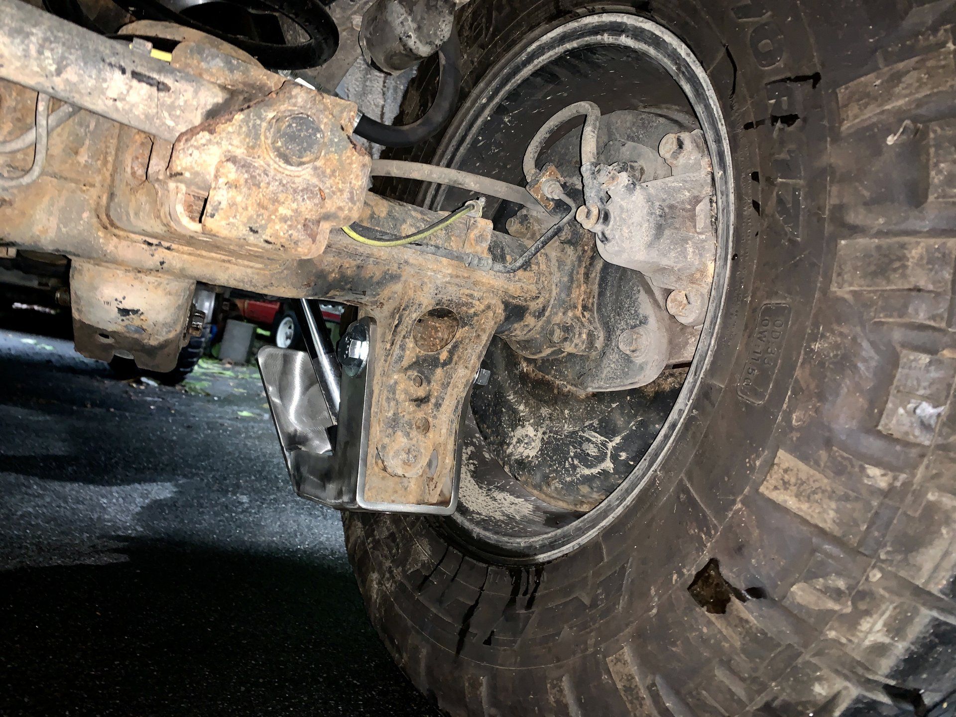

You think having a shock guard would help reduce this failure?
Installed

BudBuilt. I liked how theirs was 100% bolt in. Pretty sure the TT requires drilling.
The TT shock guards are bolt on like the BudBuilt. The BB are stainless steel however, which is nice. The TT RLC guards are the ones that need drilling.
PS, glad you made it home on three shocks.
