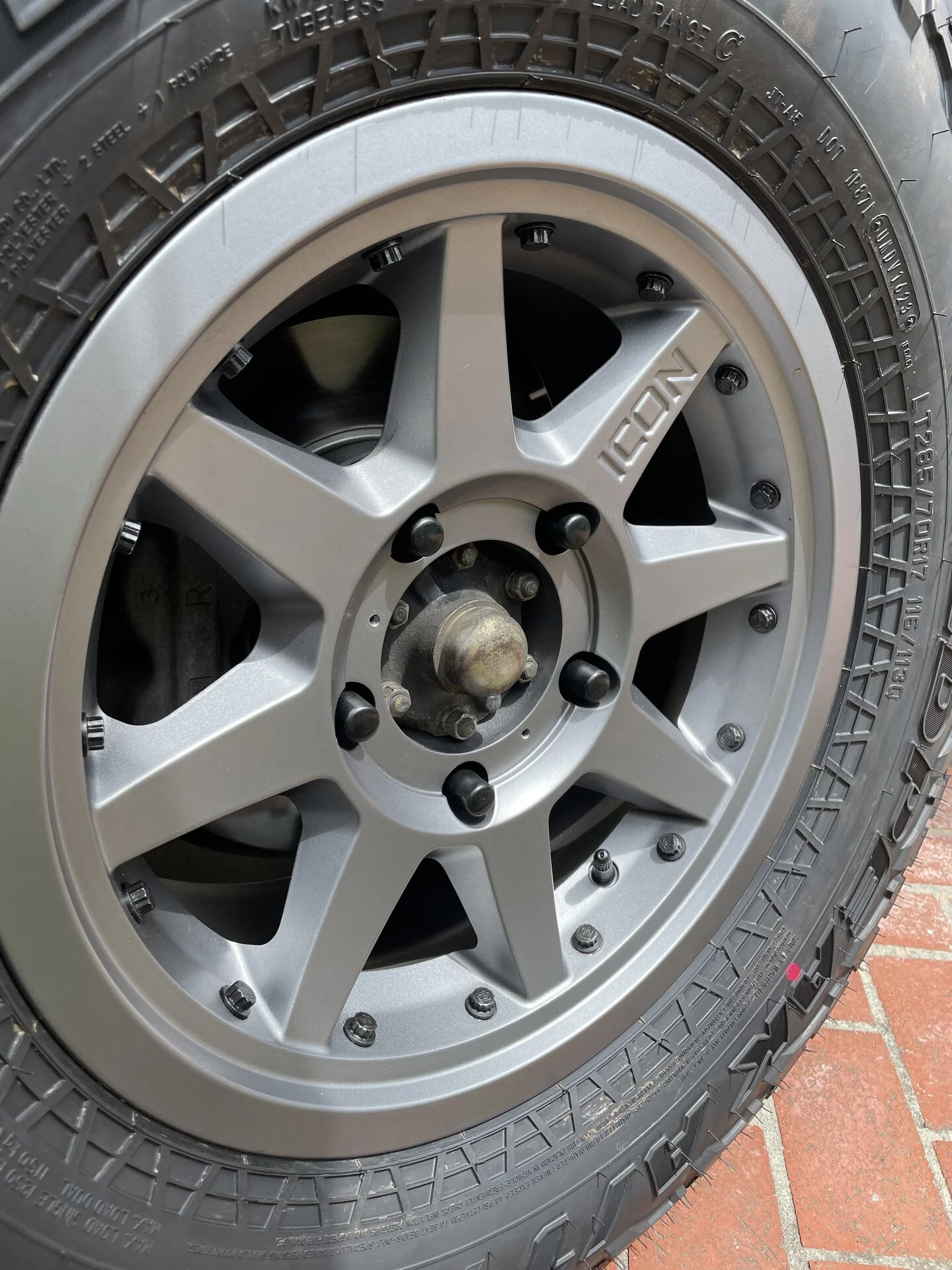

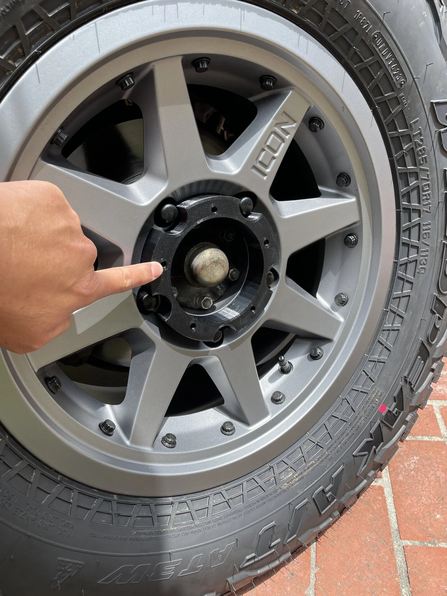

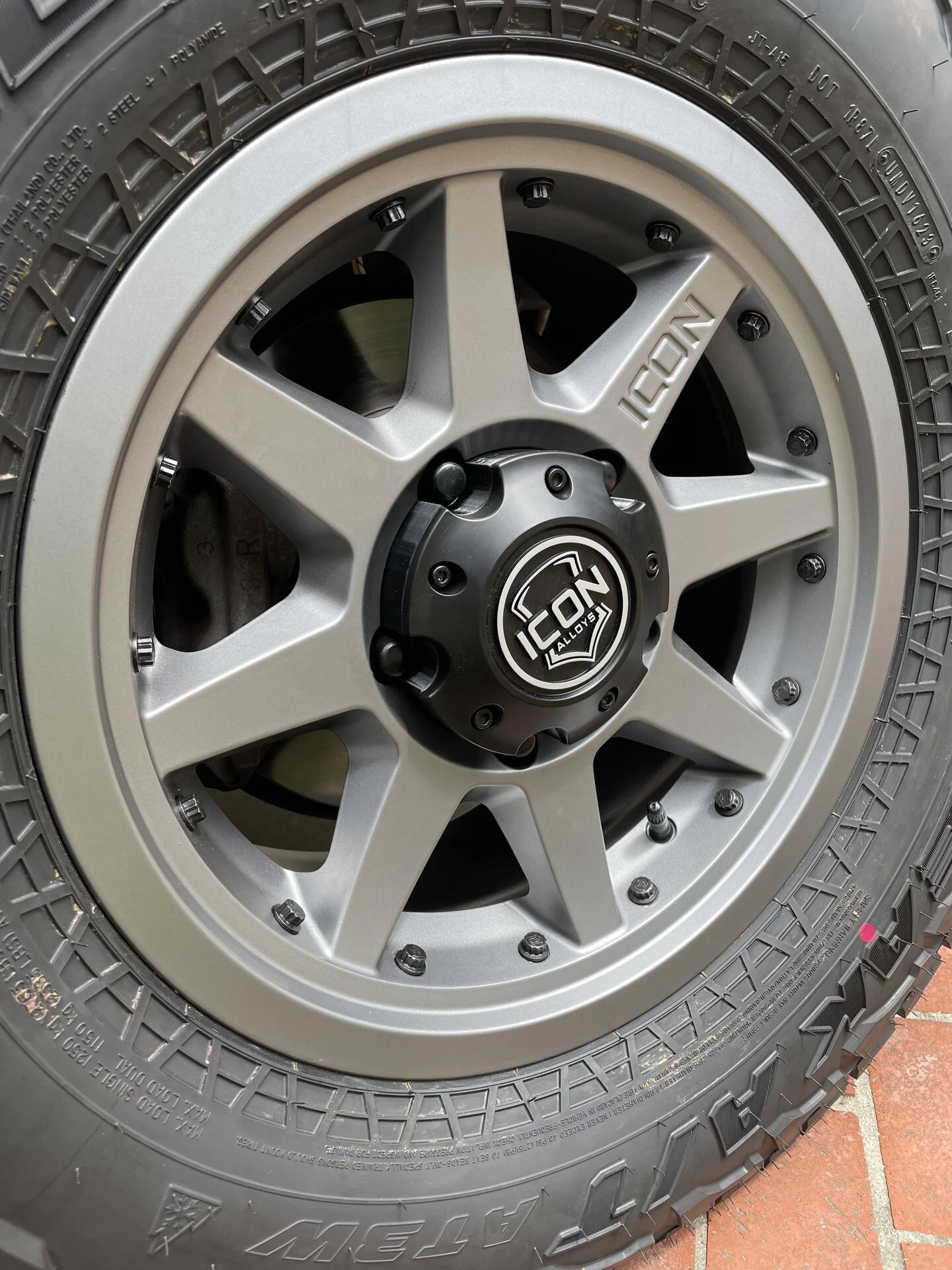

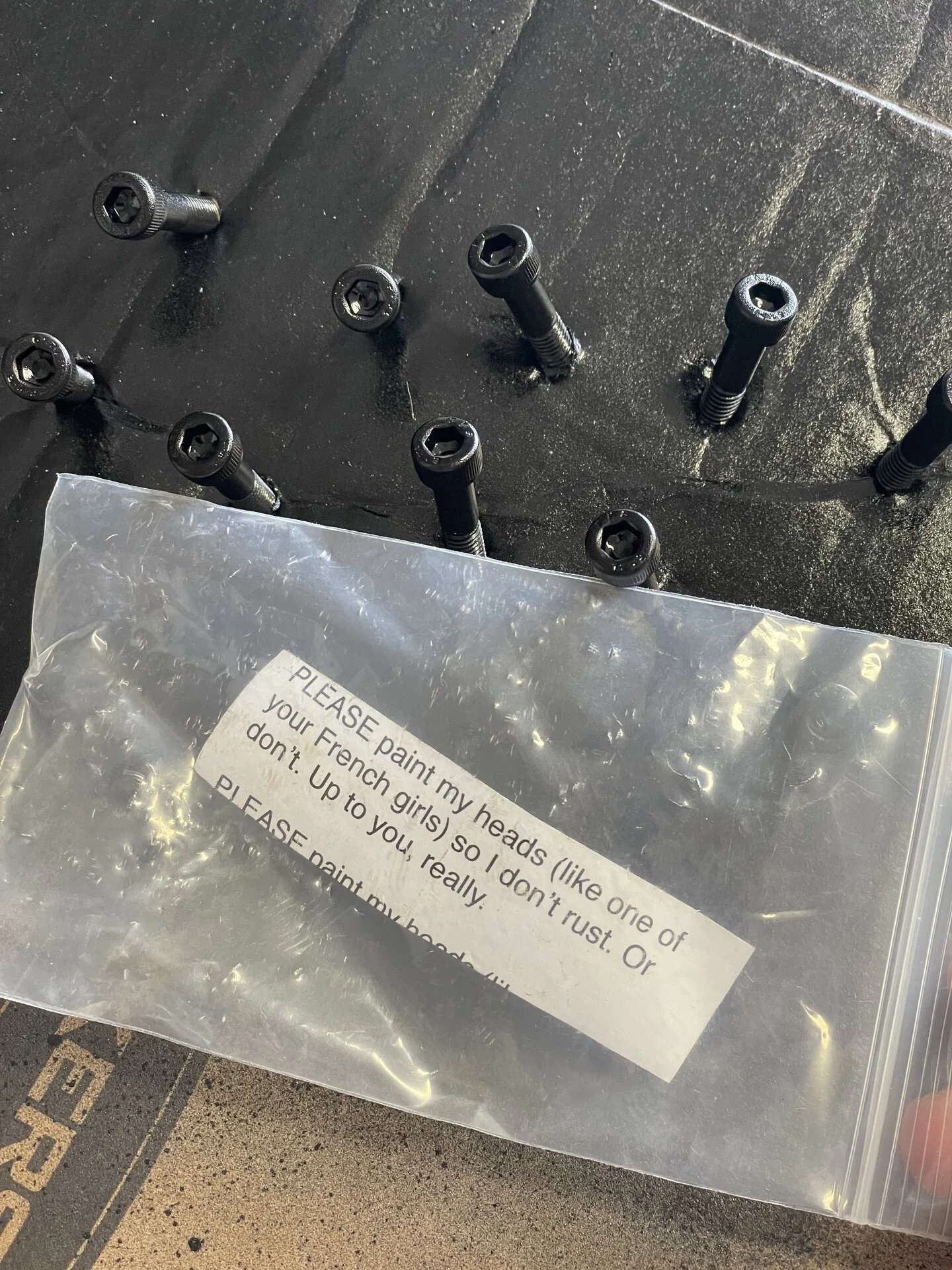

The problem: front hub caps don’t fit for the 100-series/LX470! Problem solved thanks to @Delta VS
Nice! What offset? Pictures of how much it poking out of fenders?
i have those as well, the DVS spacers work perfectly.

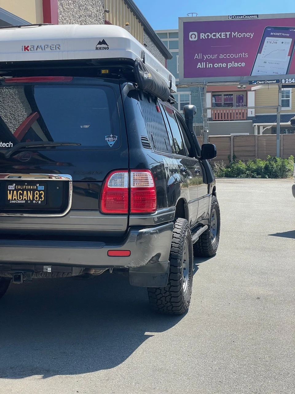

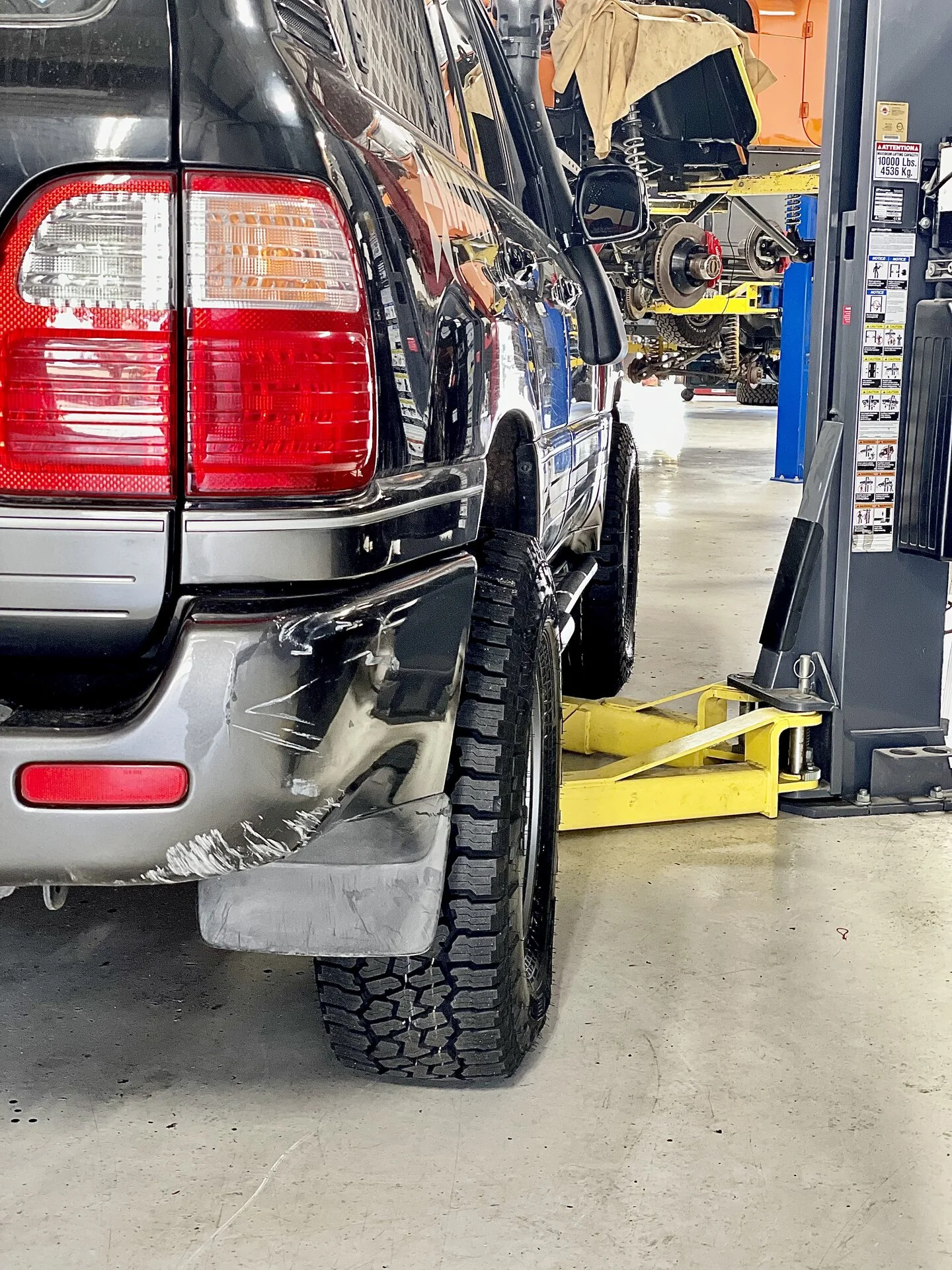

For me, this is a little too much poke with 1.25” spacers on both the front and back. We ended up taking out the front spacers at the shop bc the tires rubbed.

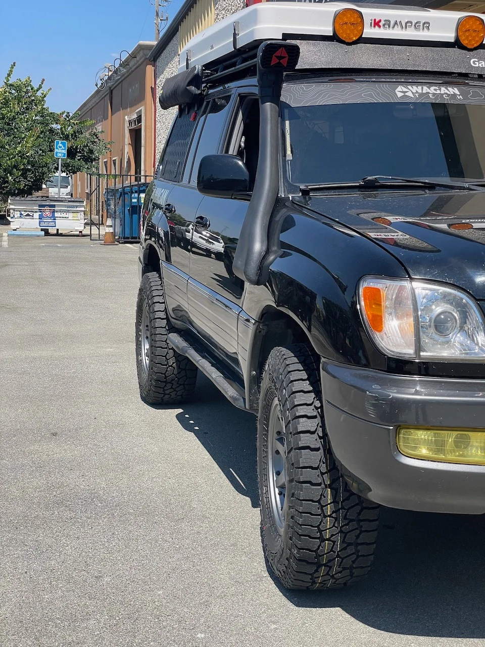

Here the front tires have no spacers, but the rear does.
Hope that helps!

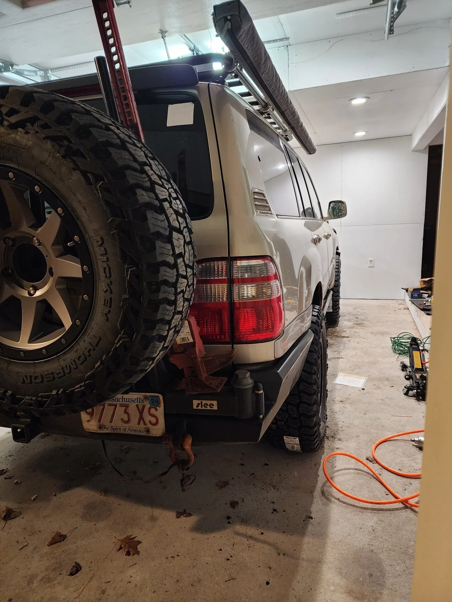

It doesn't poke out a lot, just fills the fender, definitely no need for spacers unless you're going for brodozer style...
