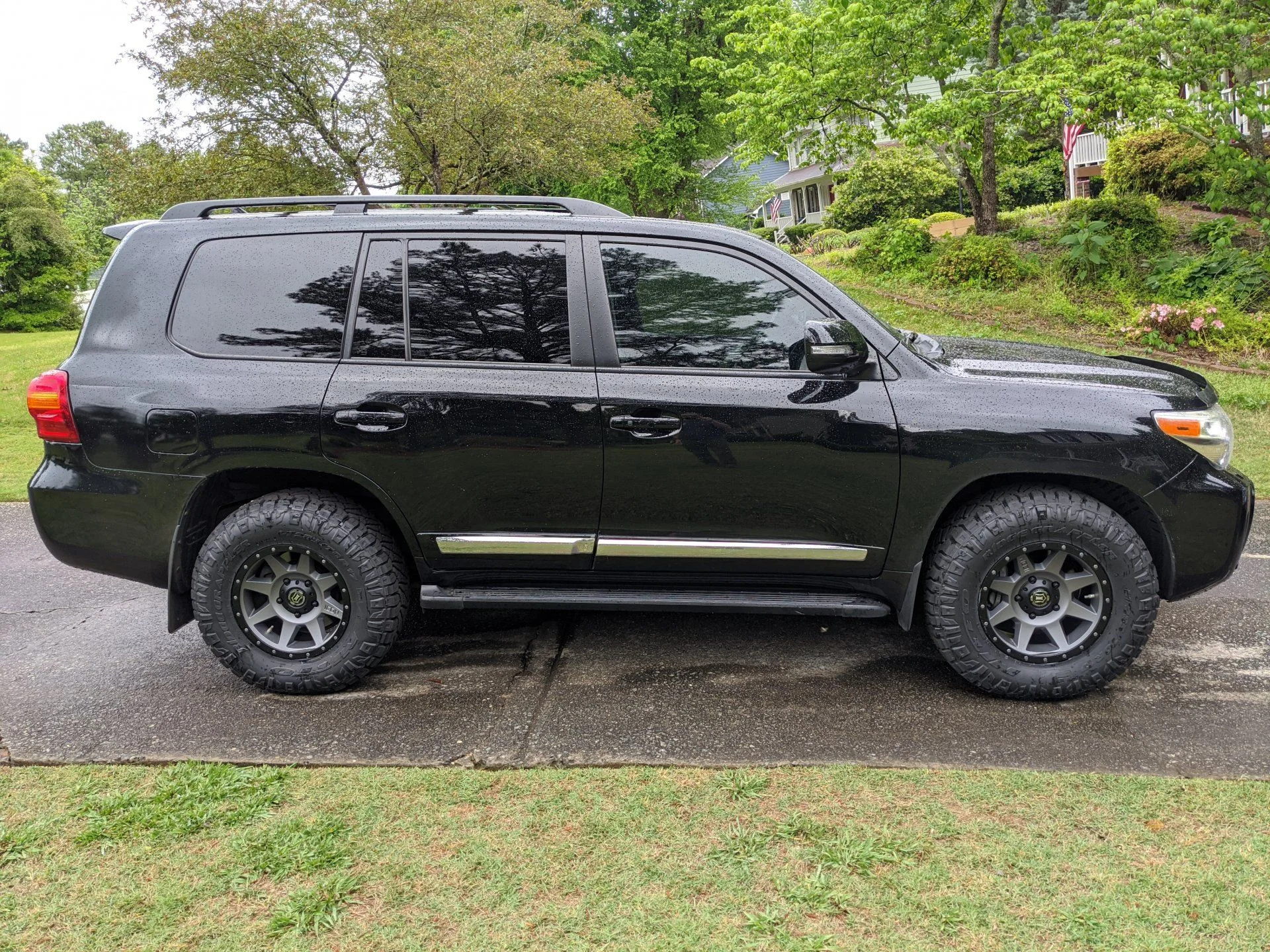

Completely changed the look. Love it, just need to decrome the sides (again). Went with the Ridge Grapplers in 285-70-17. I had them on my Jeep (sold it) and on my GX and have been happy with them.

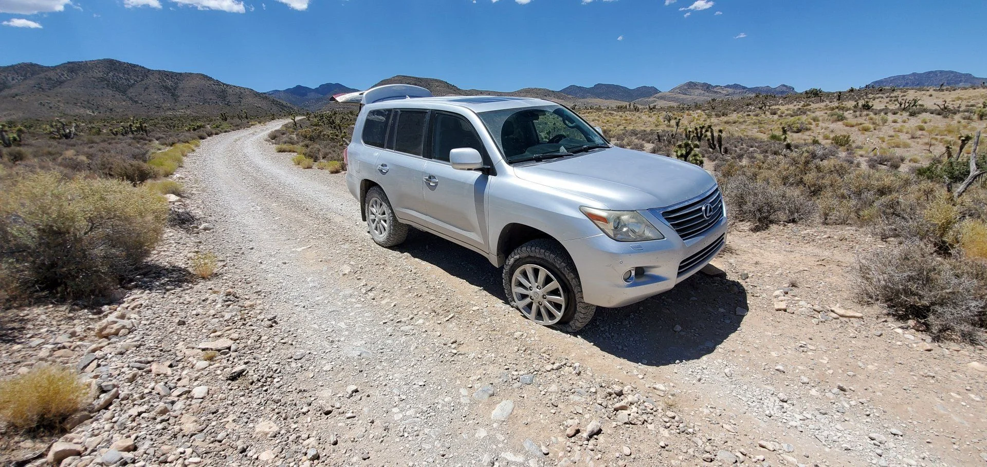

^Looks like you were playing hard. Sorry to hear.
What do you think gotcha? Pinched tire? Sharp rock?
Yeah, pinched tire. I was going around 50mph, the rock I hit wasn't that big or sharp looking.
I was lucky as I hit the same size rock on each side at the same time.
Must have been a nasty rock. Those KO2s are generally pretty tough.

The only 17" in the stock offset are the ROW steelies. Then RWs at 50mm (-10 from stock). Lots of people at 25mm so that could be an option.
They are great! 33" on an LX. Minor rub in front, fender massage fixed that.
@tincan45 Your rig looks great. I'm considering going with the same wheel/tire combination on my 2013 LX 570. You mentioned a "fender message". Can you tell me more about what that entailed? A pic of the area would be helpful.
Thanks! @TeCKis300 has a write-up on moving the fender forward using the existing clips. I'll see if I can find it. He may reply with the link. Other than that, just remove the mud flaps and enjoy.
