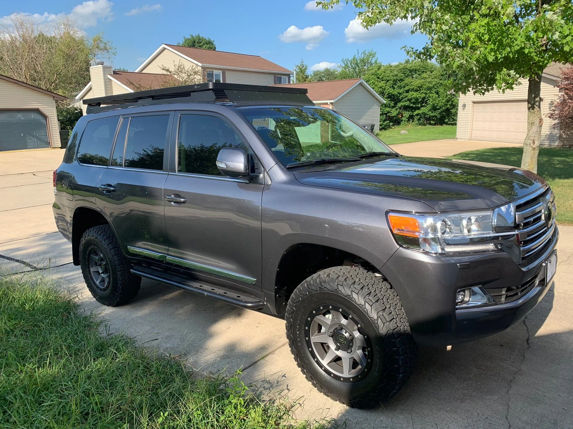

I just bought the wheels and tires on eBay. I went with 34s, but I think the general consensus is that you can get away with 33” tires without major clearance issues. A lift only helps with a few small clearance issues over the full ROM of the suspension travel.
You’ll like it better with at least a 2” front and 1” rear leveling lift, and you’ll want to search around here for the best 33” option. I personally do not like the BFG KO2’s that are so popular here. Weak sidewalls IMO. Fine for mall crawling if you like the tire otherwise. The Nitto Ridge Grapplers are great.

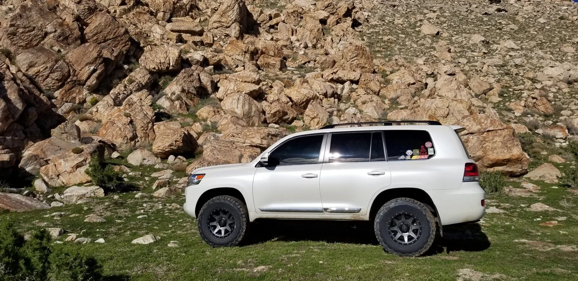

That's my set up. 34 x 11.5s. I rub very slightly on the KDSS arm and driver's side front fender liner. OME lift. To the OP. The rebounds clear just fine.

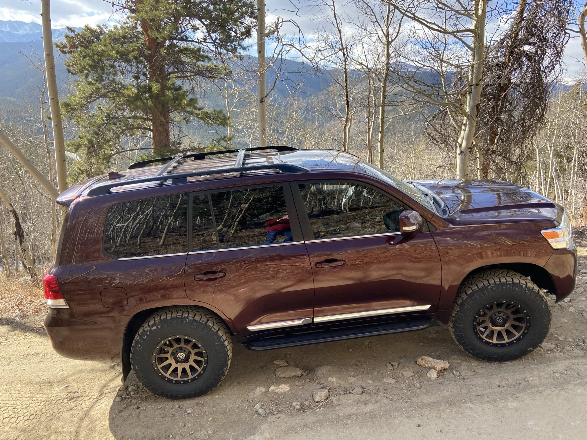

Me? Mine are titanium. There are a handful of better pics of the wheels in the 200 pic thread. Let me see what else I have on my work machine.

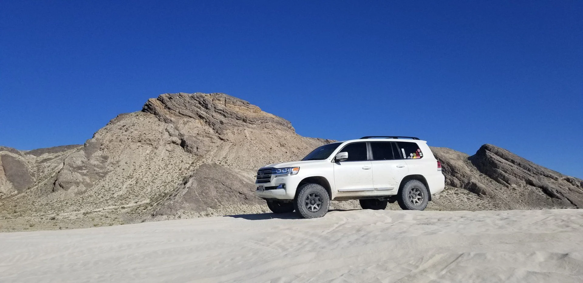

17” Icons with 34 x10.50. BFG all terrains. Minor rub on the mud flaps. I could easily trim a little but I’m putting a 2” lift on next week and I’m going to wait and see how that works before I trim anything.
