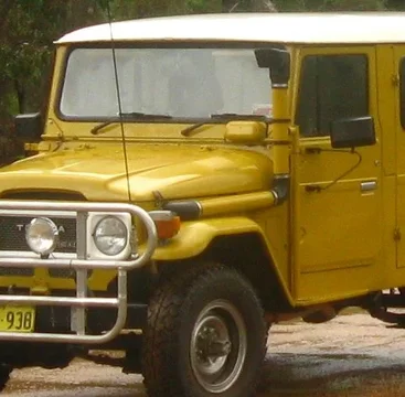

Don't know how much help this is, but here's a pic of the snorkel on my HJ47 - I didn't install it, but it works great. I believe its custom.
As you can see, it is simply steel tubing with rubber elbows joined with typical hose clamps so that it is air tight and has a safari air ram. the hole through the fender has a rubber strip around the rim, through which the tubing seals nicely against. The upright section is u-bolted onto a tube coming off the footstep. I can take some better photos tomorrow if you want (sorry this one is pretty average!)

nice trucks! not crazy about the fender mounted snorkle... like the second's design more... wish someone sold a bolt-on of some type.
