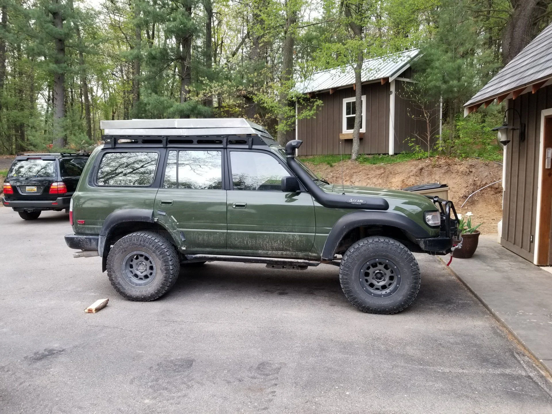

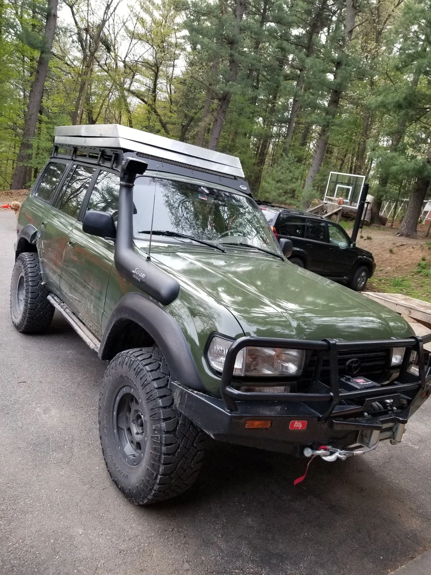

I like your idea of the top part out over the bottom. I actually had two halves made that came out pretty poorly due to miscommunication and some hurrying. I just haven't had time to work on it and fix since. These are pictures of the two halves on top of my daughter's 80 to give an idea of height stacked right on the cross bars. Kinda high but not terrible. Dropping down in would be sweet really but sort of permanent instead of a rack accessory. The bottom is 3" tall and the top 4", which is backward of what I want. The other way was intended to put an exped megamat in there (bought that too).Also each half is two pieces seamed due to what we could get our hands on in a hurry. One of the halves isn't even level, so kinda scabby. I have a brand new vw bus replacement canvas sitting in a box for this. I also bought aluminum channel and round plastic trim to sew to the canvas and attach to the halves. Also there is one pic with me in it to show how tight it is for someone 6'3". We (my lab and I) would fit, but barely.
Not really pursuing this actively but thought sharing might help.

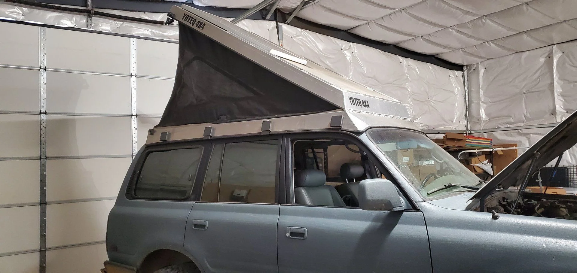

1 Prototype - Telluride
2 1st production - Az (originally BC), Northern Ca
4 2nd production - Mr CampTeq, Texas? (Originally Wa sold in 1/2 hr on MUD) , Tenn., LCP
All have cut their roof but 1;)
On the 2nd production very little interest received
Featured at Overland Expo with a cut roof and non cut roof - no orders
With STRONG interest production run may be available ~$6500 pick up in AZ.
No need to cut your roof :D
