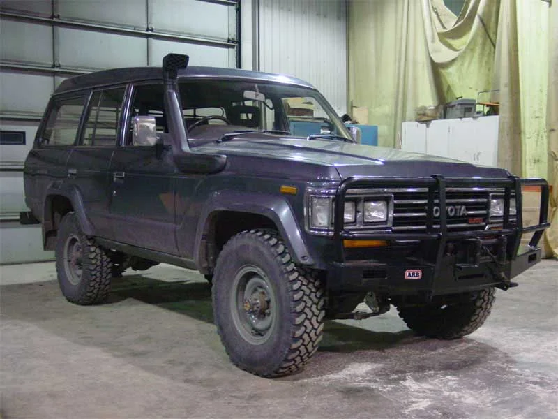

I sprung over my HJ61
Well in my quest to fit some 38s I broke down and got the 2" bodylift on this weekend...I also added an add-a-leaf all around.
You will have to lower the rad, extend the parking brake and tweak the shifter linkage. The t-case shift is short but works...same with the PTO shifter.
The lines actually looked good with the ARB up front and along the sides. Straight on from the back looks bad but I should be able to fix that with a custom plate on the rear bumper.
The ARB has been sold and a new custom bumber is in the works.
The spacers, new rims, 11.00R16 and new 4 runner brakes are all awaiting install...oh, and with all the messiig around up front I am finally going to get an intercooler on the truck....
I "think" I am happy with it. :D

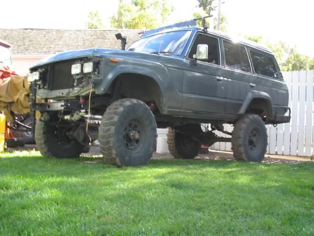

There is very little off camber wheeling here and the big lift and that tire/wheel combo sux. That is why I wanted to try the body lift and lose my Belton suspension lift to try and get my COG lower. But it is good for the mud and skeg that we have.
To help solve that issue I have bought spacers to use IFS hubs off of a 4 runner and I have a better offset rim and wider tires...I may go with a bolt on spacer as well, but I am going to wait and see how it wheels first...

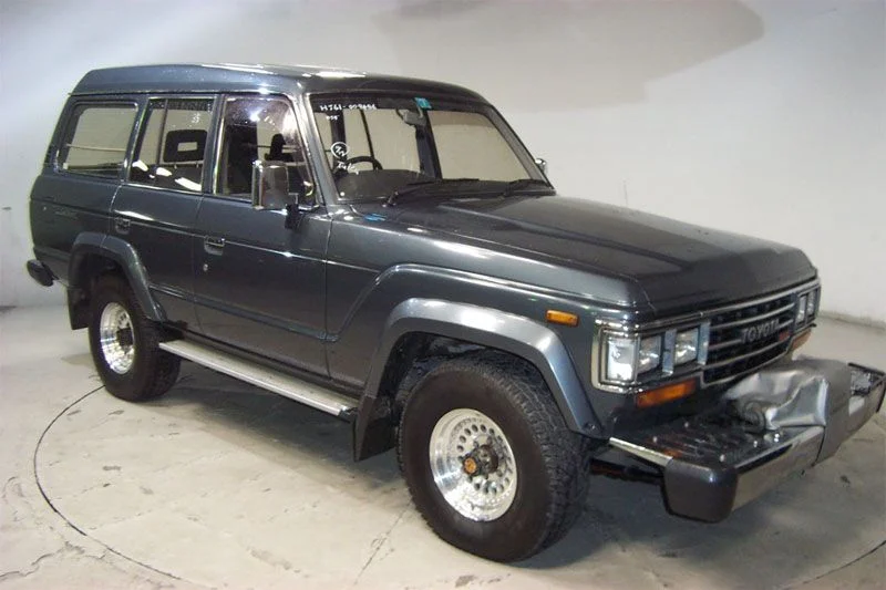

Here are some of the "before" pics
this is stock and how I recieved him

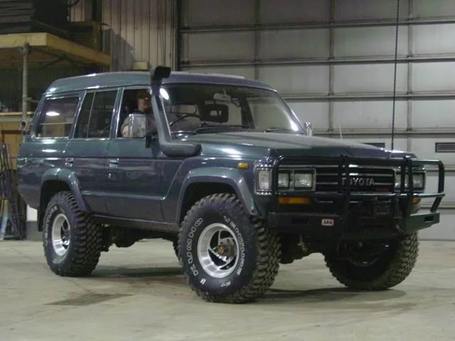

Belton with 35x12.5R15 on 3" BS rims
Belton lift with 255/85R16 on split rims

I have gone up a total of 9" in the back and 8" in the front (bumper hieghts) from stock. The bottom of my frame rails are at 25" with the 9.00R16. So I am expecting another 1" with the switch to 11.00R16s Add to this another 2" for the body lift to vlear the tires.
I hope it works out..If not I can always change it!!
