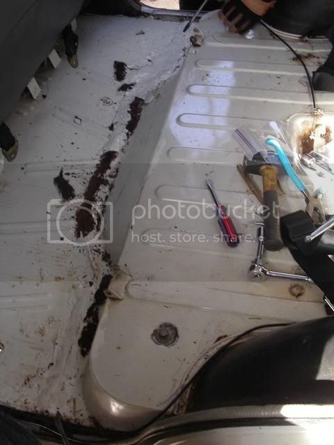

Floorboard Repair
So this is what I am up against on the floorboards. The PO thought that it would be a good idea to epoxy the rotting weld along the back seat platform. Not so much. Water got trapped under that stuff and it just kept on rusting...all the way through. And, it seeped out the sides to rot the door frame and contribute to the rocker panel issues along the back fender.
Anyway, like I said, this is about stopping the bleeding for now, not a long term fix. I am going to grind down and por-15 the entire area, use their fiberglass mesh and putty to fill in and build up what I need to, then call it a day (or a week...which is how long I think this will take me).
After some grinding and wire wheeling:
One question. The rockers are in good shape except just at the end by the back fender. How do I paint inside the rocker to get the rust inhibitor up in there? I thought about a pom-pom on a stick and just shoving it through? Anyone do this before without a spray gun?

I still like the idea of cutting a channel up the entire length of the rocker, treating it, then welding in steel to bottle it back up, with drainage slits.
