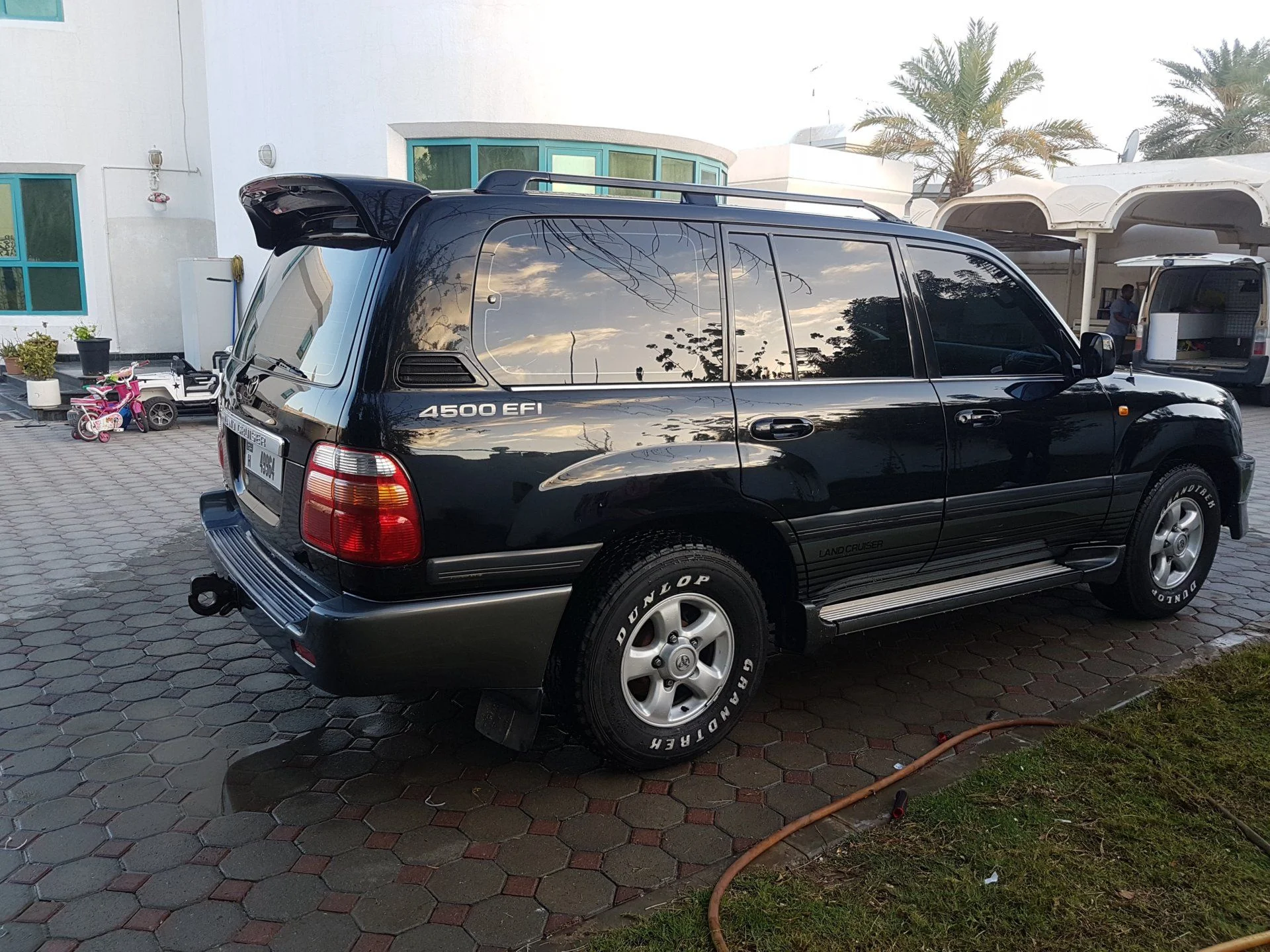

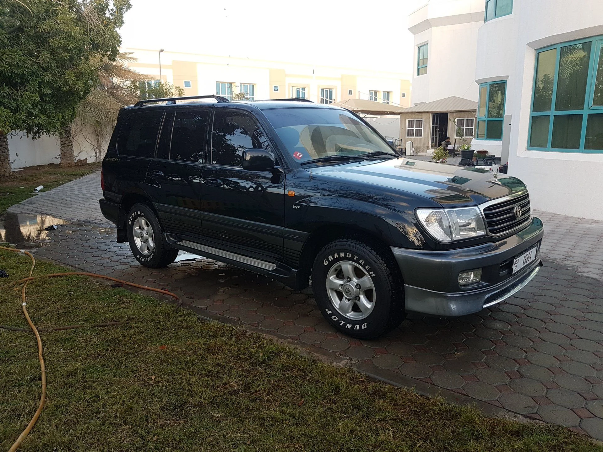

Completely stock. Even has the stock tires. Stock everythingggggggggggggg
