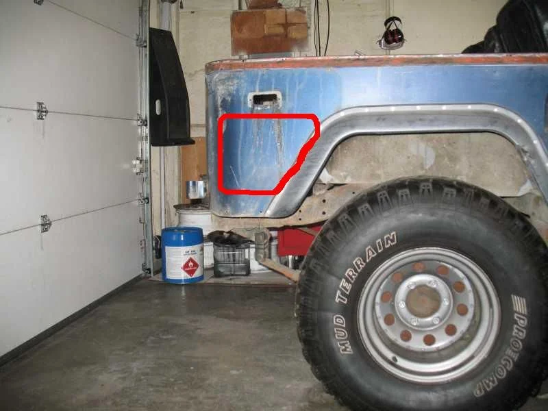

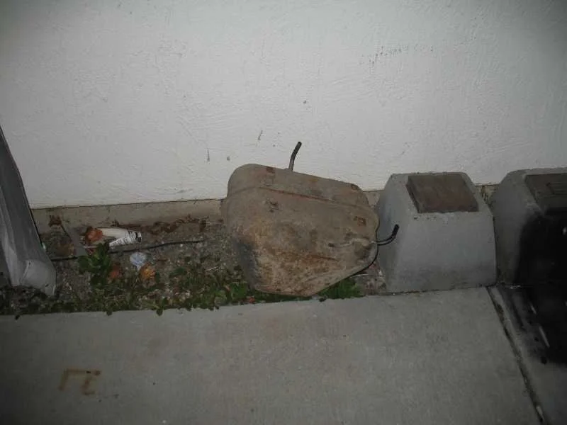

I was doing some disassembly today on my cruiser and found this. What is it?
My first guess is auxiliary fuel tank, but a 2-3 gallon auxiliary? Very odd.
Second picture shows where I found it.

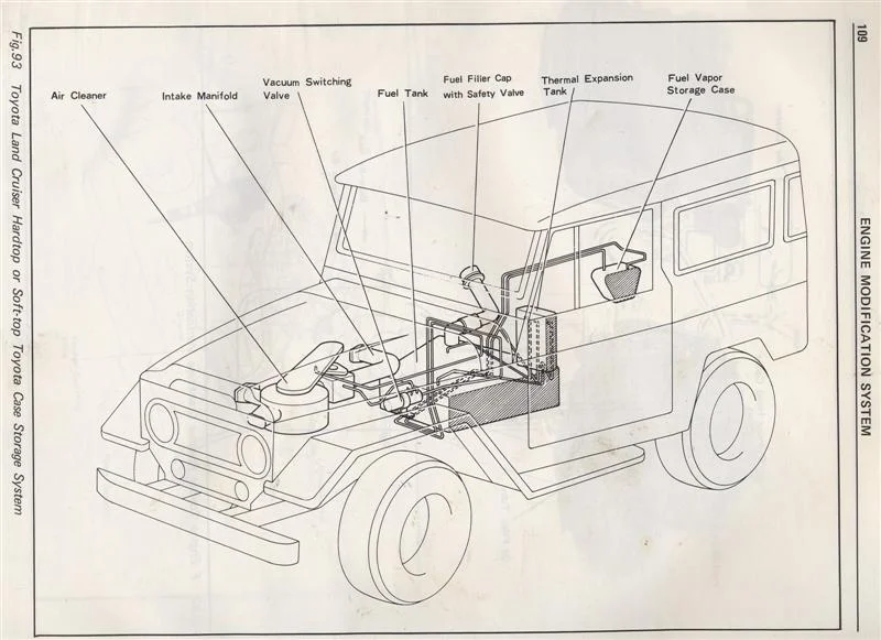

Appears to be a fuel vapor storage tank emissions thingie.
Had the same thing on my '71; however, it has now been removed along with all the connecting lines.
