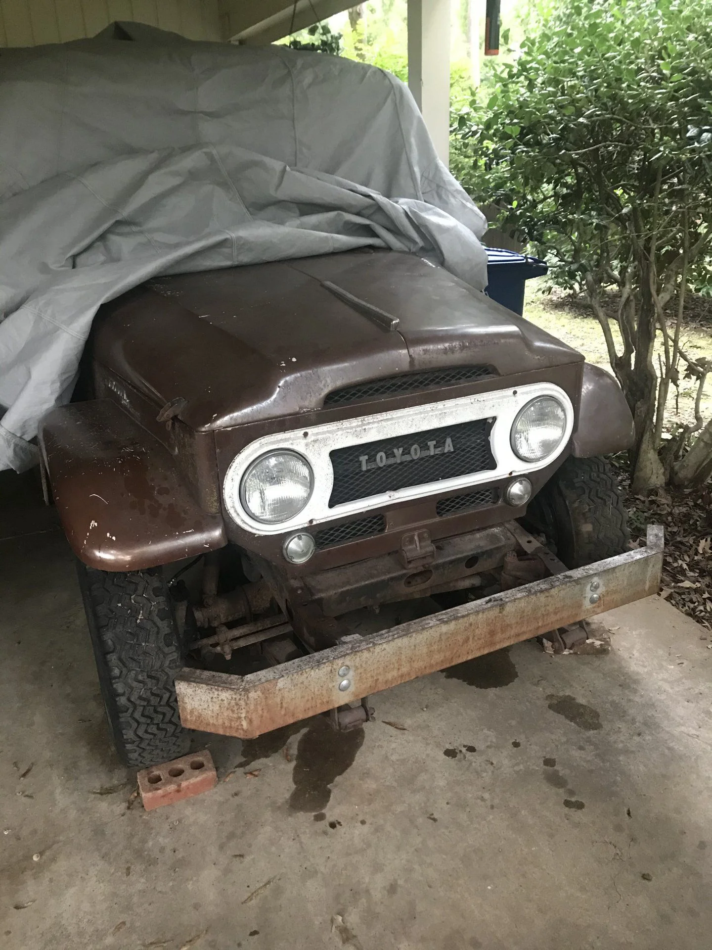

I bought a 1966 (6/65) FJ40L 'parts car' to restore

So, I surprised my wife last month by picking up this FJ40 to fix up.

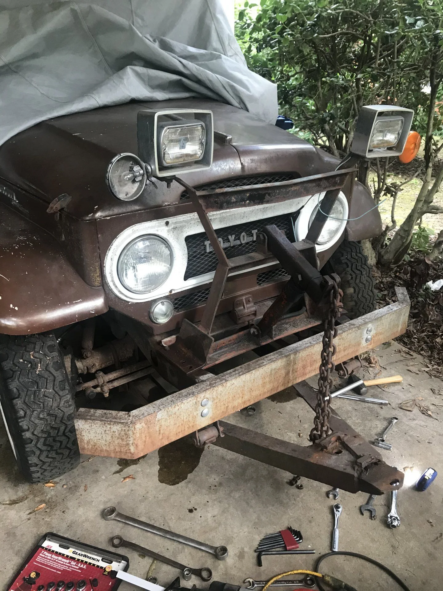

Snow plow gear came off.
Whatcha gonna do with the snow gear?

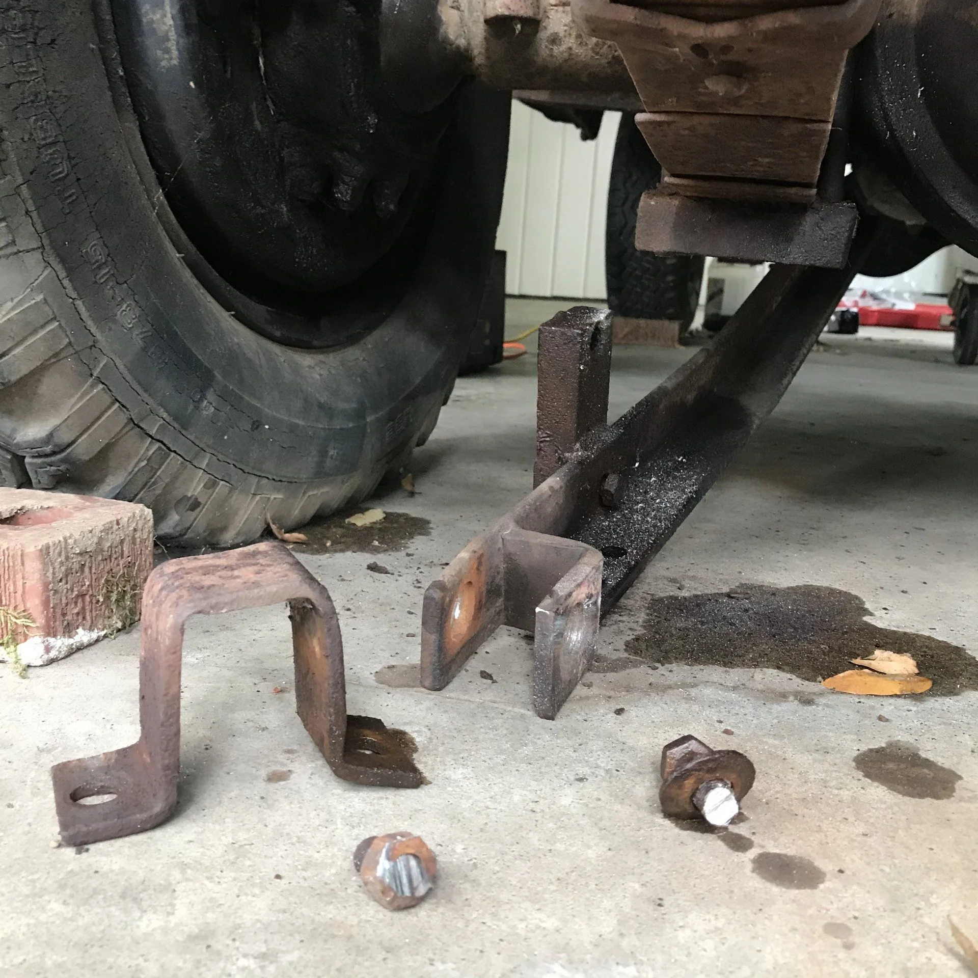

Daner, yes it was. I removed one bolt old school with PB blaster and muscle. Then I got out the Sawzall, which was much faster!

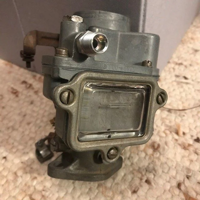

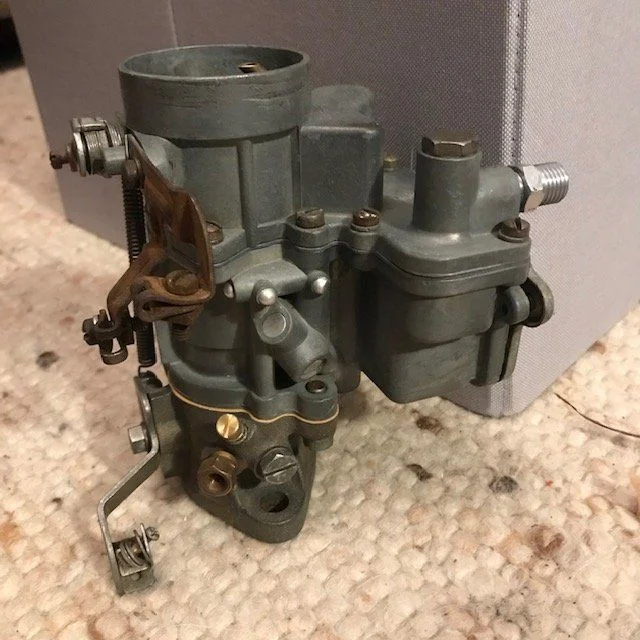

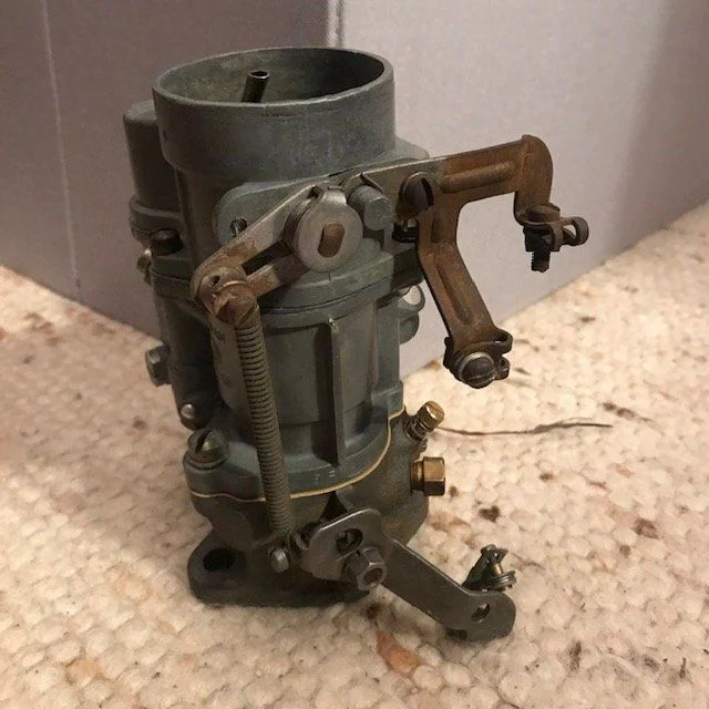

Well after a 3 year pause on this project, I am back at it! My goal it just to get it running. The carb seemed to be the source of my many frustrations, and at the urging of several of you I had @65swb45 rebuild it. I got it back recently and was able to install it. It fired up pretty quick after sitting for so long. Thanks Mark you have the magic touc
out of the box from Mark. Cleaned up nice, I know he put some extra work in on it.

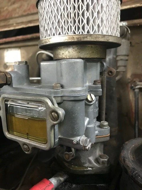

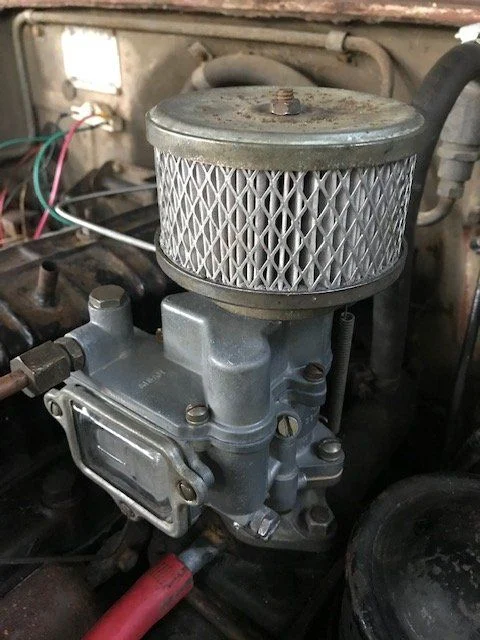

I'm a little embarrassed on the filter, anybody have a lead on an intake?
Notice the fuel above the insulating gasket, I think I started to flood things, and must have been leaking out.

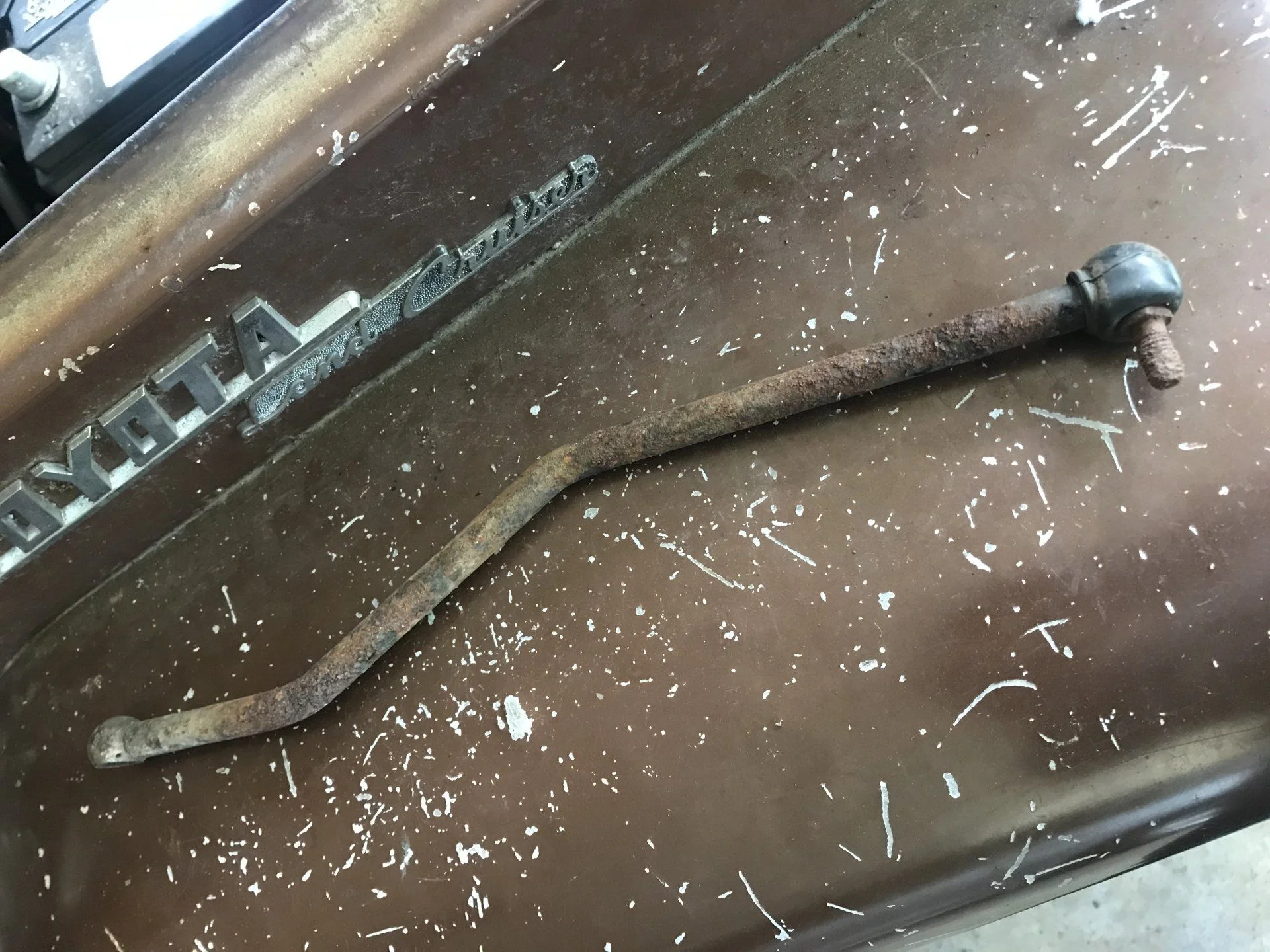

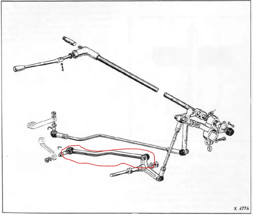

Thanks Citrus. Great help. I’ll get this back on. This must be for the upper gears, as I don’t recall when I drove it 3 years ago for the first time into storage, if I got into 2nd or 3rd. I was too busy hand throttling the whole drive. Many California rolls, as I didn’t want to stall at the stops. It a fun drive as brakes where barely working.
My bad, I thought the link was from the pass. side. This is from drivers side. Mine is there, so this is a spare.
