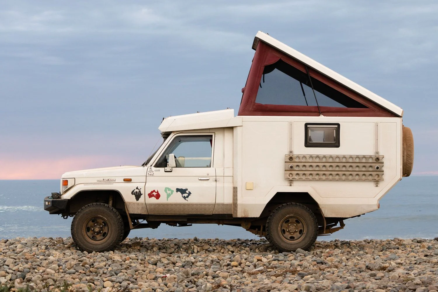

I recently purchased a 2002 HZJ78 Troopy camper (pictured below) from a Swiss couple who were original owners, had the camper built and took the thing around the world (Australia, Africa, and bottom of South America to the Arctic Ocean) before selling it to me. They were meticulous in their upkeep and despite its 300k kilometers, the thing is in great shape.
