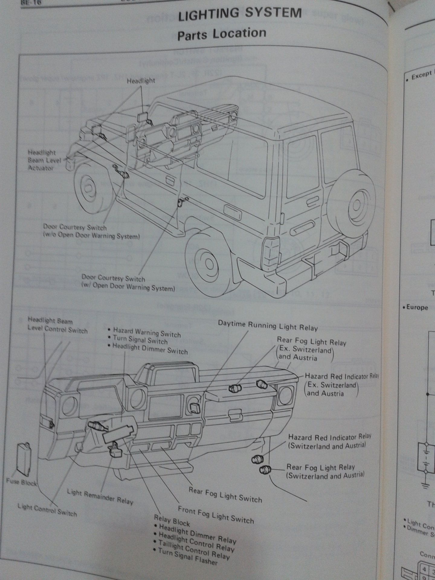

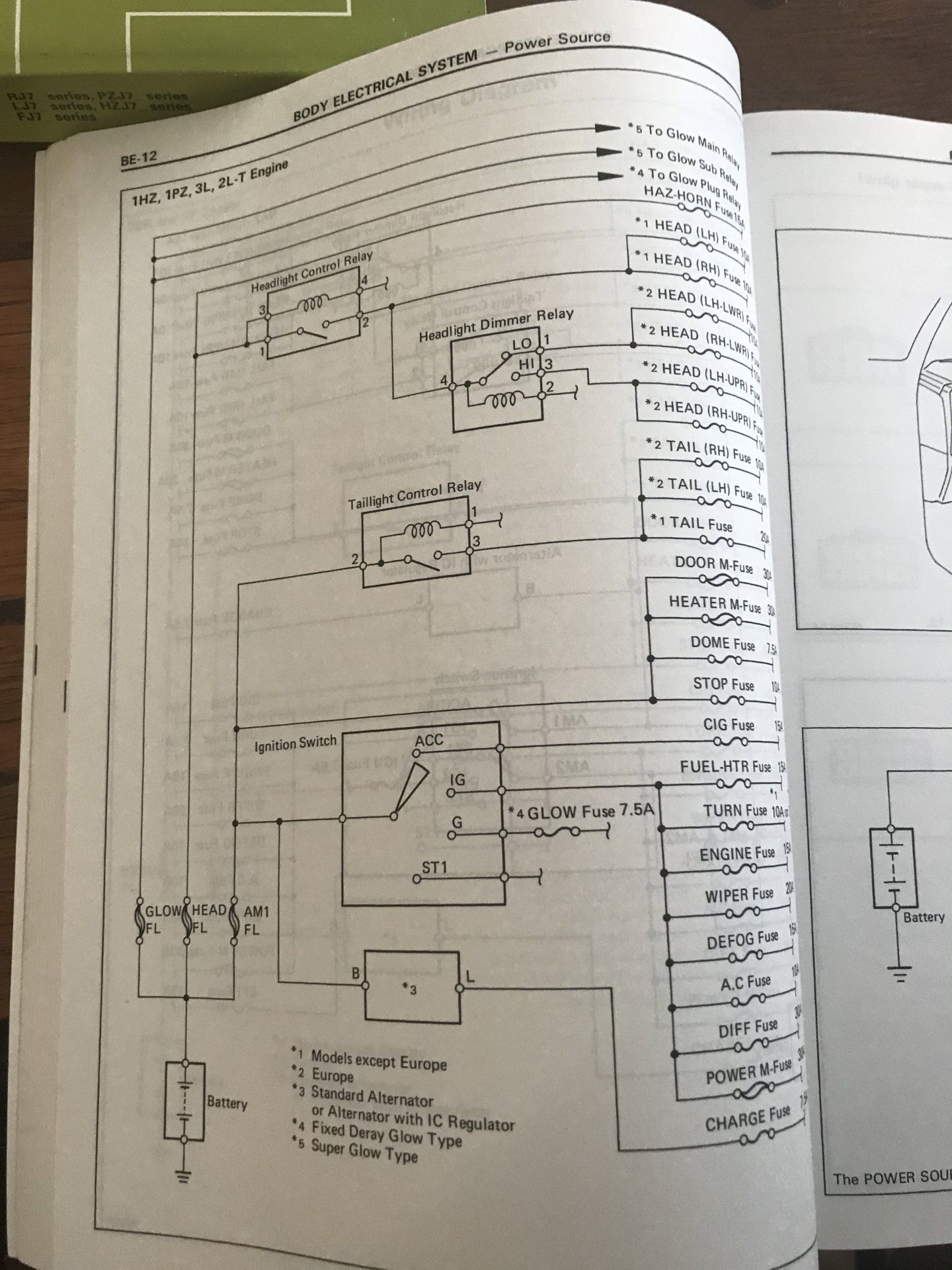

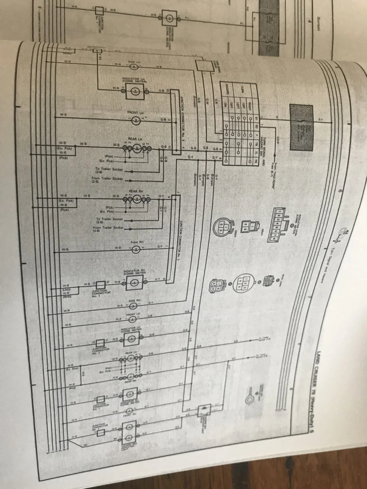

I have a HZJ75 1998. Ute has never been roadworthy i just bought it off the farm i work and i changed all all the lights and out new ones in because the blinkers werent working.
Now everything is changed to new lights and bulbs, its still not working.
Im trying to fins the relay for it but having a hard time finding it.
Any help please thanks in advance.

Hello,
Relays location.
A multimeter (for a continuity check) is your friend. Over time, contacts corrode and stop conducing electricity.
