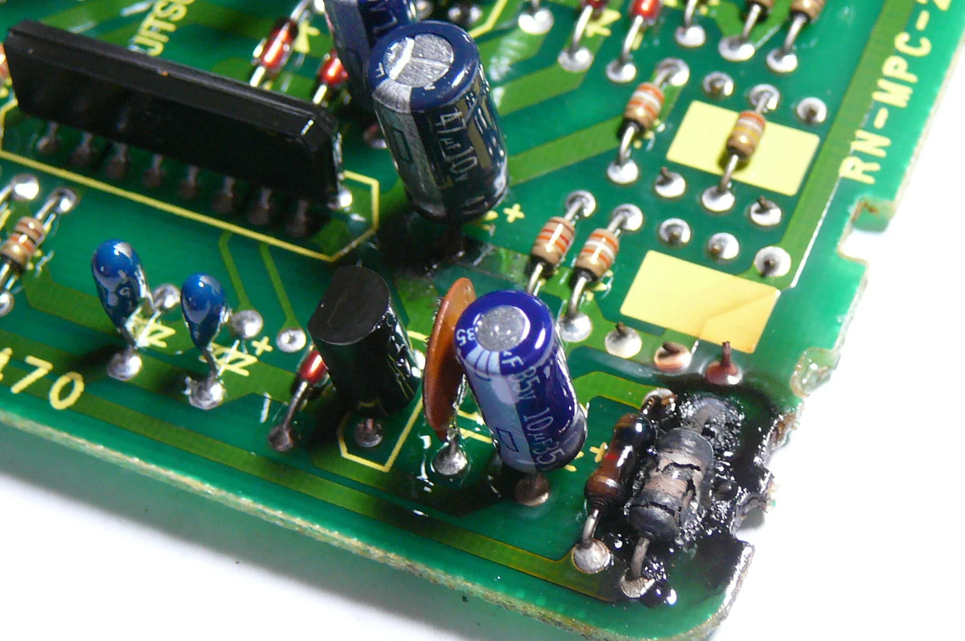

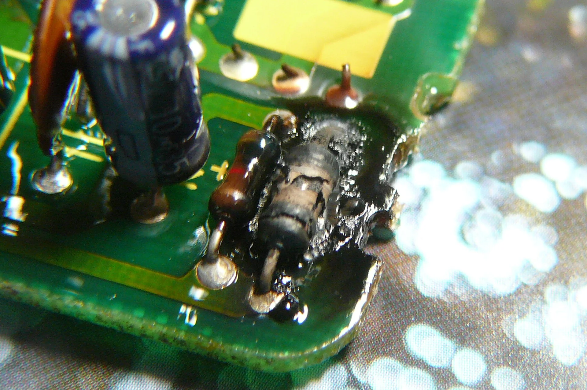

Regarding the pre heating timer circuit (unit: part number is 28521-17100) for the glow plug of Landcruiser (1991 HZJ73v),
The preheating lamp of the glow plug remained on and did not go out, so when I removed the preheating timer unit and looked at the internal circuit, I found that the two resistors circled in red in the photo were burnt out. Therefore, I would like to repair it myself, but the resistance value of this resistor cannot be read visually because the horizontal line on the surface is burnt and invisible. So, can someone tell me the values of these two resistors? I would appreciate it if you could tell me the resistance values of the two pieces in order from the side closest to the corner of circuit board.
Or, if you don't know the specific resistance value but can post an enlarged photo of this part, I would appreciate it if you could post it and reply.
If I can figure it out, I'm going to source the resistors and solder them myself.

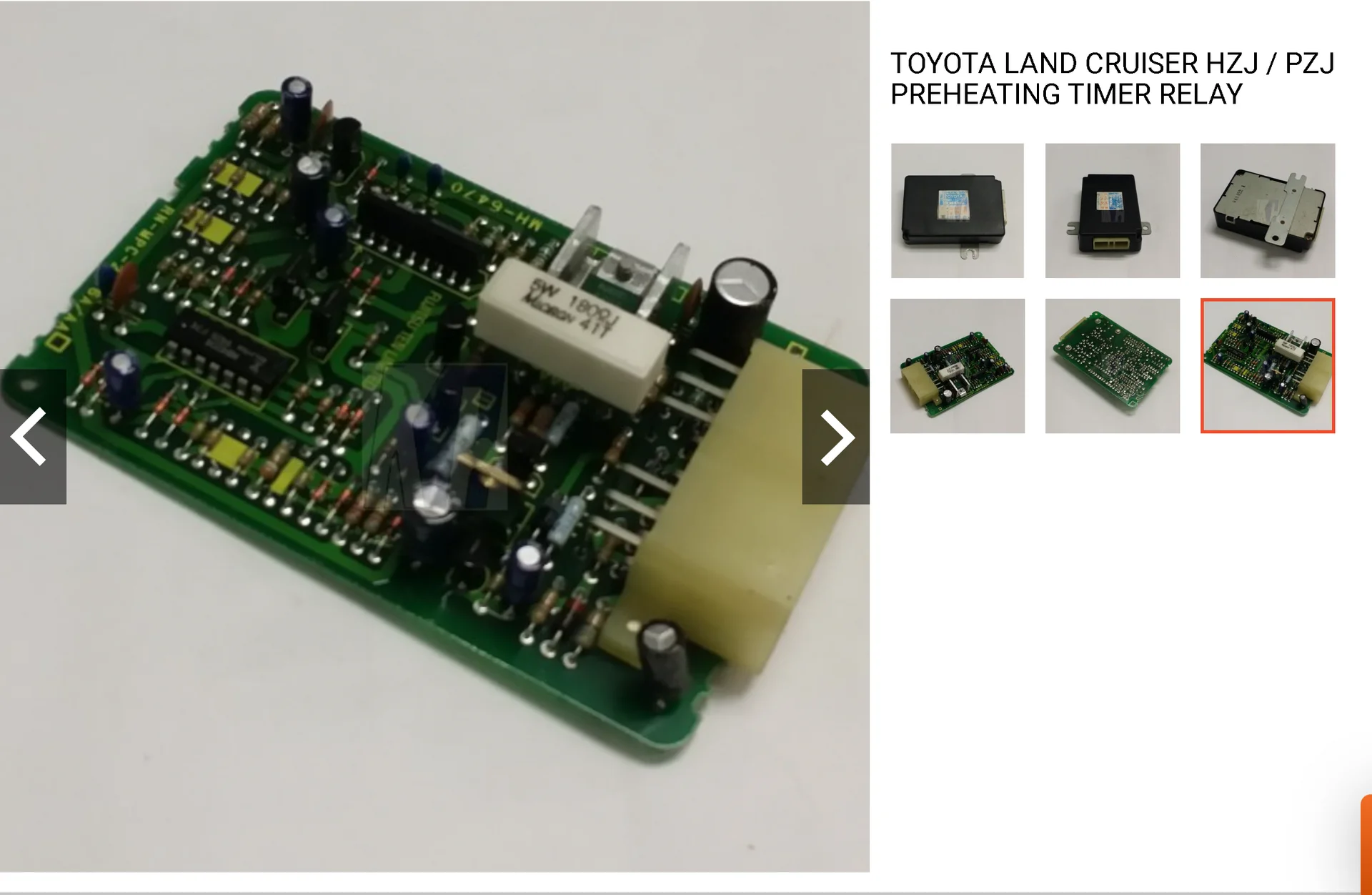

looks to be an easy fix just need to find out what values they are... hopefully someone has a picture they can reference to you
If you remove them from the board, one of them might still be showing the right value - only one looks really fried.
This might be the result though rather than the cause. Have you checked if your plugs are fried?
Seems quite common that a plug fails short-circuit and then caused a timer to overload.

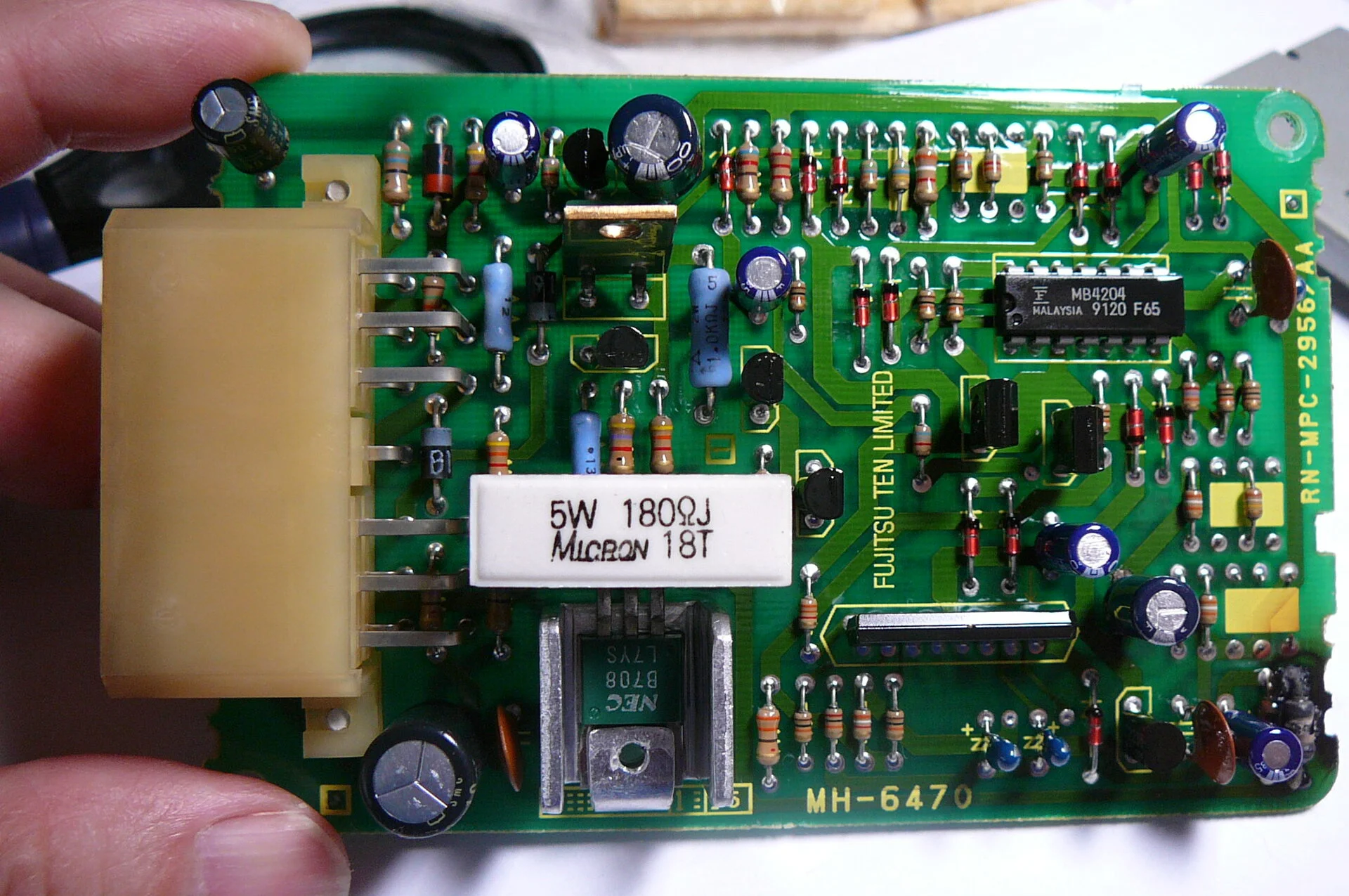

On my 80 series (with 1hz diesel) there is no glowplug light (if there's meant to be one - it's never lit up) - I can hear the relay shut off if don't try to crank before the timer finishes it's thing. Toyodiy says the one in my 80 being 3/92 build is 28521-17130 but I haven't really checked. I'd be more suspicious of a dry (high resistance) solder joint moreso than any sort of short circuit. If you want to repair the existing unit that electrolytic capacitor probably should be replaced as well.

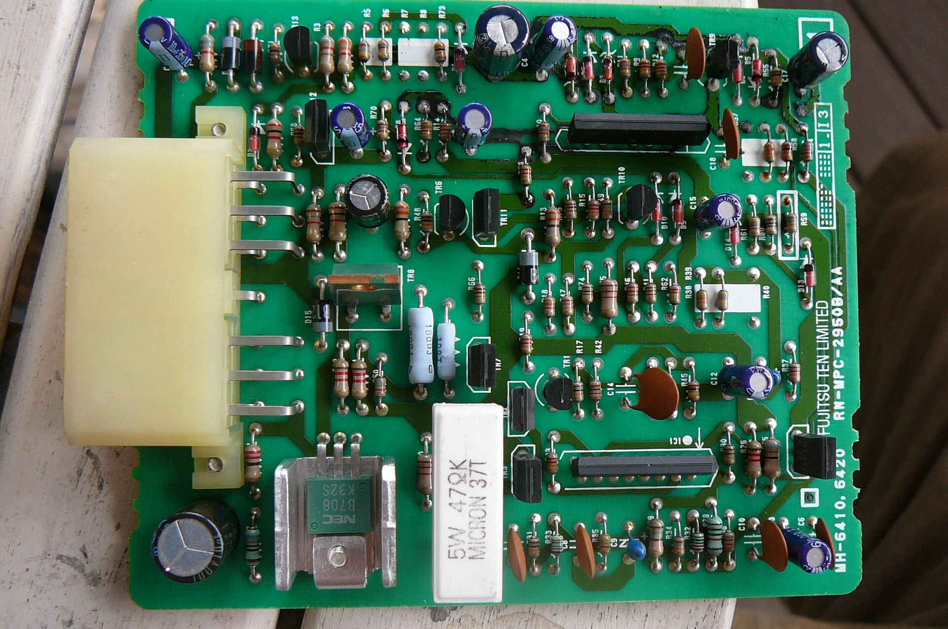

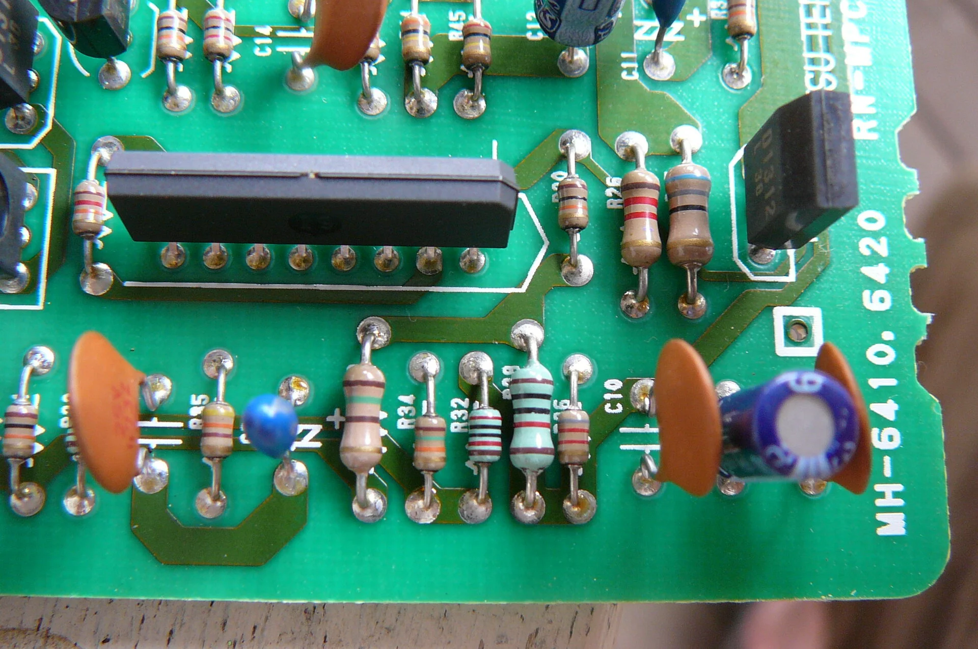

Today I get 28521-17120 (MH-6410) for HZJ81V(year 1993), and I saw the electric circuit.
However, the one I got today had a different circuit from the previous one, so it was not helpful.
Please see the circuit of 28521-17120. I attached picture.
They really don't look that different, but the big resistor has a very different value so for sure they're not the same.

you can actually scrape and measure with test leads to find the value
