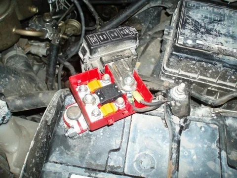

Just a couple of pics of the battery terminals I am using with the dual battery install.

Looking good Mick.
One question though, what happened to your primary fuel filter/element ? I only see the one in that pic above ? :confused:

That's all we get here on the 105. The 75/78/79's get two filters but the 100's don't.
I had a CAV Lucas 296 filter on the 80 but I don't think it flowed enough. At high load/high speed it hesitates a bit sometimes. I might go twin 296 filters on this one.
