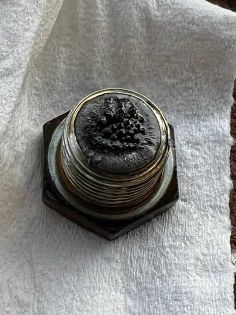

  • Oil changed in all diffs and T-case, no shaving or excessive sludge. Oil mostly clear. Also just daily driving this right now has not seen the dirt or been off-road yet.

Same noise when rear drive shaft was out. Changed the T-Case oil no metal shavings but a lot of metallic color sludge. The only thing that makes the noise go away is when I put the t-case in neutral while de accelerating.

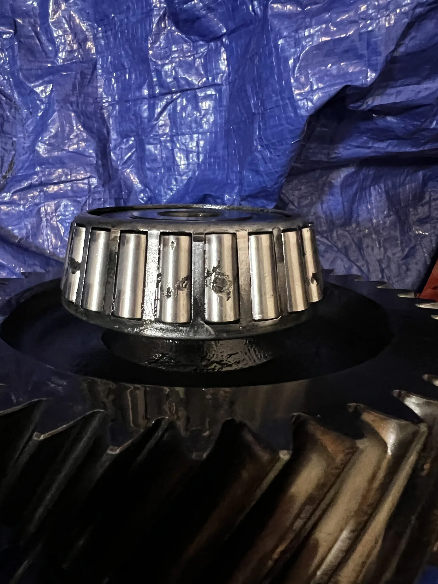

While I wait for the new one I decided to take my old T-Case apart. There was alot of damage/pitting in one of the bearing. The case was full of glitter especially around the corners where oil was not circulating. Not sure what would cause this. Hopefully the new T-Case solves the humming noise I was getting when de accelerating.
My question: Is the transmission case bearing in the picture replaceable? Is that something I should do while things are apart or leave it alone.

Man, I'm sorry this is happening to you. I have been down this path with my 80 also. I too have an extra T case on my shelf in the garage along with rear axles and such. I still have a vibration around 60 mph but have learned to live with it. It can be maddening to keep looking and not find the single one part that is causing the problem. First, go with your successes. You found metal shavings in the T case oil which led to finding a ruined bearing. One problem fixed. Now, your problem has changed. If it is in a differential, then you will see the same sign as the T case. Look at the magnetic plug for metal. Then, look at the diff oil in the sun light and see if it glitters. It will also show shiny metal by putting a few drops on a paper towel and looking at it in the sun. If you find nothing sparklely, then the bearings inside are doing OK. Next I would remove each drive shaft and make sure the U-joints are moving freely in all directions. And I mean Freely. No direction should be tighter than the other. If all 4 joints check out, and I see that you have tried driving around with each drive shaft removed, then did you put too much grease in the slip joint? I'm going to guess "No", but it can cause a noise if the slip joint is completely full of grease.
