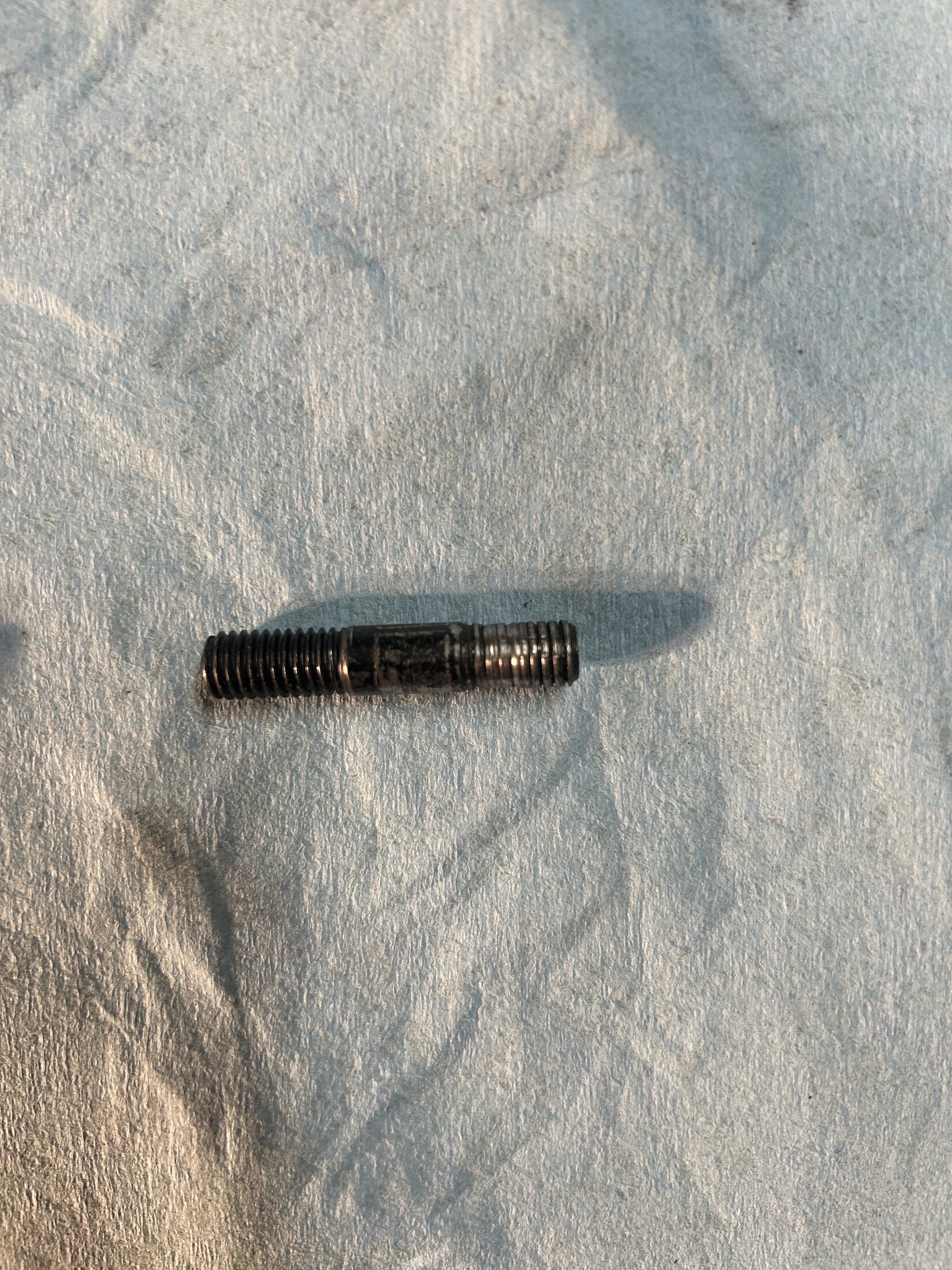

Studs wrong direction, flip them and try again.

Are you saying the rears are supposed to go short-threaded end into the hub? I thought OE design was long threaded section into the hub?

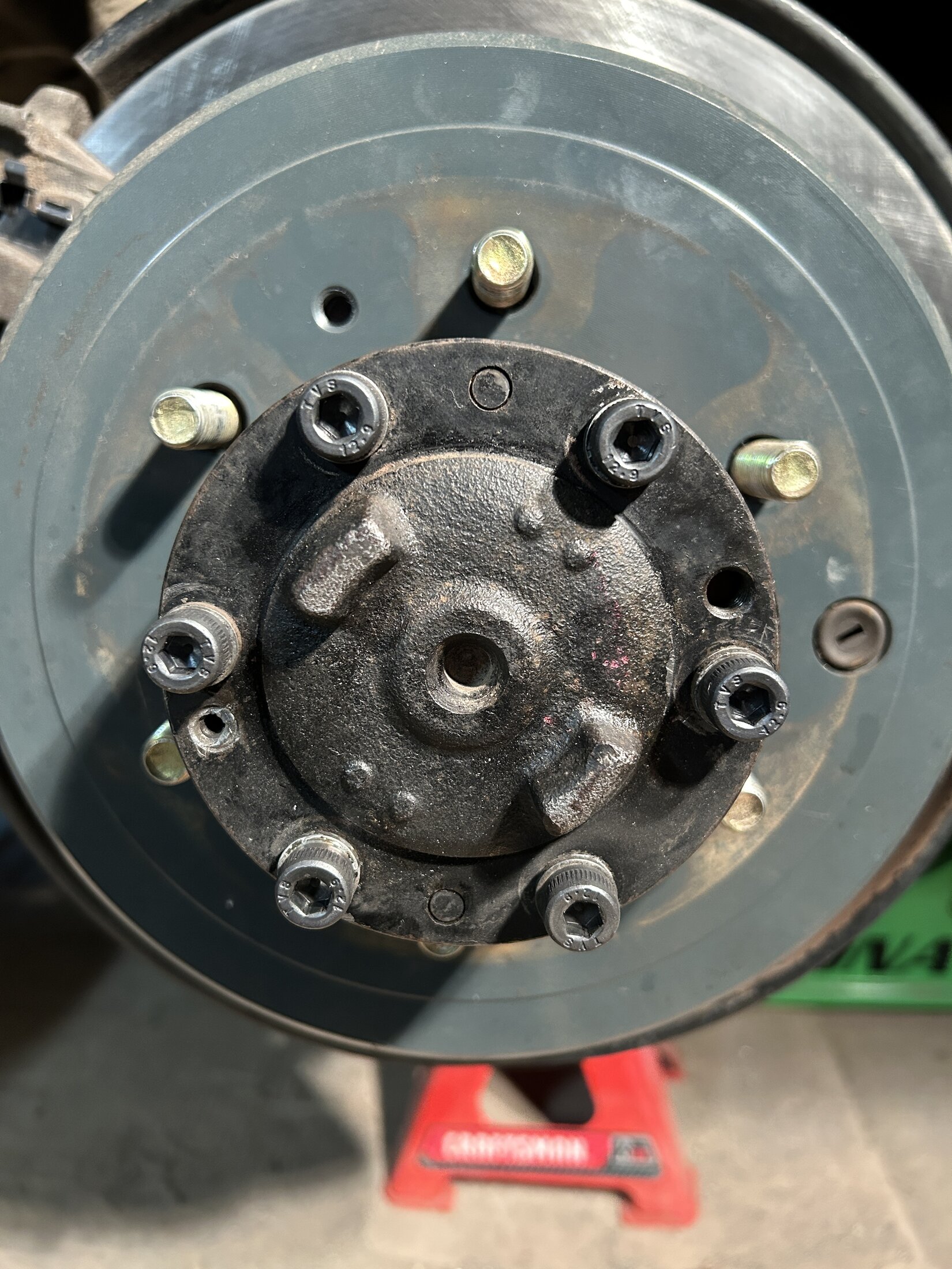

Either way, I went with some cap screws and retained the cone washers so I could get this thing out of the garage.
I realize that this probably isn't ideal; the cone washers spin a little bit in the flange when installing and might cause some minor damage to the taper. On the other hand, the forces seem roughly the same as the OEM studs, and these don't strip out. Was able to back/pry the nut off one of the stripped studs, looked like this:
May switch back in the future. Idk. At least it moves for now...
