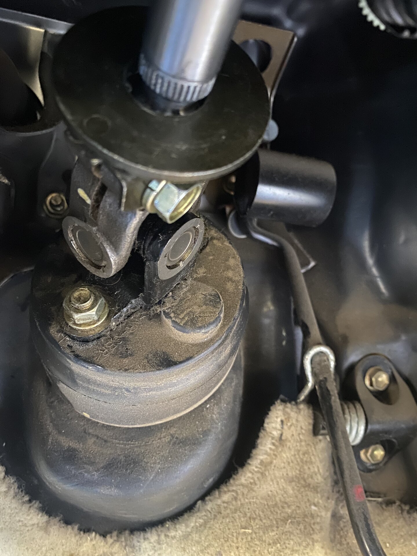

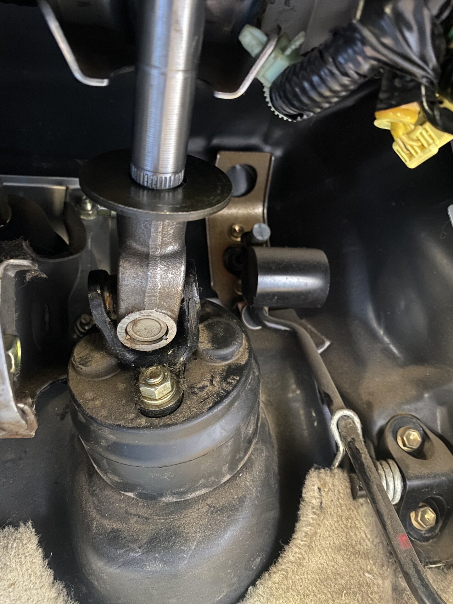

Finishing up this job now on my 99 LX470. This write up was SUPER helpful. Thank you! One question: my shaft looks a little different and I’m concerned that I’m not seeding it all the way into the U joint. Any tips and tricks? I can’t imagine how bad it would be if the shaft came out while driving. This is how mine looks and it seems like only the bottom half of the splines are going into the U joint no matter how hard I pull. I’m considering loosening the joint, setting the shaft in place with the screw and then trying to tighten the u joint again. Does that make sense?

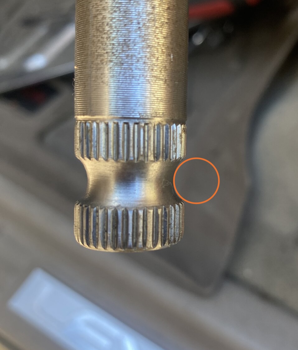

You must remove the securing screw from the u-joint before inserting the shaft. Once the shaft is fully inserted you replace the screw. The screw occupies the groove in the shaft (circle below) and prevents the shaft from pulling out even if the screw loosens.

Thank you so much for responding! I’m planning on working on the car again tomorrow. I think the set screw is in the correct place. I second guessed it because the top half of that spline is not seated in the ujoint. But as far as I can tell, it can’t. I’ll take a pic tomorrow. Do any of you all have a lx470 that you could post a pic of the assembly at the ujoint?
I’m thinking this may not be in far enough. Can any other Lexus owners confirm or deny that? It seemed to be a different shaft than the Toyota one.

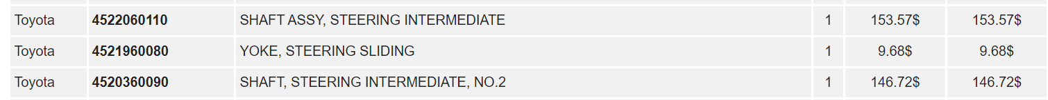

Success! I owe you a beer for the parts list and the help my friend. Knocking is gone and steering is SUPER tight. Thanks again!
