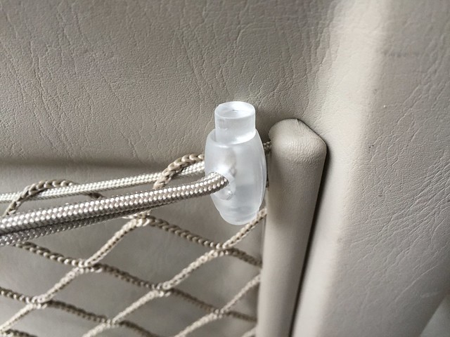

I did this solution. I couldn’t bring myself to spend $50 in broken clips…. I’m sure you could pretty of the zip tie end / cover / different color match zip tie…
I used smallest zip tie. 1/8” drill bit for the 2 holes on each cover.

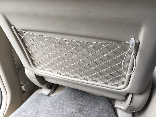

On my 80, the old cords had knots tied into the end and then the entire knot “blob” had been heated up to the point of melting and then stuffed into the plastic rail thing. So I did the same with my new cord. This reddish brown cord was the closest color I could find on Amazon. :(
ED symptoms in full display...
No more “ED” (elastile dysfunction). Both sides start to finish plus install took only 20 minutes total.
