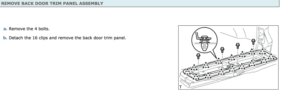

4 bolts and 16 clips...
You got it. Best to use a pry tool with a fork so you can pry directly on each clip from under the edge.
If your pry tool is metal I would tape it with painters tape to prevent scratching.
If you have nylon/plastic set I would use one that looks like the one in the middle of this pic.
The one to the left of middle might work well too, but I'd start with a smaller one.
From the popout in the previous pic you can see the clips should be close to the edge and accessible with a pry tool. The popout shows the panel attached to the clip on top and the clip going into the tail gate on the bottom. You should be able to get a pry tool between the two.

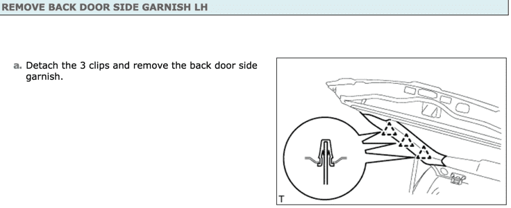

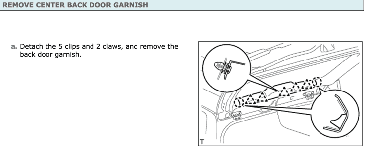

What about the upper section of the lift gate? Want to tap license plate light wires there. Can someone post instructions or a picture diagram? Thx
Check out this thread for actual pics.

Thanks for the info NC237 !
Once I got a couple popped out (plastic pry tool) - followed the surround of the liner, lifted up by hand &
the rest came out easy. Reinstall was a breeze.
