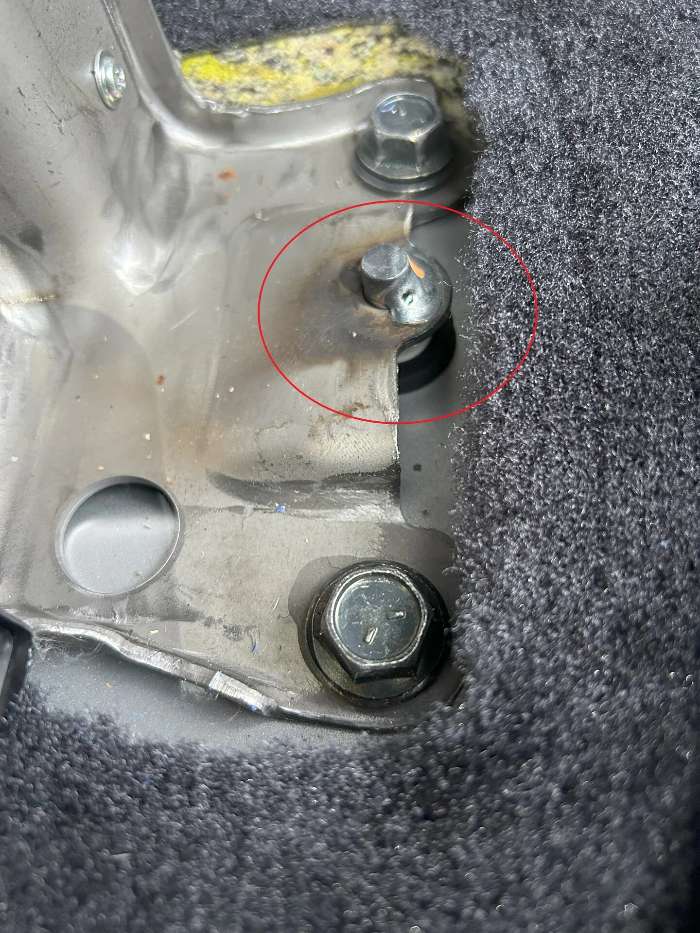

Hello,
Removing the 3rd row seems easy at first and there are a few YouTube videos showing how to do. However, when I started to remove the third row, I encountered a modification that adds a welding spot, preventing the removal. My J200 was manufactured in July 2018. See picture.
It looks like the welding spot's purpose is to prevent the easy removal of the 3rd row. What are folks doing about it? Grinding away the weld spot? Thank you.
OK, I see the bolt is not connected to the frame and can be just pulled out.
Hello,
No. That welded pin comes out with the seat from the bushing below. Only 4 M10 bolts hold the seat.
Seems like you figured it out. That's just a locating pin.
