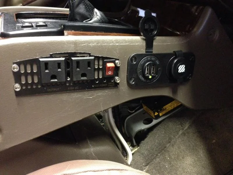

In part one of my power distribution I described the aux. fuse install and all that entailed. Next up was installing the 12v outlets. Now this has been described a few dozen times already. The reason I am going to go into the install in this case is because I will be installing the outlets IN the center console WITH an inverter. The inverter write up itself will be part 3.

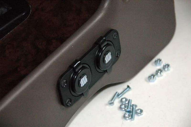

I decided to run with the West Marine dual outlets. I considered the triple outlet but after measuring, I wouldn't have enough room. I really liked the look of this outlet. So I was happy with the decision. One word of caution. The plugs that get inserted into the outlets tend to feel loose. I have found its usually because they are not pushed in far enough.

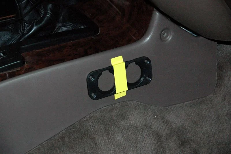

Now for me I was going to be installing both an inverter and the outlets so I needed to be careful about placement. So I went as far towards the firewall of the cab without hitting the bracket that attaches the PS forward screw. While the console is still in place, carefully place the outlet bracket on the console and affix it into place with some tape. This will help you decide its placement AND make sure that its square. I then used a permanent marker to mark the mount holes AND the outlet holes.

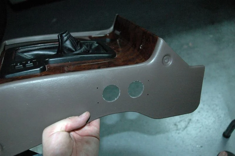

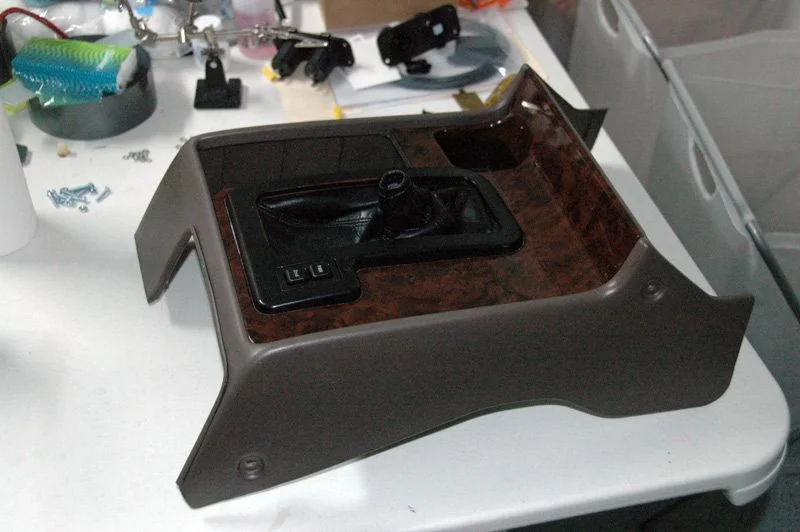

Now you need to drill. The only sane way of doing this install is to remove the center console. This is a matter of removing (4) philips head screws on each corner, then putting the gear selector in drive and starting to lift the console out. Before you can get it all the way out you would need to unplug the PWR/2ND buttons (only 95-97) until you can finally get it all the way out and onto a table.

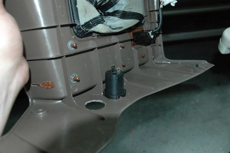

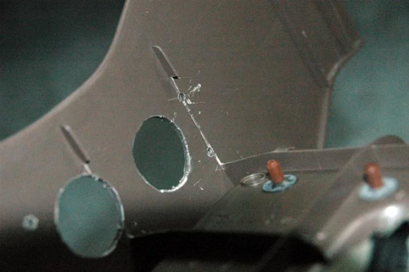

I just followed the instructions on the outlet packaging for hole size and drilled out both large holes just using a wood hole saw. Then just used a small drill bit for the mounting holes. Now once the holes are drilled you then need to deburr the holes. Once that is done go ahead and flip the console over so that you can see if you are now interfering with some of the support ribs that are part of the console. I found that I needed to trim two of the ribs if I was going to be able to get the nuts over the bolts AND get the support ring around the outlets. This was surprisingly easy because all it took was a razor blade and a steady hand to trim off where I need it to.

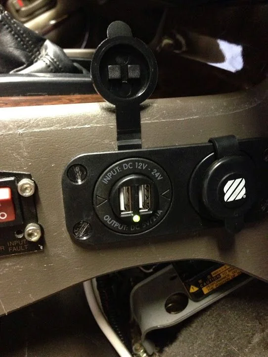

I'm starting to really not like these outlets. Just way too easy for the adapter to slip out breaking the connection to power. I've tried widening the metal springs on the adapters but that doesn't seem to work too well. Next step is to see if I can somehow compress the metal leads inside the outlet to get it to compress around the power adapters better.

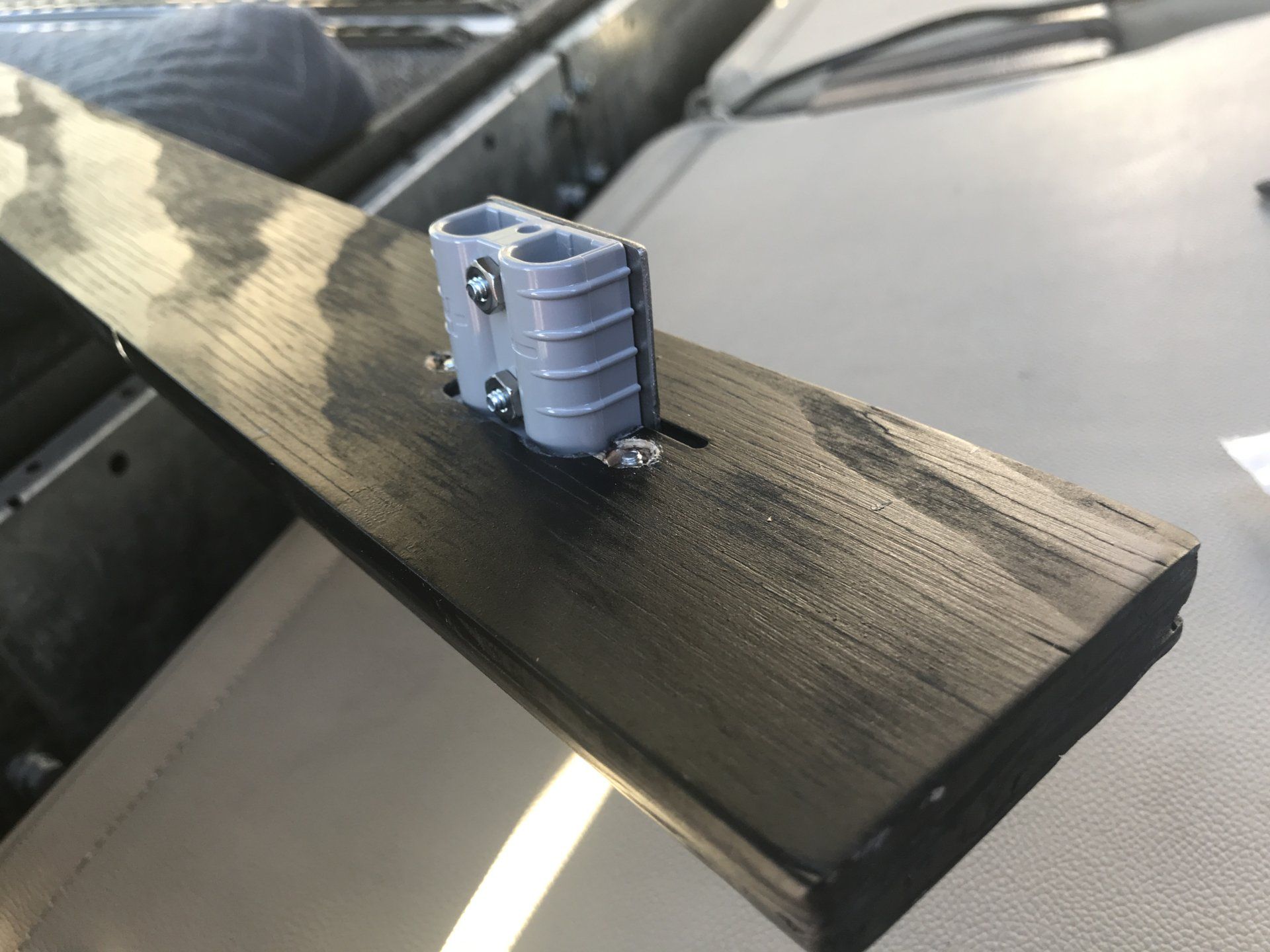

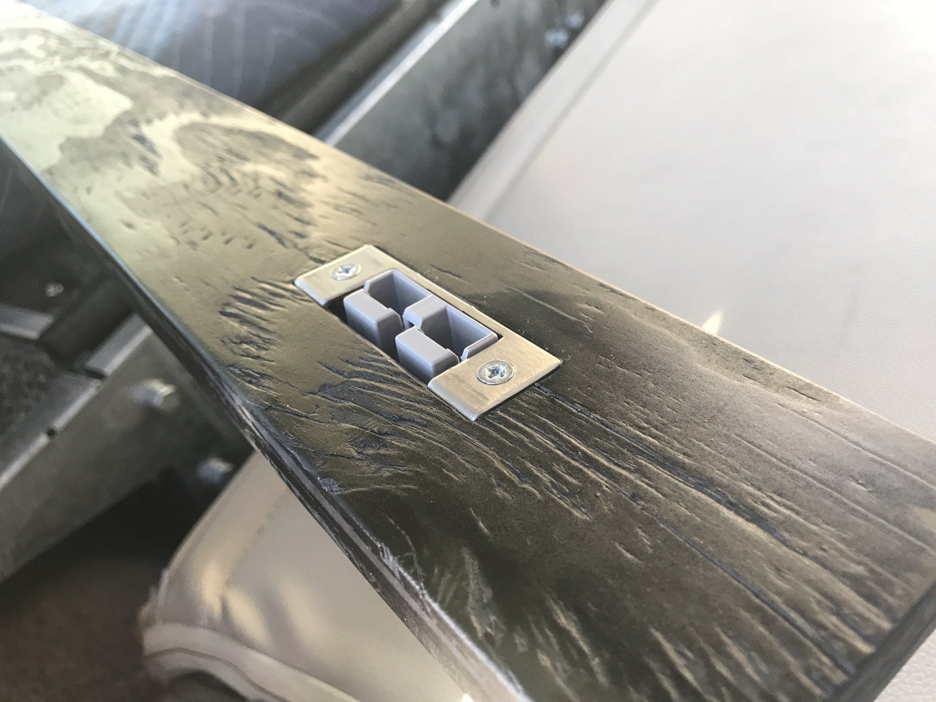

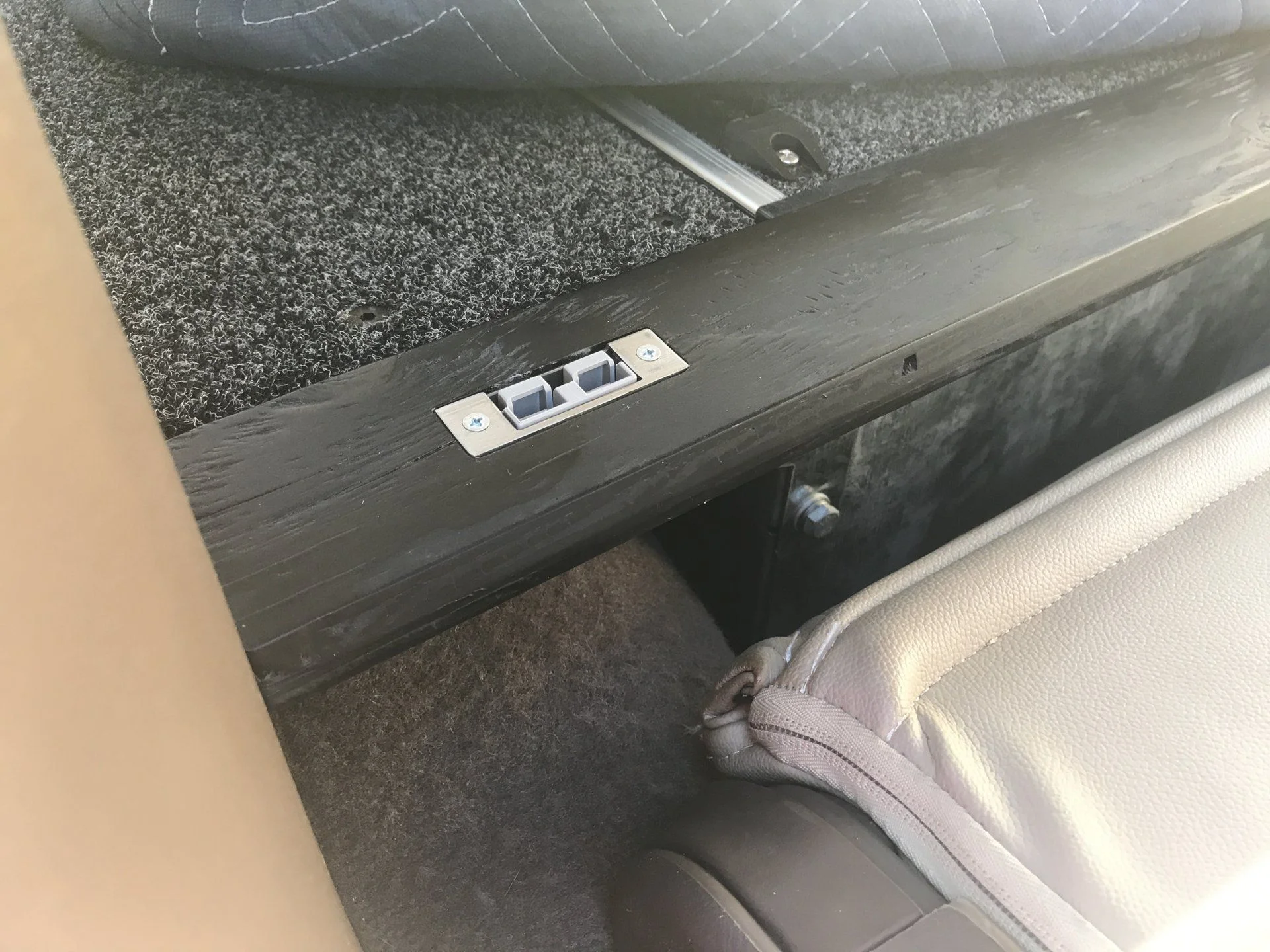

Since I have ARB drawers I’m stuck with an annoying gap between the drawers and the second row. Decided to CNC router a piece of 3/4” birch and then primer and paint it. From there I cut out two slots for my SB50 flush mount brackets, one on each side.
