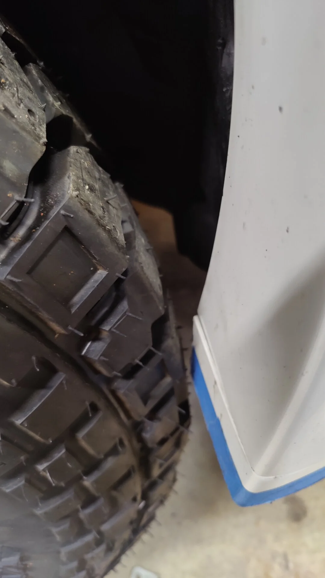

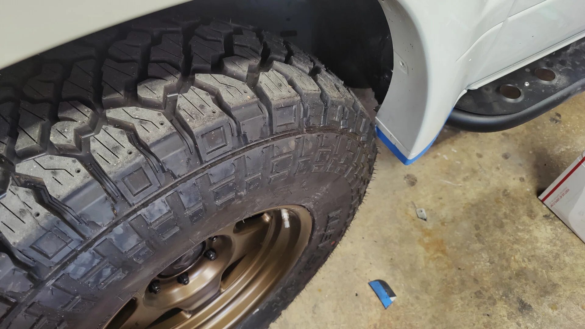

Here's what I've done to prep for this mod:
1. New SPC uppers set on E. Might have to change this later but I'm trying to keep a reasonable caster value
2. BMC - wasn't sure I'd needed to do this but I was already in there and figured why not
3. Narrow 35's - this is huge. 35x10.5
4. Minor offset - my new wheels have -10mm offset

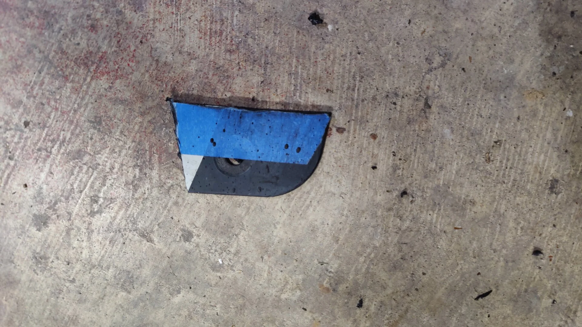

5. I have made some minor cuts to the plastics. Most likely going to need to do a little more cutting
6. fold/cut and fold pinch welds
7. remove or relocate washer fluid reservoir. I got one from an FJ cruiser (don't remember what year, but this is actually important because not all will work.) requires some minor mods to the tank.
see pictures below for current clearance. Obviously this won't work under articulation, but it's a pretty good start for a 35 with room for further adjustment.
I should also note I have not shifted my LCAs at all yet. I most likely won't even bother and just take it to the shop and have them make the adjustment. Make sure you talk to your shop to confirm they know how to handle the SPC uppers.
I've also got a full metal front and rear bumper, so clearance issues regarding those items are no longer applicable
