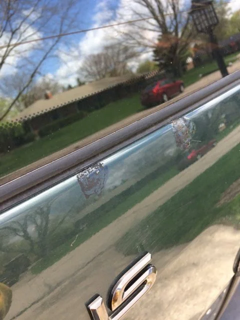

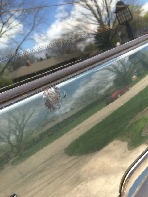

My plan was to grind down to metal, prime and paint with OEM matching color. I was going to mask around the bare circle I create with a wire brush attachment I purchased for my drill. Thought this would minimize painting more than I needed to and reduce the area that won't match the original paint that well.
Am I missing anything or is there a better approach?
Where that is located, I'd pull the rubber and fix underneath where it is.
With that small of an area, you could be more precise with a dremel tool and some sanding stones. You can also get stones for the drill, but I'm not sure it will turn fast enough to work well.
Wire wheel is wrong approach. I agree with the other guys, removing the window might be a good idea, so you
can address any rust under the rubber; you're not going to be able to work around the rubber without damaging it.
Instead of wire wheel, get a sanding disc flapper wheel. Looks like a bunch of pcs of sandpaper glued to a disc.
This will be far better means of removing old material. Keep to small area, but make sure you clean off all the rust,
then use rust converter over the bare metal, even if you can't see any rust.
Do this all at the same time, as soon as the rust converter is cured, put a couple of coats of primer right away, then
paint. You can even buy small spray cans of clear coat to finish.
Good luck

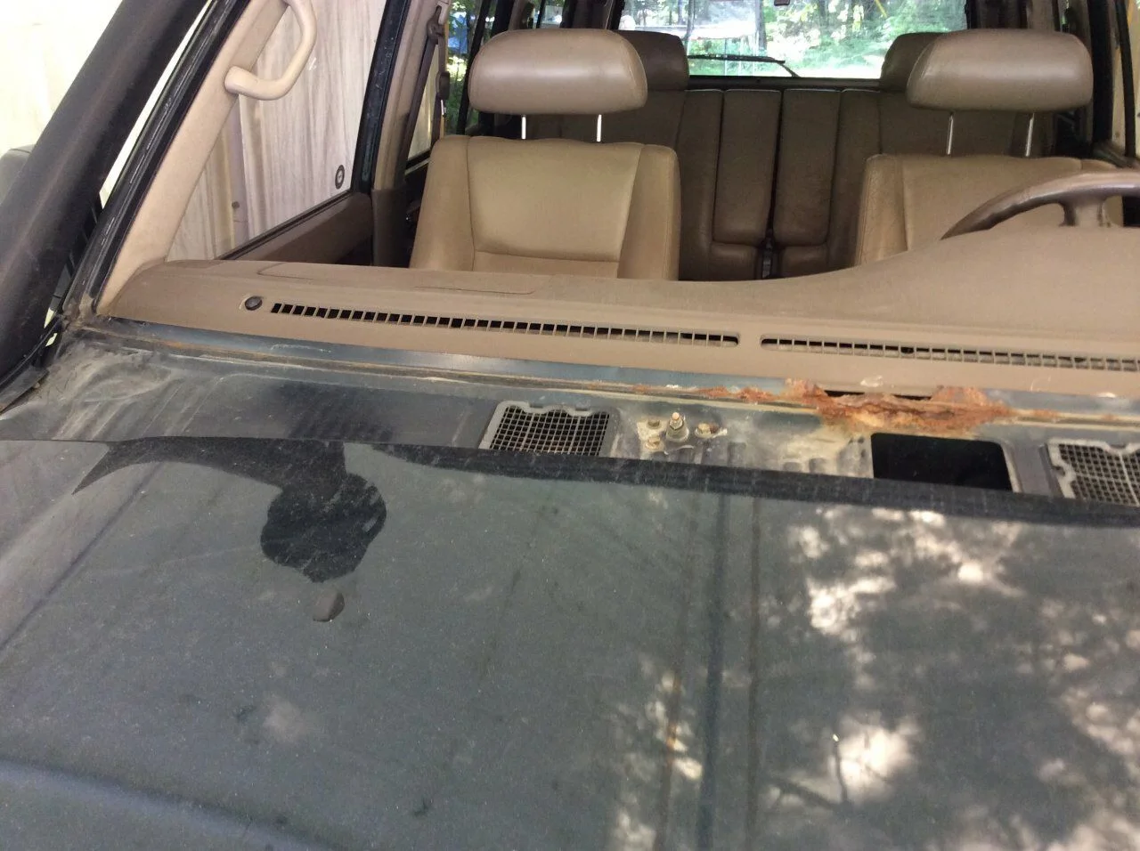

I had me windshield replaced last year and they called me to have a look before proceeding. This is what they found. No rust was visible from the outside. It was a major pain to fix, but I managed. As others have said, if you want to do it right, you need to pull the window.
