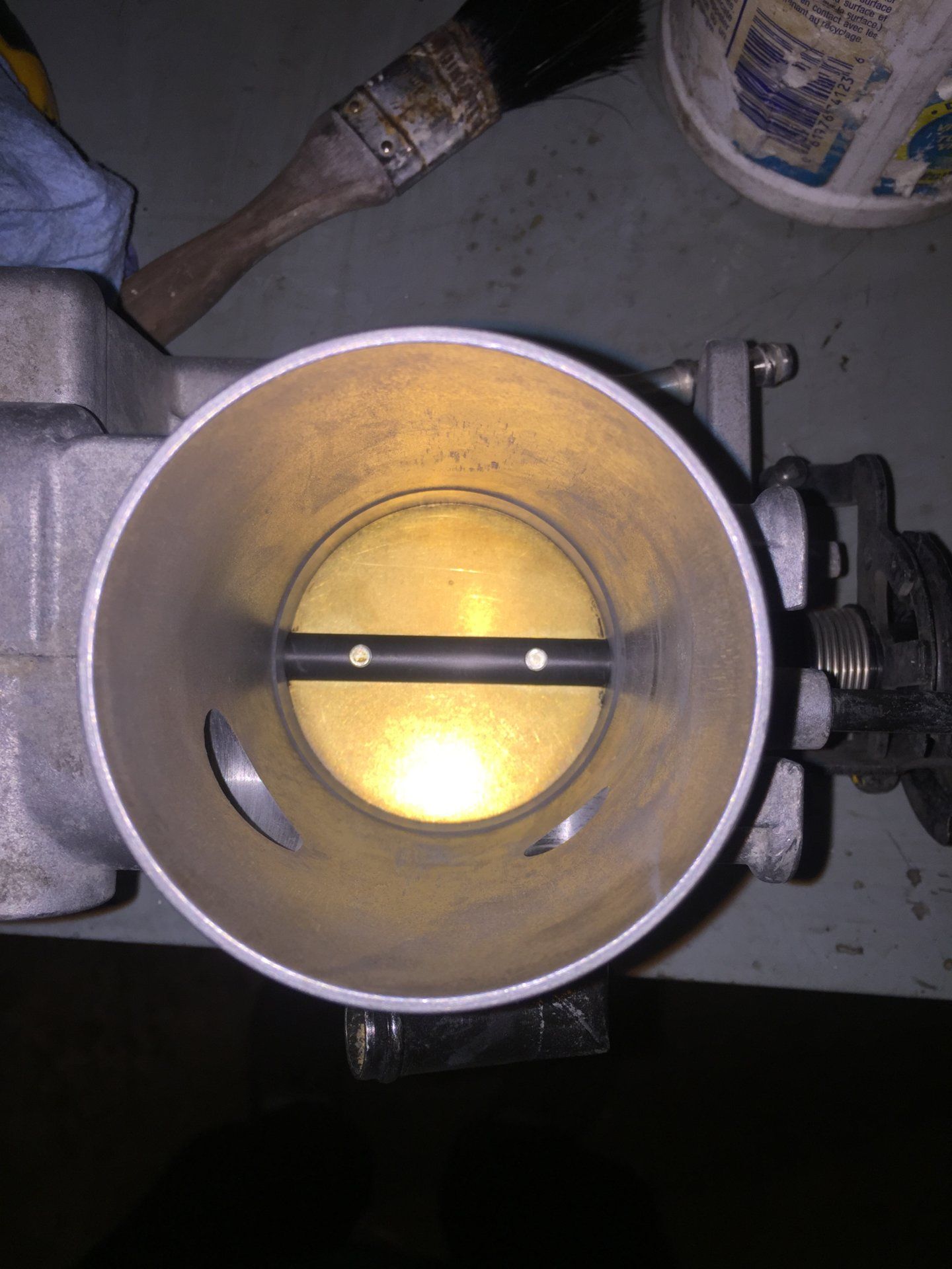

I just did mine. I removed all the electrical parts. The IAC will require cleaning also so best to remove it, you will need a replacement o-ring for it.
Anyways I used brake cleaner with a brush, it worked okay but the will be some hard crusty carbon that will require mechanical action to remove. I used a dental scalpel. Then followed with scotchbrite soaked in brake cleaner. This got it pretty darn clean. Finally I used a water based degreaser to scrub the whole thing, it removed any final dirt and then it was rinsed in running hot water. Nice and clean now:cool:
