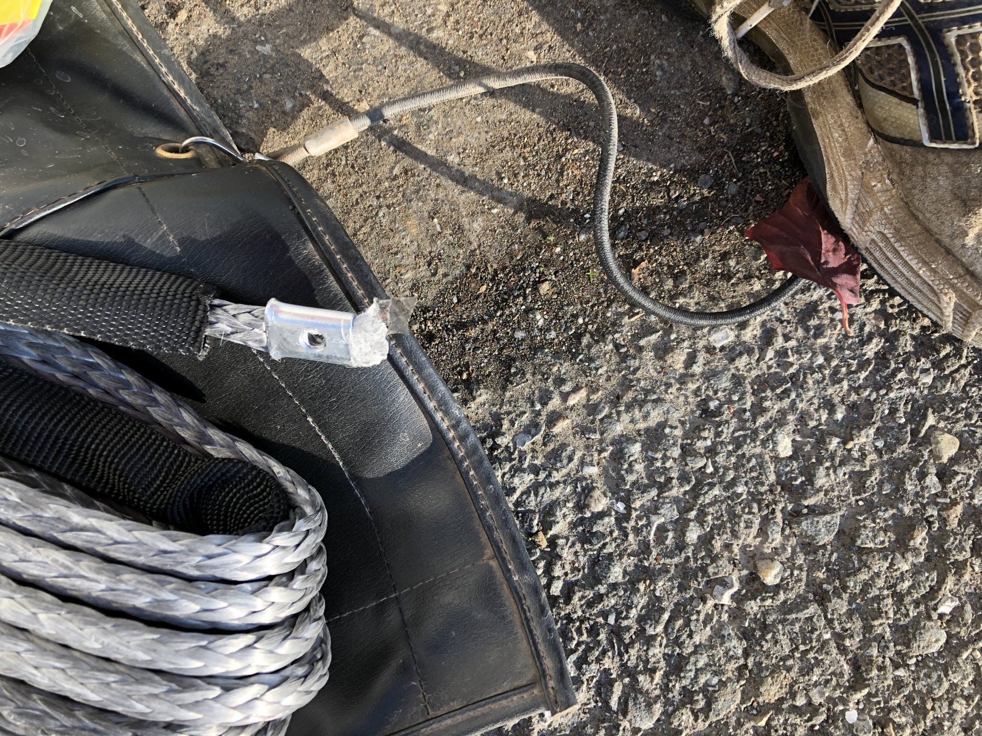

I removed the steel cable on my 8274 winch, the end of the cable went through the hole in the drum and was doubled over and secured with cable clamp as seen in the photo. My new Smitybilt synthetic cable has a thimble over the end with a hole through it. What’s the best safest way to secure the synthetic rope to my 8274 drum????

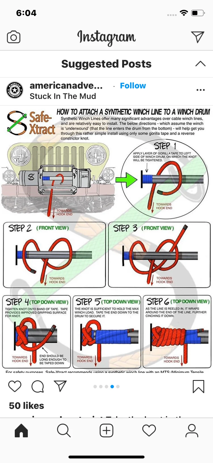

I think I would cut your thimble off, push your rope thru and just tie a knot at the end. And make sure you stop pulling with still 7-8 full wraps on the drum. I think that would be safe.

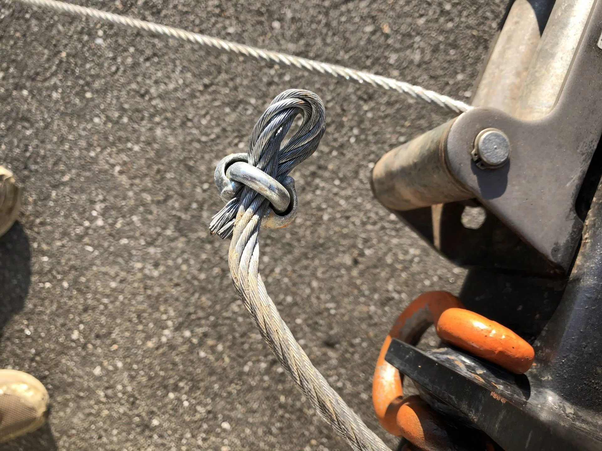

I spliced an eye in the end of my winch line then girth hitched it to the drum. Similar in strength to the knot shown above. (ie larks foot versus clove hitch).
This is exactly right, and what I have on my 8274 with synthetic. Works perfectly.
That procedure that @landwagon posted would work, but it's a waste of line tying that knot on there. The knot doesn't keep the winch line on the drum, the wraps do.
