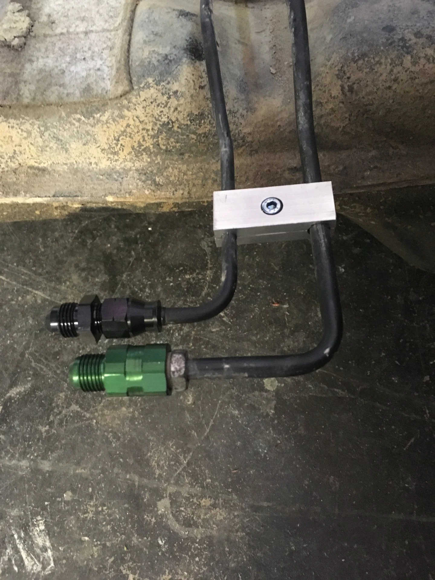

TIG welder is one option, or there's a fitting you can buy. I think the company was called Radium and they were the only ones that made it. It might be in my build thread

Use a 1/4" pipe thread to -6AN fitting on supply and return

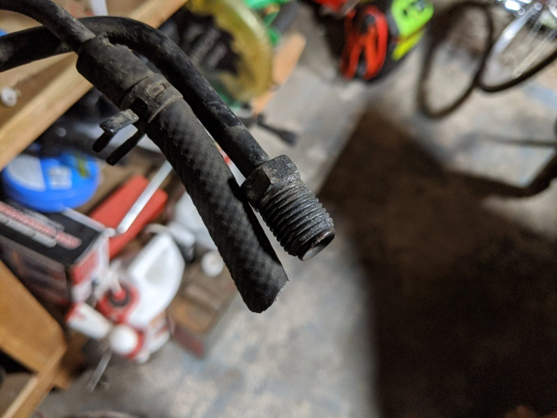

Also considering cutting off the flare and using something like this, bad idea? , but that tanks inc setup looks ideal if it's bolt in.
Amazon product ASIN B07DXW4C6B
This works too and is one less fitting. I have a few of these on my fuel system on the pressure side with no issues.

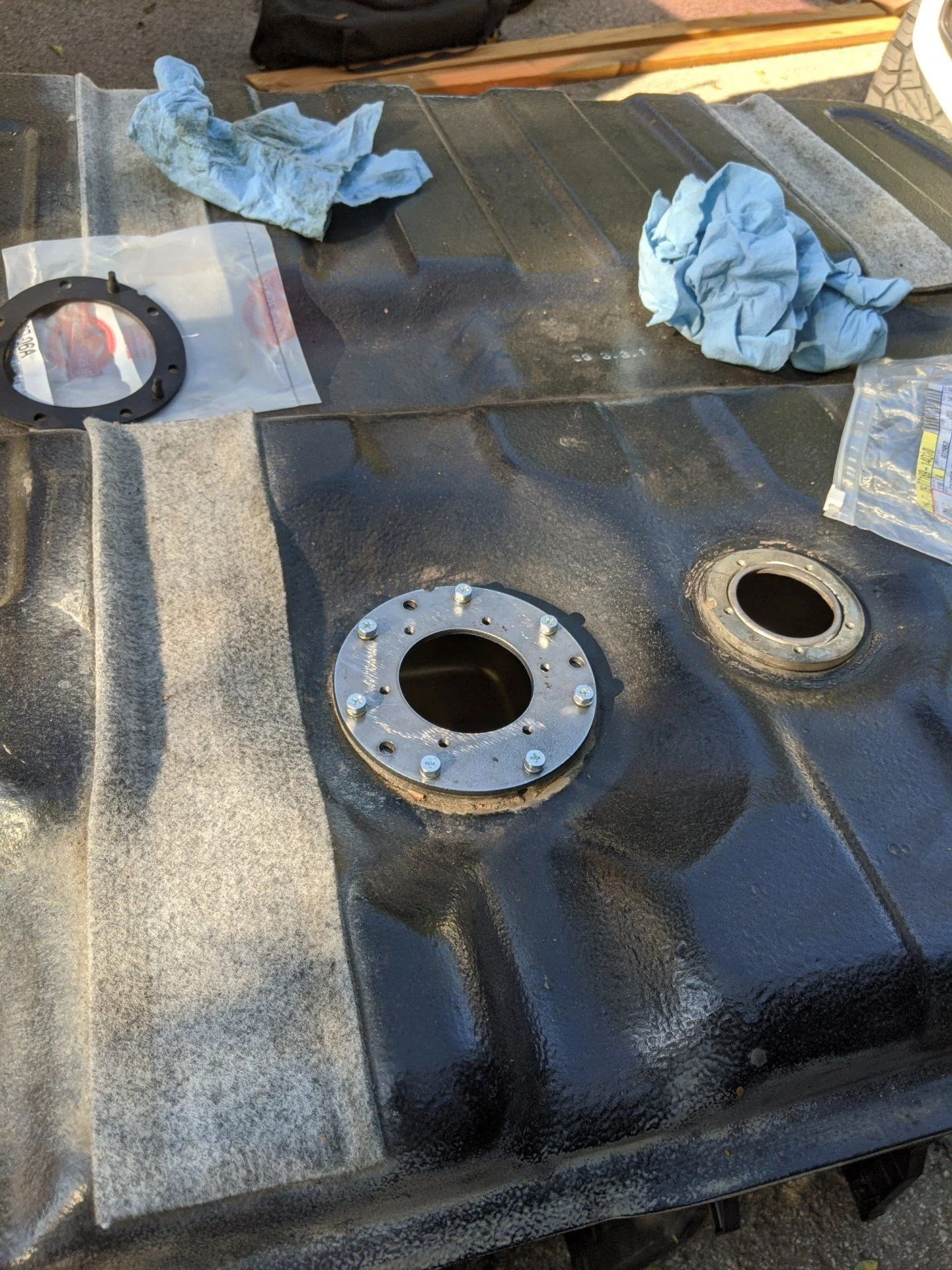

I make an adapter to fit the tanks inc fuel pump module and bolts directly to the fj62 tank. Comes with all new ss mounting hardware just need a new oem fuel pump module gasket and make sure you get a fuel pump module gasket from tanks inc as it doesn't come with one they offer a cork and a neoprene one either will work.

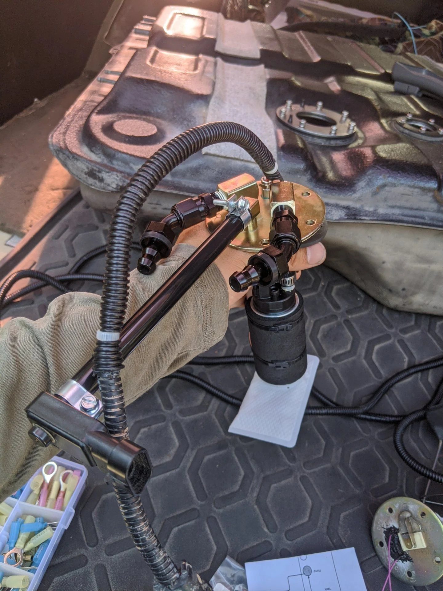

i love mud, and appreciate all the different approaches. here's what i went with so that it can help anyone else in the future.
i used the tanks inc adapter from @tmxmotorsports for the fj62 tank, and used the gpa-2 unit from In-Tank Fuel Pump Module - GPA-Series
i used this line and fitting kit with the 45 degree fittings from tanks inc. GM LS Engine Fuel Line Kit
the tanks inc setup is nice especially for me as i need this to be CA compliant and the evap system needs to be working . i used the vent barb to connect the pressure tank sensor (long black tube)

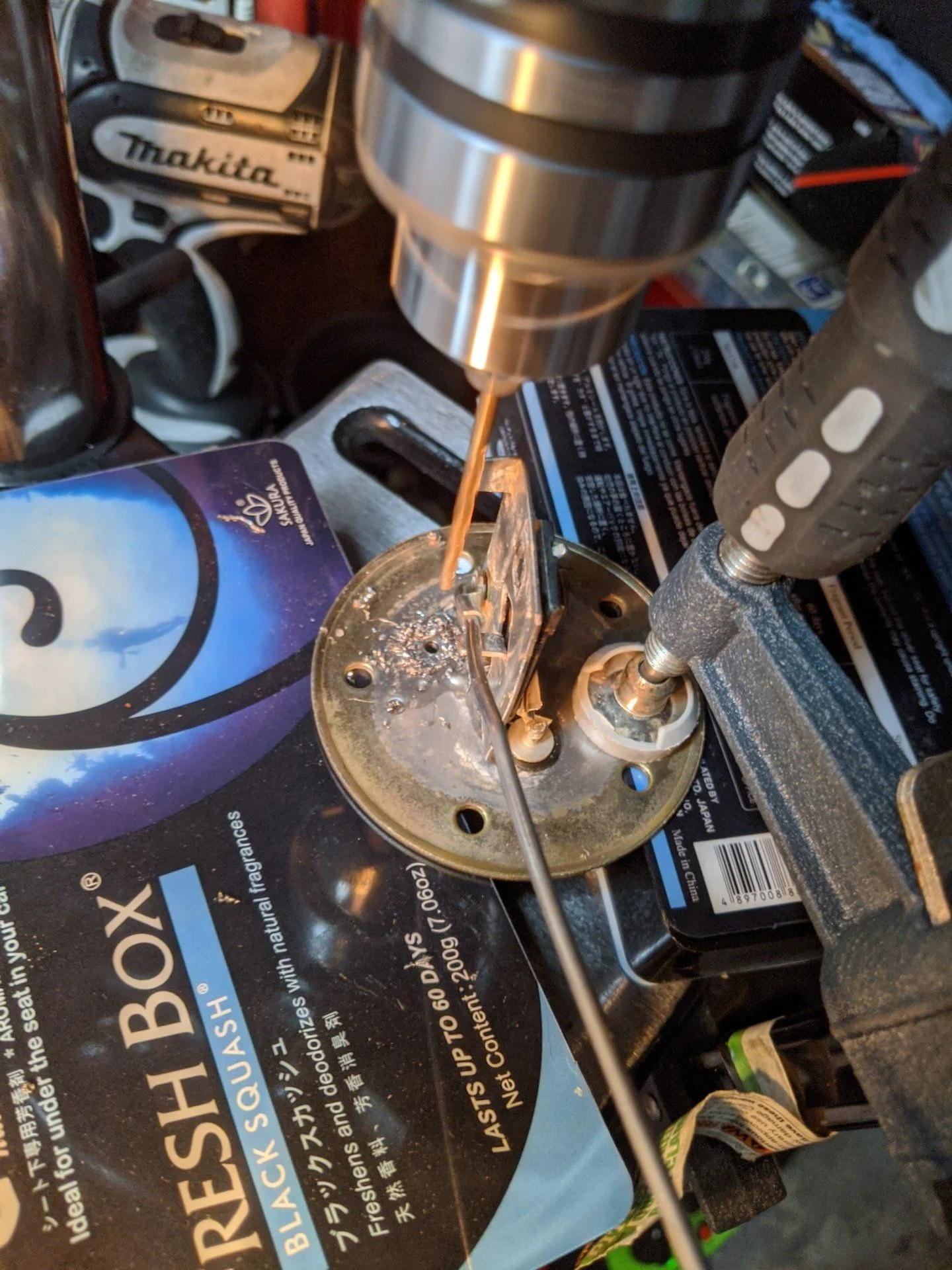

I then referenced and old mud post how to setup and run the GM fuel sending unit wires (which is needed for the evap system to run) in it, they suggested using weather pack connectors, to create a sealed gasket.

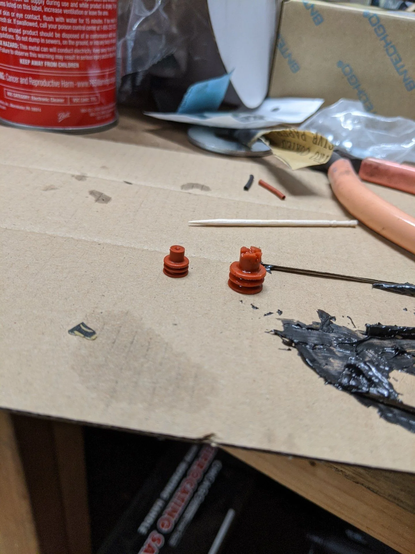

DO NOT DO THIS.
Before and after of the weather pack gasket exposure to Gasoline (probably has silicone in it which causes it to swell up.)

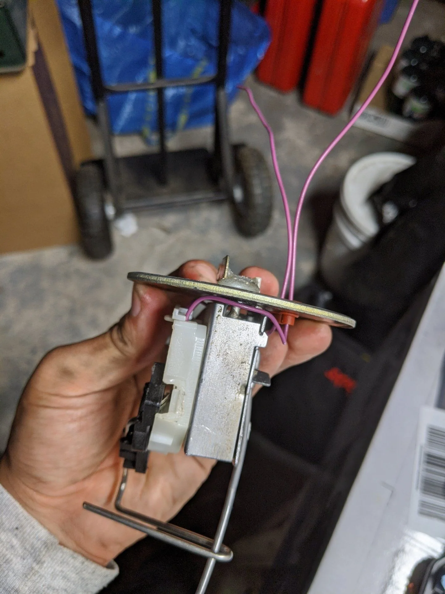

hated doing this but ended up using marine tex GREY epoxy, it's fuel resistant to seal the fuel sending wires... atleast since i can access the fuel sender from inside if it's ever an issue i can redo it.

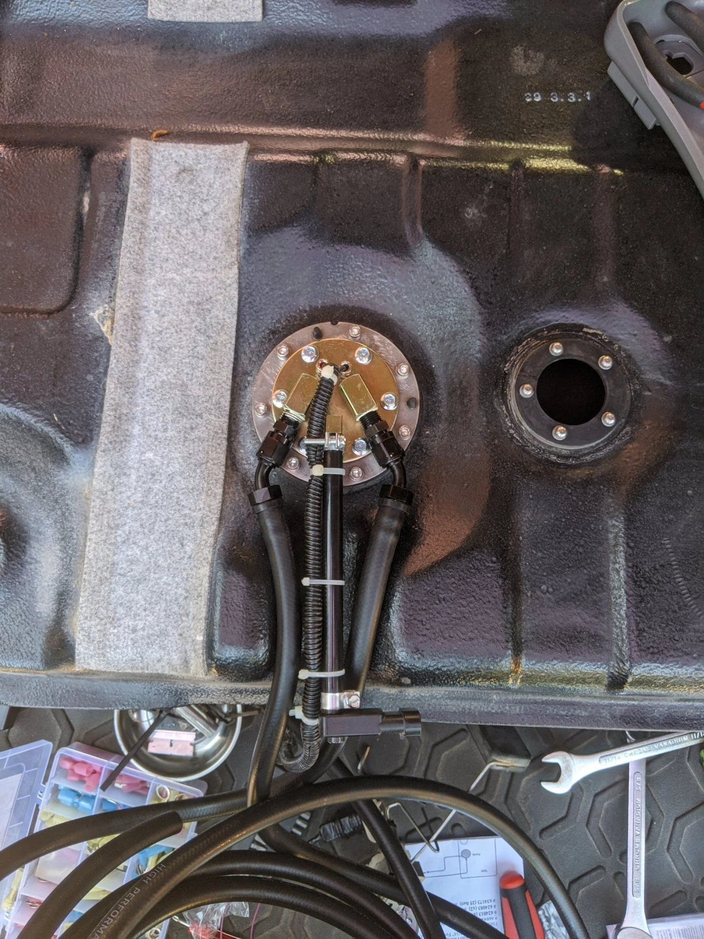

Lastly a better pic of the fuel pump insatlled.
