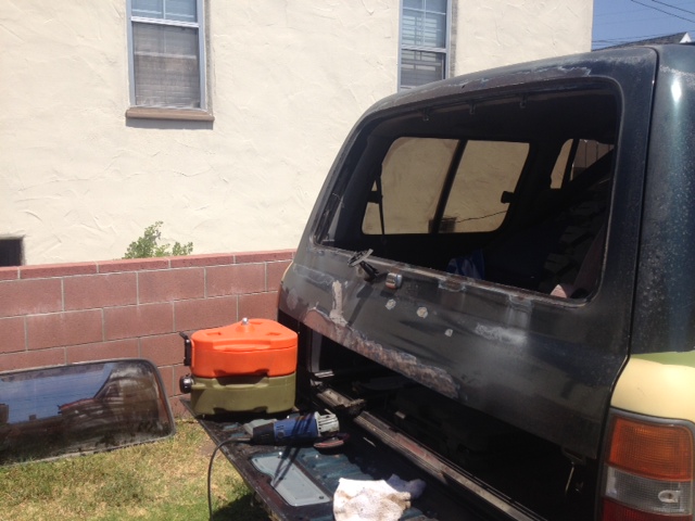

yes, even with major rust, the gasket is durable. heres some recent pics of the rust that i had to deal with. with it this bad, the door needs to be replaced but its a trail rig so i sanded it down and sprayed some rust inhibitor on it and put the glass back in. its an easy job
if its as bad as mine, theres nothing that shop can do but what i did and put some sealent on it. in other words its kind of waiste of money to have a shop even look at it.

check your local auto parts store for window sealant. i used a flap wheel to sand the loose rust off. but if i got rid of all the rust, i would of have lost my window seal, lol. so i just sprayed it with rust inhibitor and put the seal back on. on the outside of the window where there is rust damage, i flapped it down and bondoed it and then painted the rear door.
