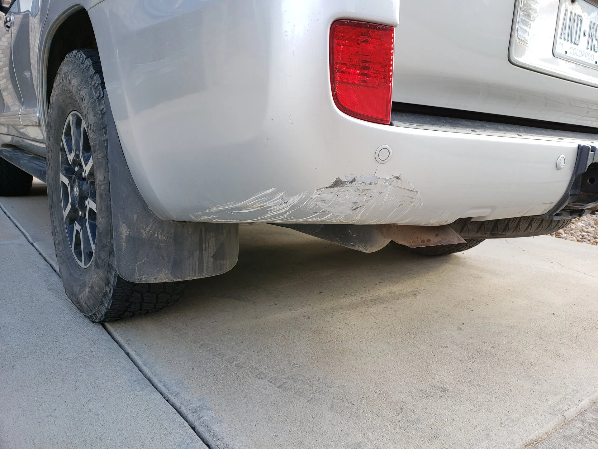

I understand the hesitation with pristine body work. As with all cruiser wagons (including the 80), the LX570 has a big butt and likes to drag it over things. Unlike previous generations, there is a lot more plastic back there and if you look at the 200/LX570 in profile, the bumper plastic is indeed quite a bit lower than the 100 or 80. But putting it in AHC high and driving carefully will get you through most "normal" departure situations. The real tough trails are going to mess up the plastic--no way around it.
