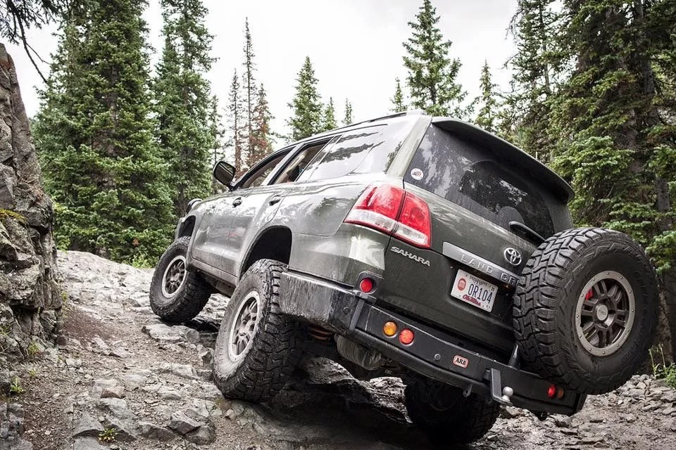

I'm at 3-4" front - rear might be a bit over 4" w/ 2724 spring plus a 30mm spacers... on 37's it's a great DD but for sure there are compromises..... 35's at 3" probably are the sweet spot.
that said my wife loves it enough it's become her DD.
We need more pics of the beast! I lean towards function, but form is certainly hard to resist! Especially when it looks as good as your rig.
