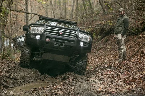

Reckless, you live in Chicago, the closest wheeling you will do will be out of the city and will have trees everywhere. See that tree in the background? Do you really want to be doing unnecessary body lifts that get you even closer to low hanging trees and make you feel more tippy when off camber?
Oh that that’s not me, I don’t know who that guys is.
