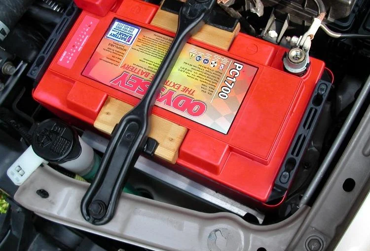

Mine - the original Panasonic - is just starting to die. 8 years and 110K miles. I just ordered a Odyssey PC1700 MJT.
