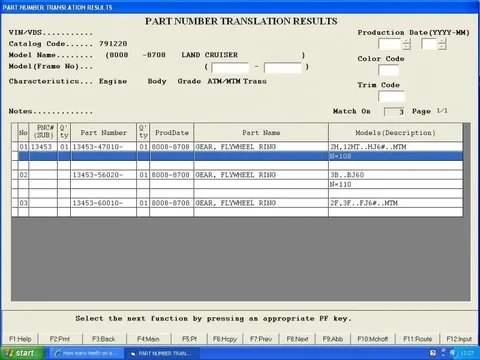

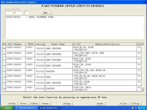

Hmmm. Looks like I have 110 teeth on mine (Ring gear part number 13453-56020)
:cheers:
12HT looks like 108 teeth DAVID:

Thanks .. interesting .. I was under the impresion it will have more teeth .. now come to my mind if the entire flywheel share the same overal diameter ..
And ( thought no ) the Tach sensor are the same ..
Thanks guys! I tried looking it up on ToyoDIY and it didn't have that detail for me for the 12H-T...so I did need that number from Lostmarbles. Thanks for thinking of me, Tapage. :beer:

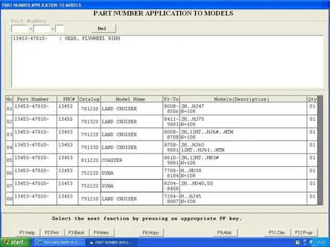

In case it's useful to any lurkers - Here's a printout of all the vehicles that got the 108 teeth 13453-47010 ring-gear (according to my EPC):
