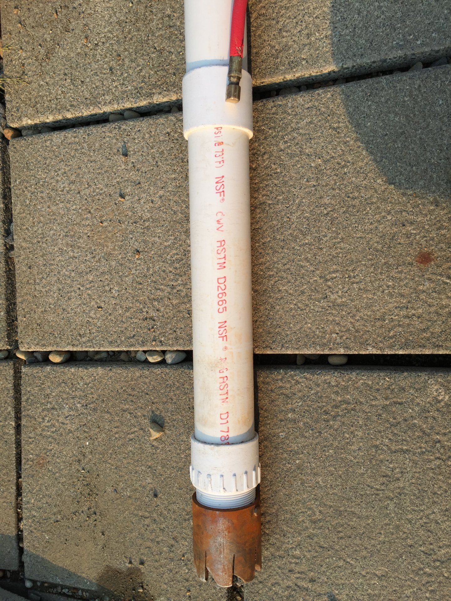

The drill.

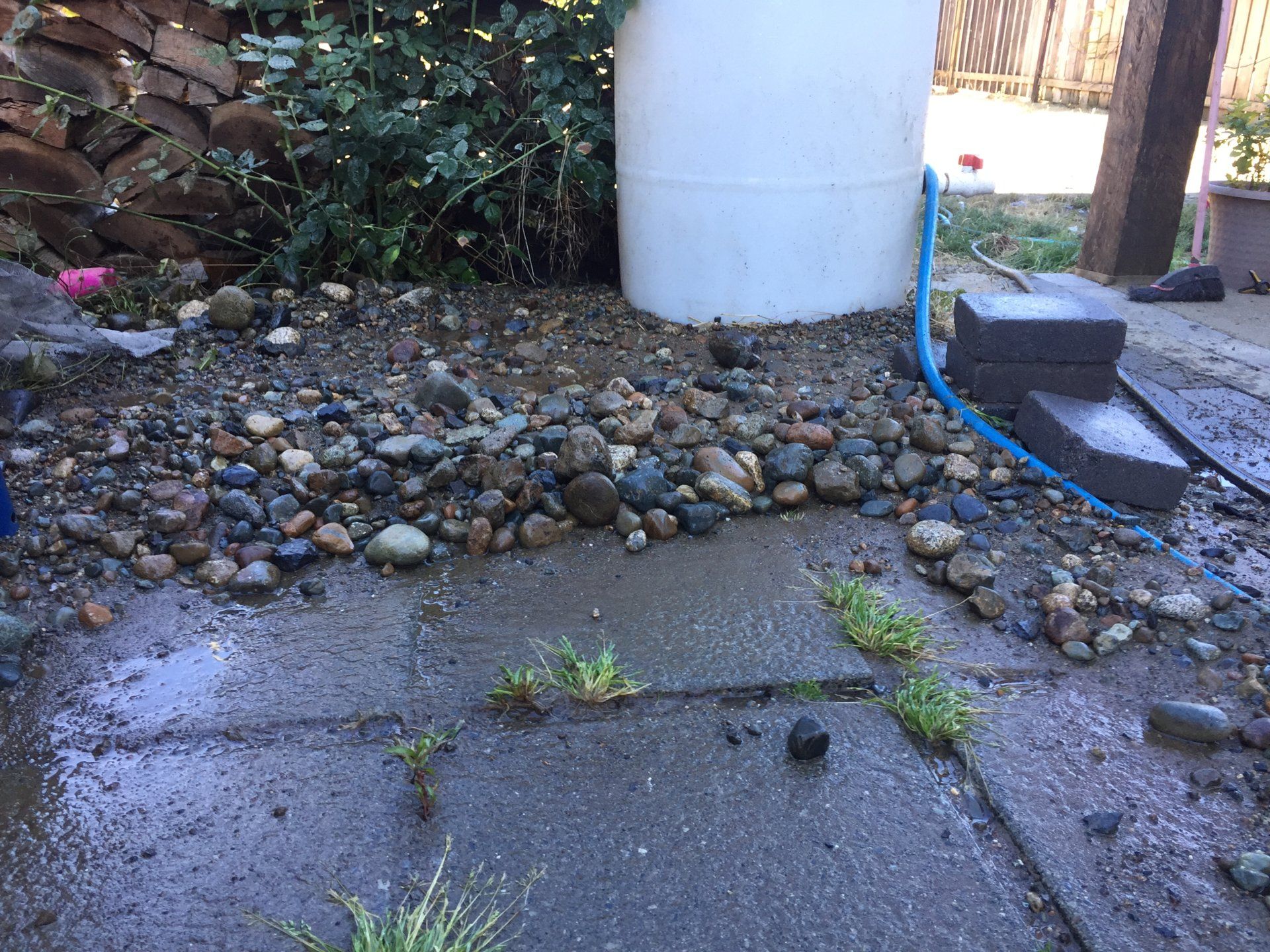

The mess I made on my patio. Langford potatoes they call this, rocks my yard is made of.

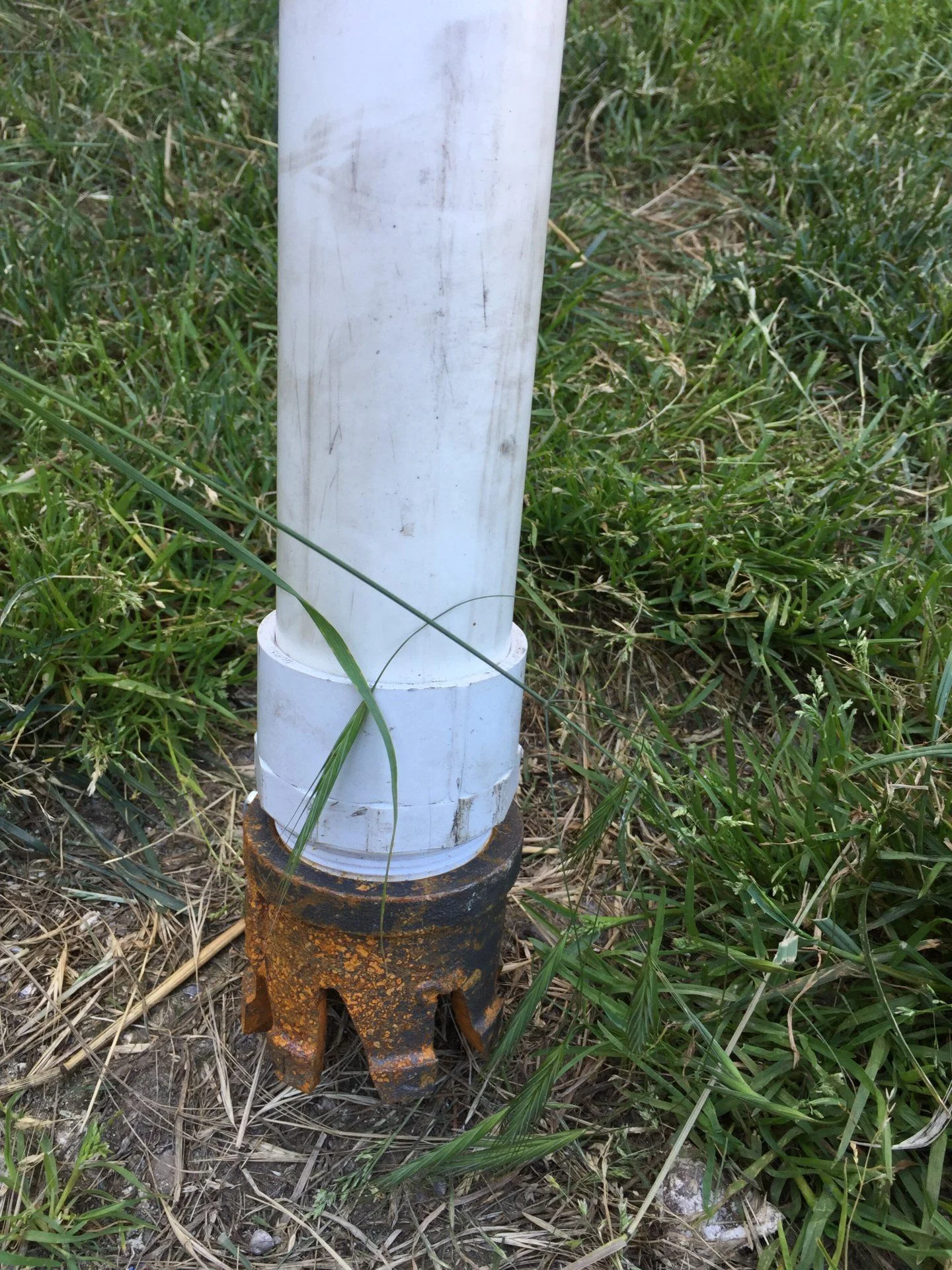

One of the big ones I shot out of the pipe.

I have been especially irritating lately as I have been drilling my own well. More like hydro vacuuming a shallow well with pvc. I have two noisy air compressors running almost constantly. With the water table at 15 feet below my yard I had to. I have one well in and am working on a second At 25ft. the legal limit unless you want to get permits.
The drill.
The mess I made on my patio. Langford potatoes they call this, rocks my yard is made of.View attachment 1610172

This is how my method works it’s a little different than that.
I got 40ft of pvc In my case I started with 2 inch wich worked well but some rocks were too big so I upgraded to 3 inch.
I cut it into 5 foot lengths with threaded couplers.
On the drill head I went with a steel coupler with teeth cut into it. two feet up from the drill teeth I put a coupler To attach my air hose fitting.

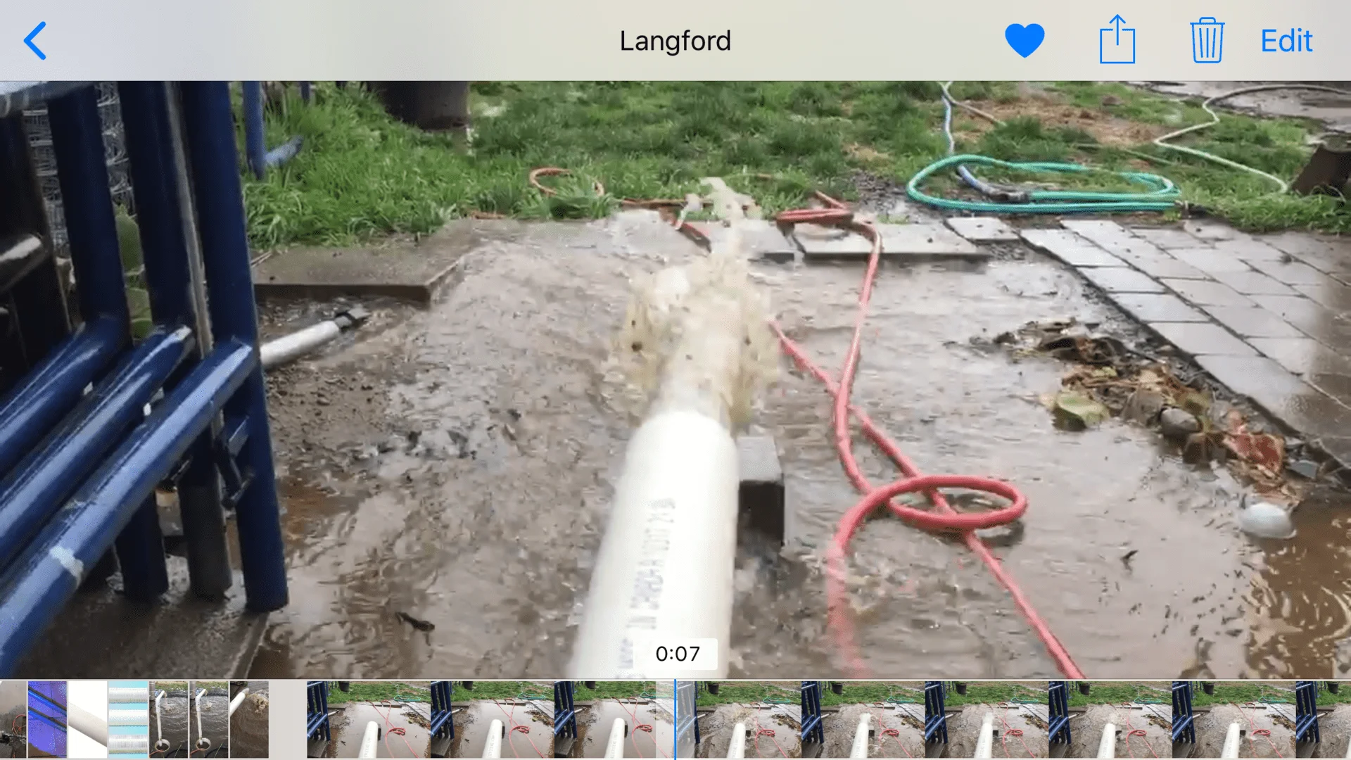

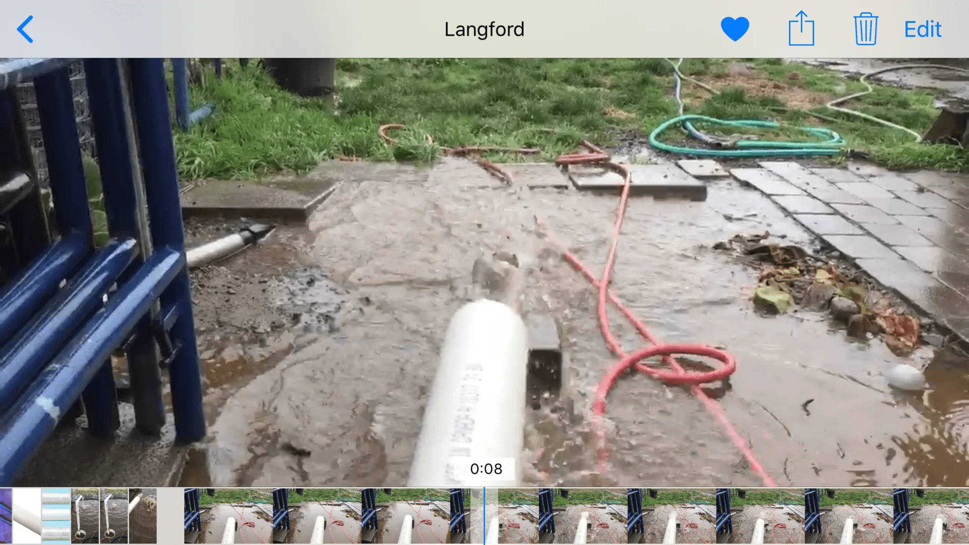

At the top you have a 90 to direct the rocks and water away.
Haha and when you turn the air on it all comes jetting out!
Not fast drilling but sure is fun. Will try to upload a video. Happy to show any of you guys how to.
