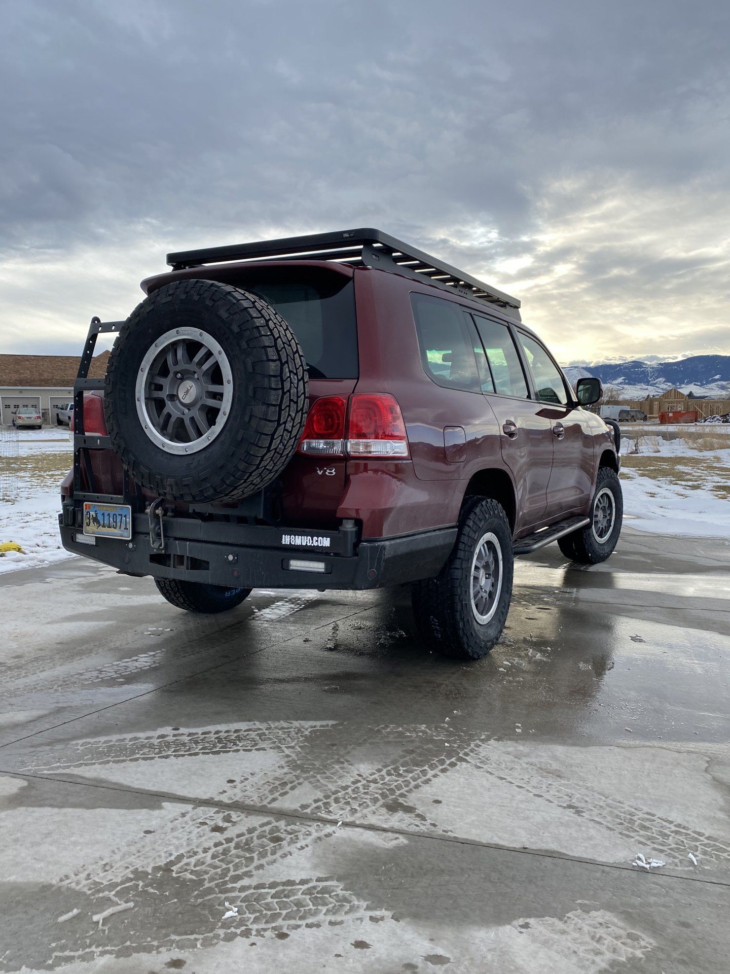

2008 LC
ARB front with ComeUp 9.5
Slee rear bumper
Slee Sliders
FrontRunner rack
OME springs all around
Cooper Discoverers on RW’s
6760# (or as us engineers would say, 6.8 kips)

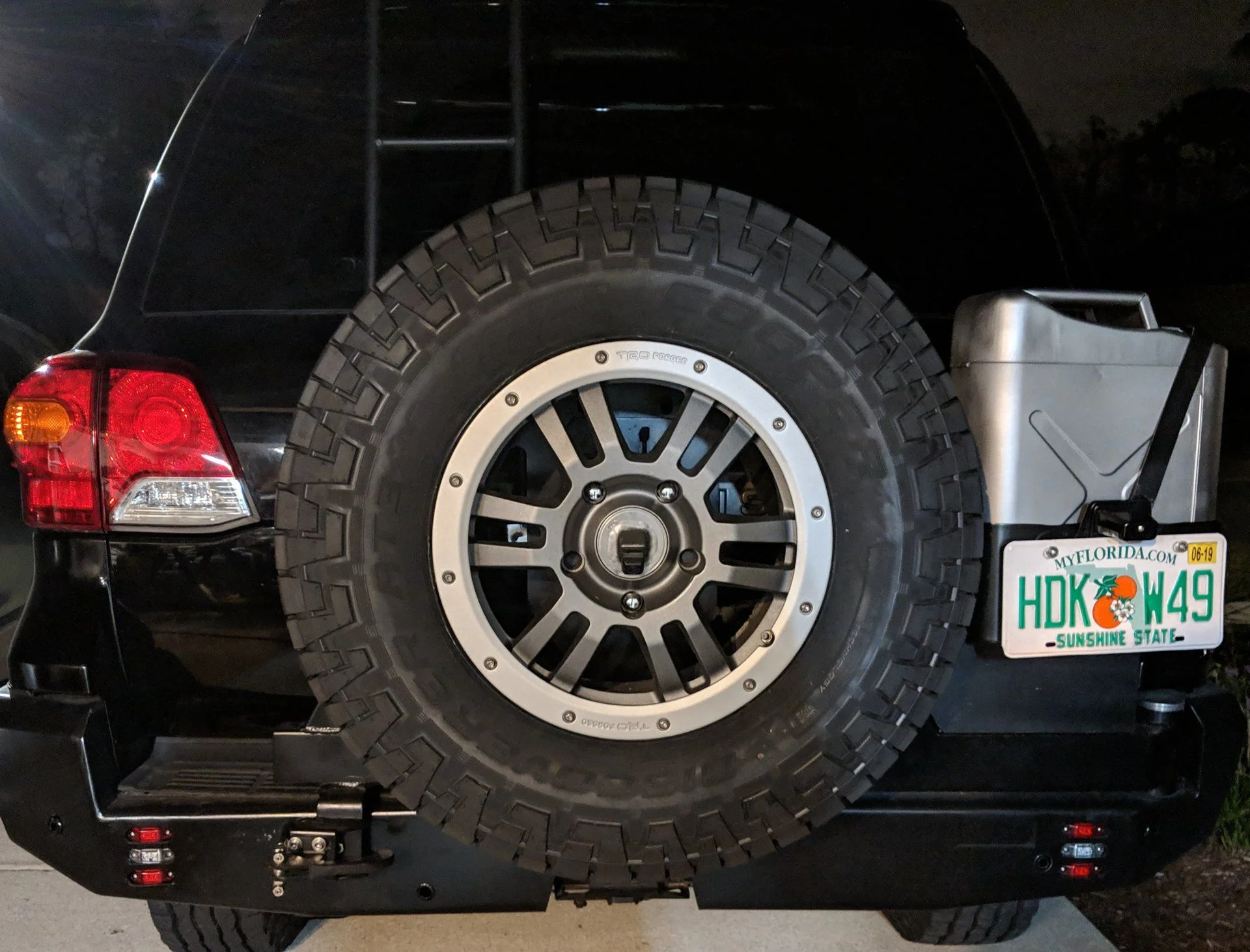

I just weighed with a 3/4 tank of fuel and +/-5 gallons in the 40 gallon LRA - 3100lbs Front, 3460lbs Rear = 6560lbs Total
I then topped off the main tank with 8.5 gallons and then added 30 to the LRA. 3060lbs Front, 3760lbs Rear = 6820lbs Total
This is only my 3rd or so fill up since installing the 40gal LRA and I've noticed such a change in handling, that I will soon (like ASAP) go to a stiffer spring and maybe an airbag as well. (For travelling with 3 kids, a Great Dane, and all of our luggage.
@terdrocket - makes sense - the tank and equipment weighs something, plus 40 gallons at 6 lbs per gallon (240 lbs) - you have a bunch of extra weight back there behind the axle.

Plus I have this bad boy hanging off the back.
I did take out the 3rd row, as I realized it hadn't been used in a year or so.
