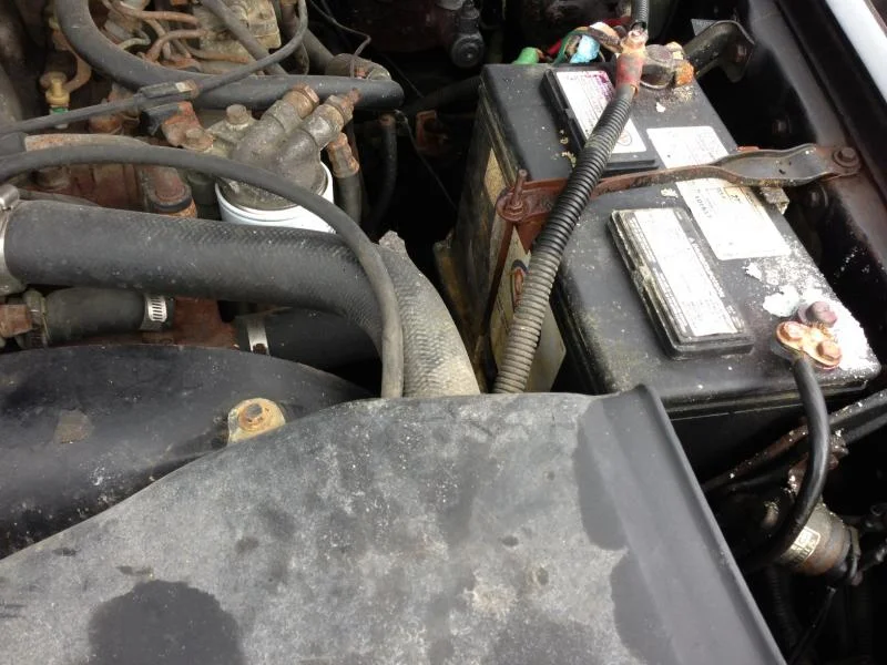

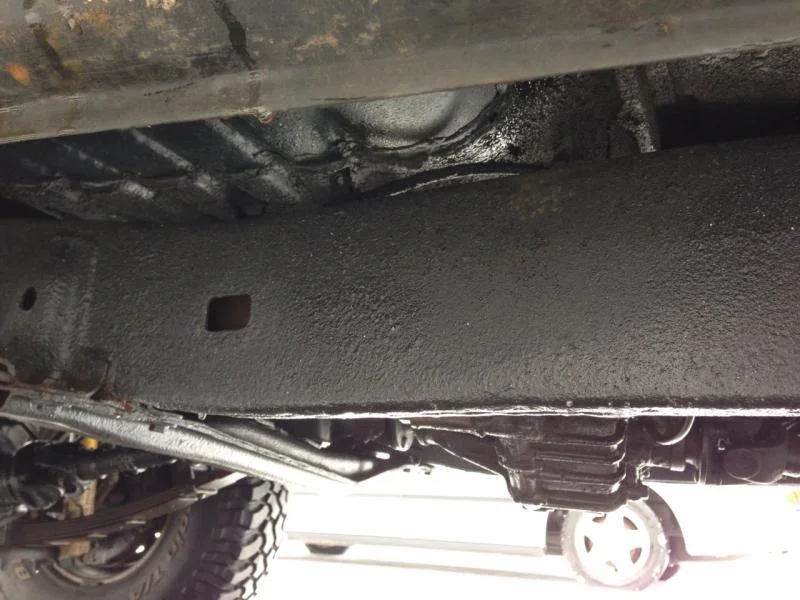

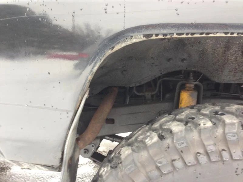

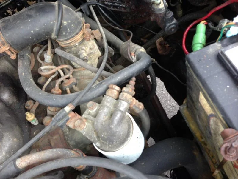

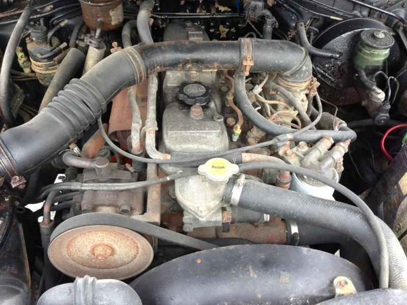

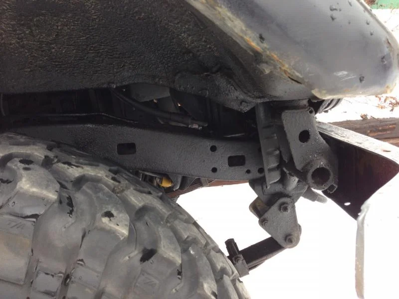

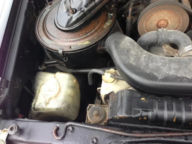

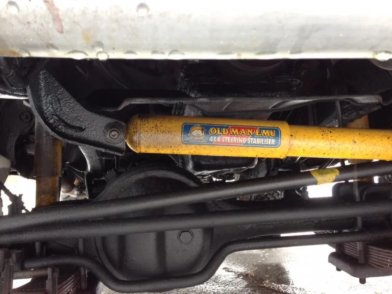

Hello, I am just interested in LC enthusiasts opinions on the condition of the frame of this BJ70 I am getting. It looks good to me but just thought I'd ask. How does the engine look too? Any input would be greatly appreciated, thanks ! :hillbilly:

PS I am not interested in the cosmetic appearance of the truck as much as its mechanical soundness and ride. TLC will come after, but just the basics are for now. cheers
Looks like there are some lines not hooked up to a canister by the P/S and fire wall and on the passenger inner fender well by shock tower. Batteries look to not be maintained as evident by the corrosion on the bracket and terminals.. Given my impression on just seeing pics I would definitely poke the rear frame by the rear spring hanger for soundness. I would go thru all the fluids/filters and change them to start a good base line. Good Luck and welcome to the 70 CLUB...
Hello,
The engine looks battered and there is rust. However, the chassis and suspension look suspiciously "clean."
It appears the coating/paint fairy visited this Cruiser, at least its chassis.
The suspension looks well replaced.
As someone wrote, poke the coating for rust.
The shots are not enough to look for body paint bubbling due to corrosion. Check the fenders first.
Hope this helps. And hope this one is not a lemon.
Juan
hey guys thanks again for the honest help. just wanted to add that i am paying 5000 for the truck and looking to put at least 1000 into it this summer alone if not more. (most likely more) . I just cant pass up the opportunity to own a bj70. I am taking a risk, yes, but a semi knowledgeable one at that. if you could even call it that :) anywho looking forward to getting it june 1st and will keep posted on frame condition and other repairs that will inevitably appear. cheers
Can you weld? If so a grand could go a long way in frame and body work. If you have to farm the repairs out it will take at least twice that to get it solid based on the pics and obvious lack of basic maintenance under the hood. I bet this one will have a "lot of surprises " along the way.
Pull some carpets up and check the floors, pull the plugs hiding the body mount bolts as well, take a look behind the interior panels at the rear wheels and quarters.
