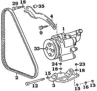

how do I loosen the smog pump so i can move the belt?
loosen or remove the bolt(9)that goes thru the adjusting bracket and into the smog pump, its the one facing the radiator
down by the motor mount, loose the long bolt(12), it needs a wrench on both ends or it will just spin
thats it, it may need a bit of a pry to get it to move. Chances are its seized up, you can gut the pump, replace the pump or get a smog pump eliminator kit(its just a pulley) The same belt also turns the waterpump.......so you need to have something there.
Here's another drawing.
The bolt on the left is the lock bolt. Loosen it.
The long bolt on the bottom is the pivot bolt. Loosen it a tad.
The bolt on the right is the adjuster. Loosen it to move the pump in.
I was trying to remember if the 60 had the adjuster or not....I have a Jim C pully on mine. my 82 fj40 still has the pump and is like the SOR pic, no adjuster...which I always thought was odd because everything else is the same(like belts, etc) as the 60
ah..I see the bracket is different between the 2, but I can't imagine why
EDIT to say......I must be loosing it today....the 82fj40 has the adjusting bolt just like the 60.....I just left it off at somepoint ;)
