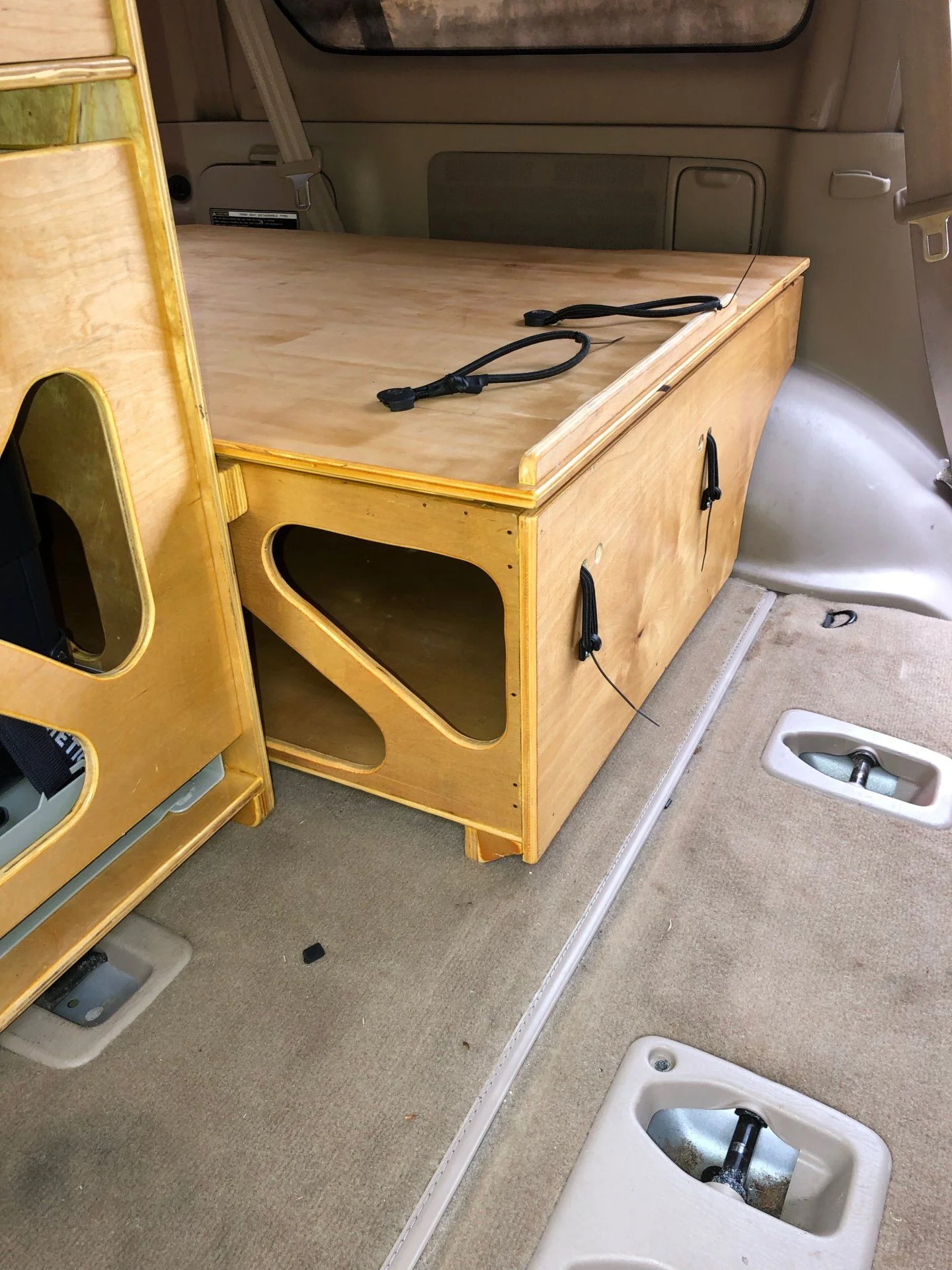

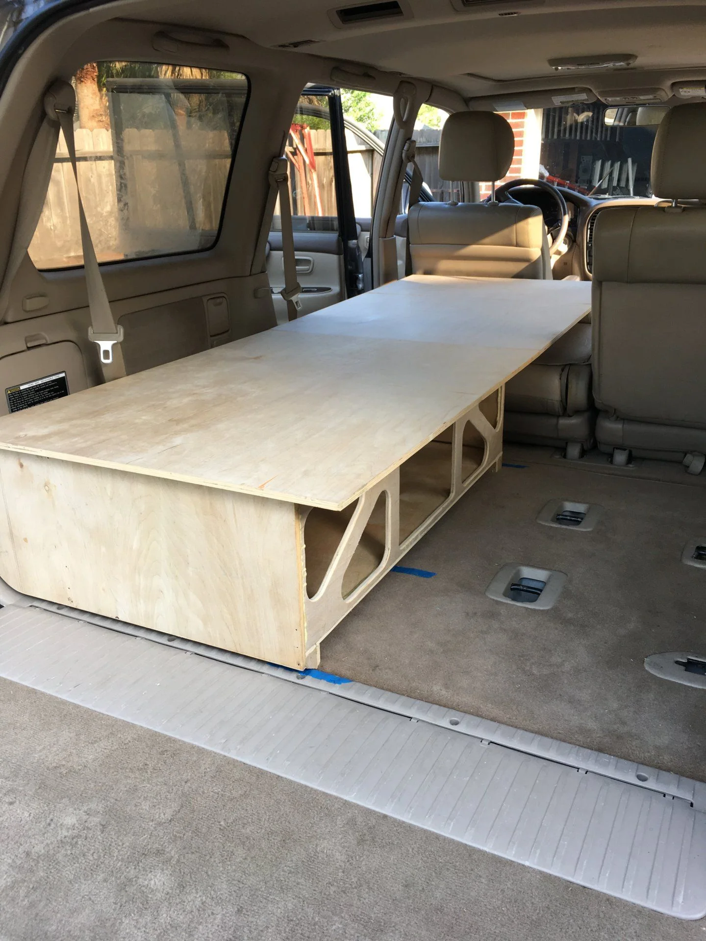

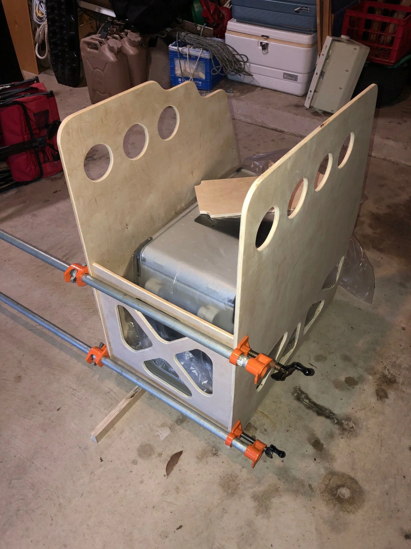

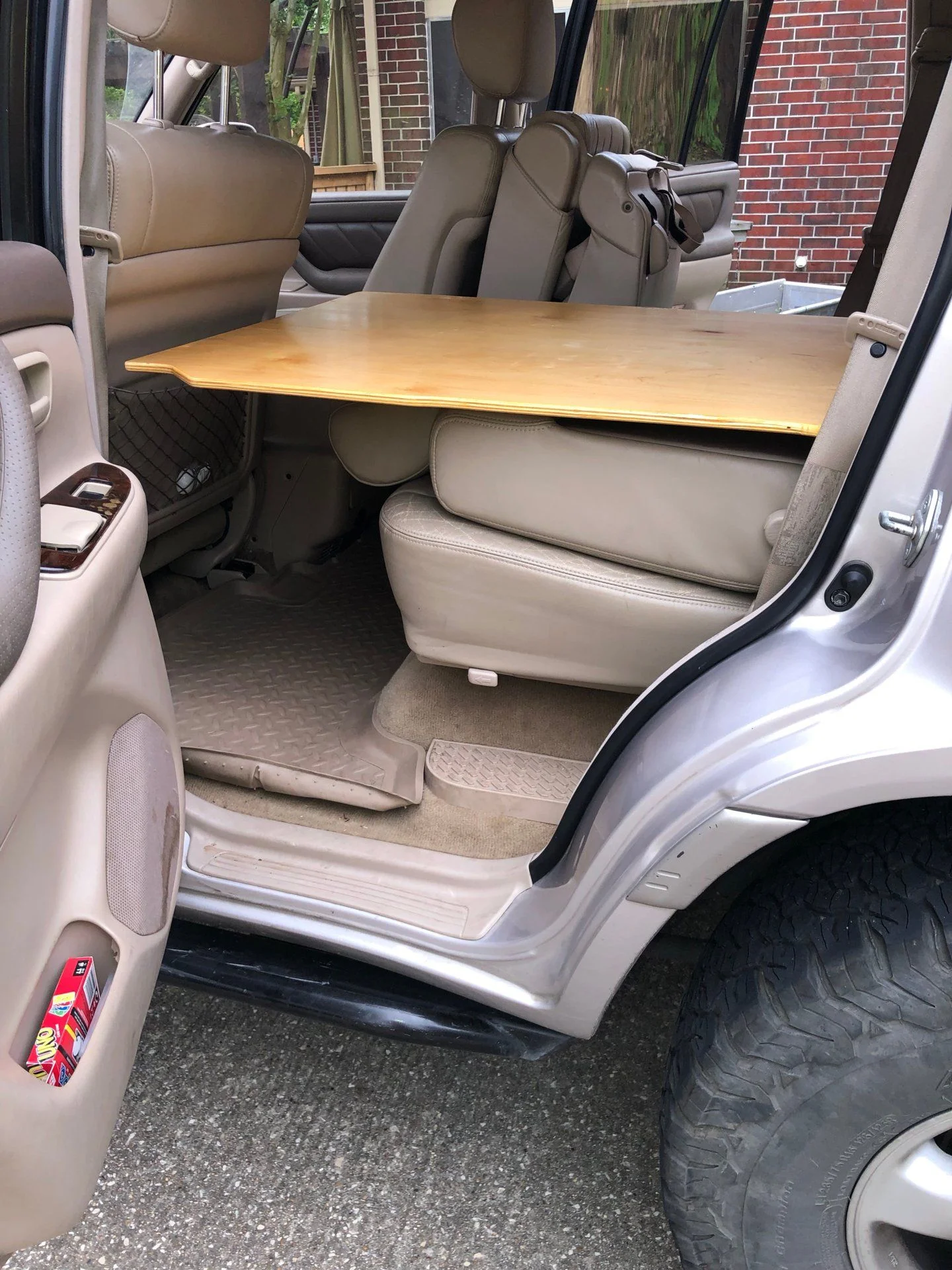

The sleeping platform started as just a mock-up. I had read numerous post on other solutions but they seemed to permanent (heavy / hard to remove). I wanted something that would just go in an out of the truck as needed. My idea was to start with cardboard templates and then transfer to a sheet of 15/32" cheap plywood ($20 per sheet). I did that. However it came out good enough that I plan to use this for the next few years. I started with the sleeping platform one year and added the fridge/storage tower later. Here are a few pictures. I will follow with more construction details.
1945911

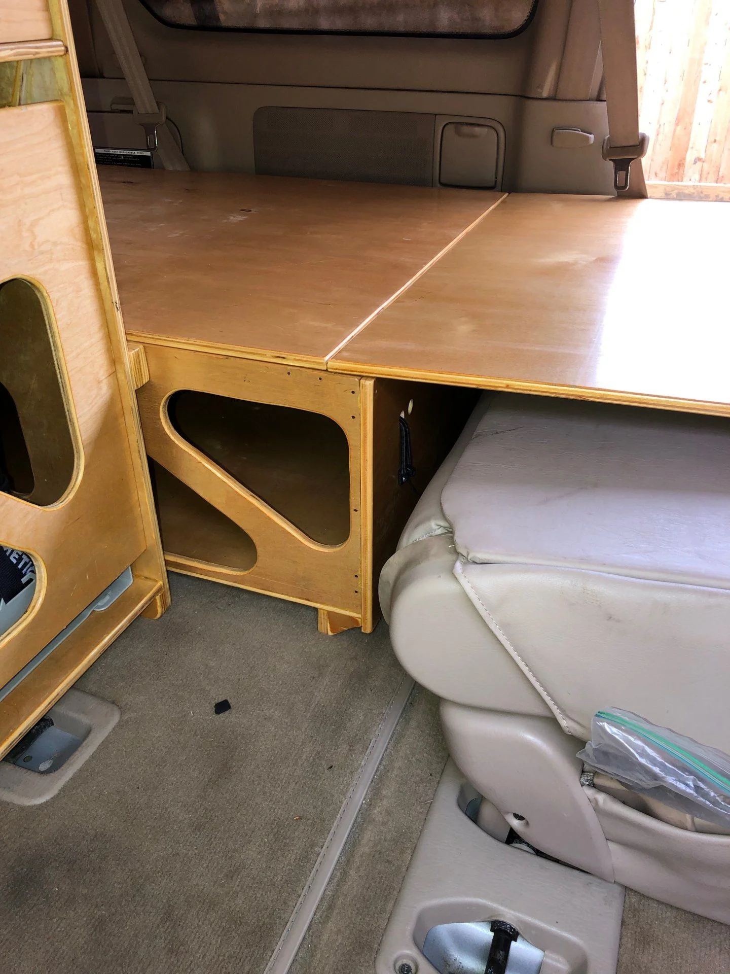

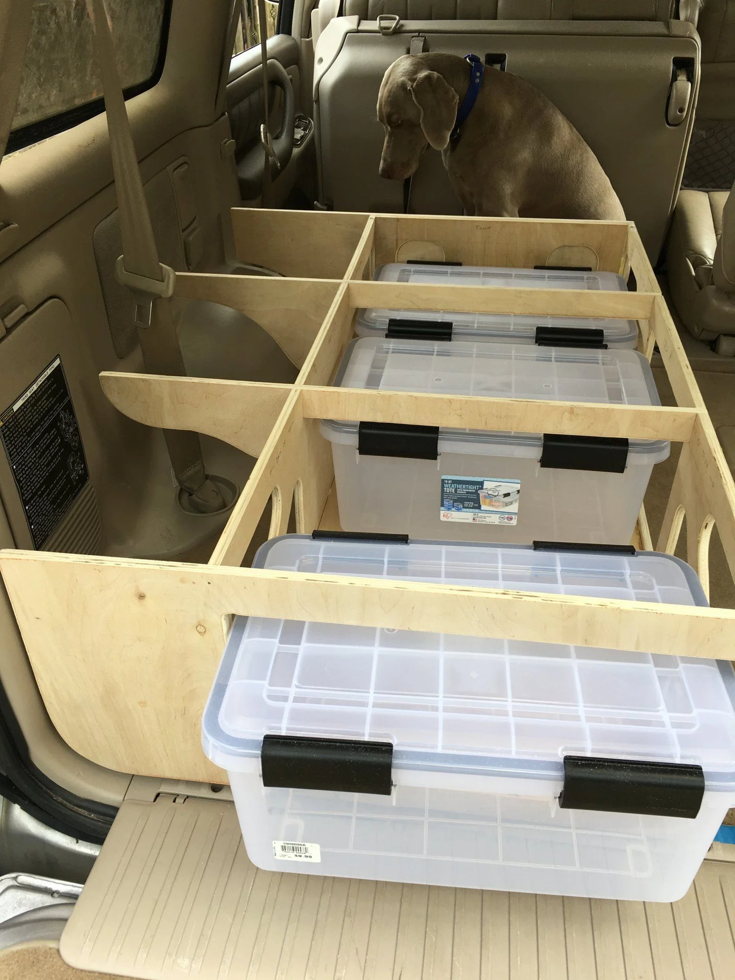

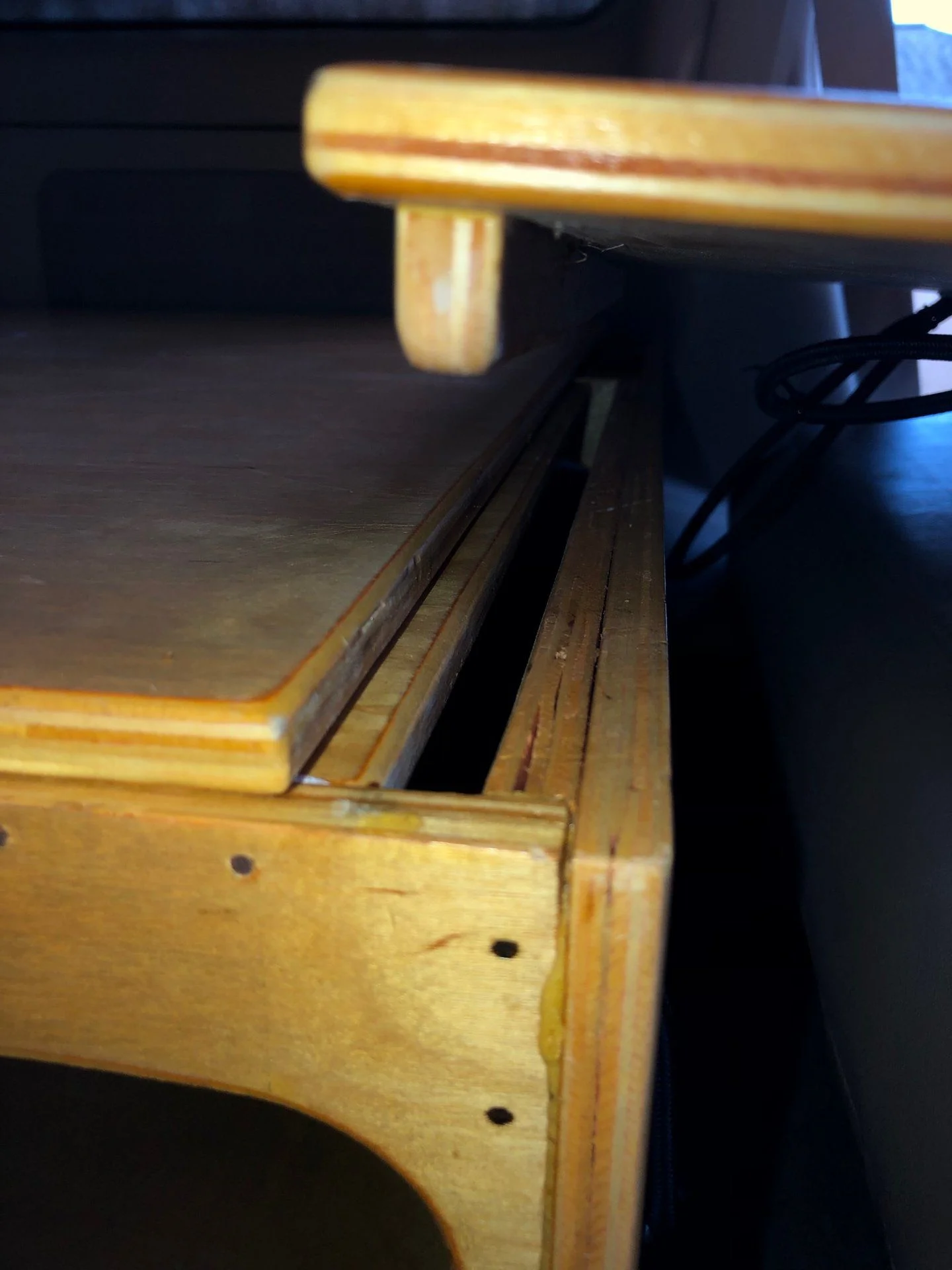

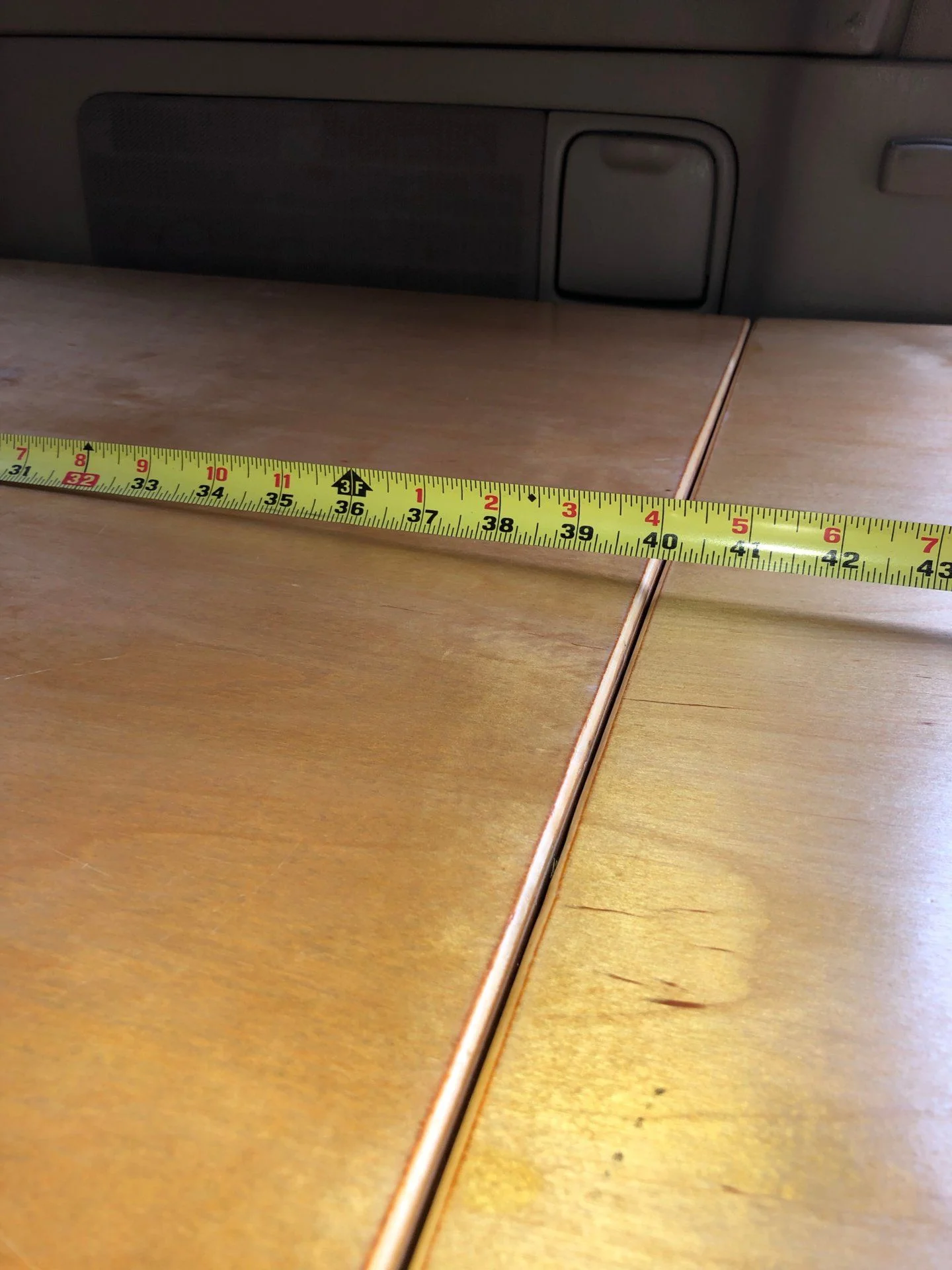

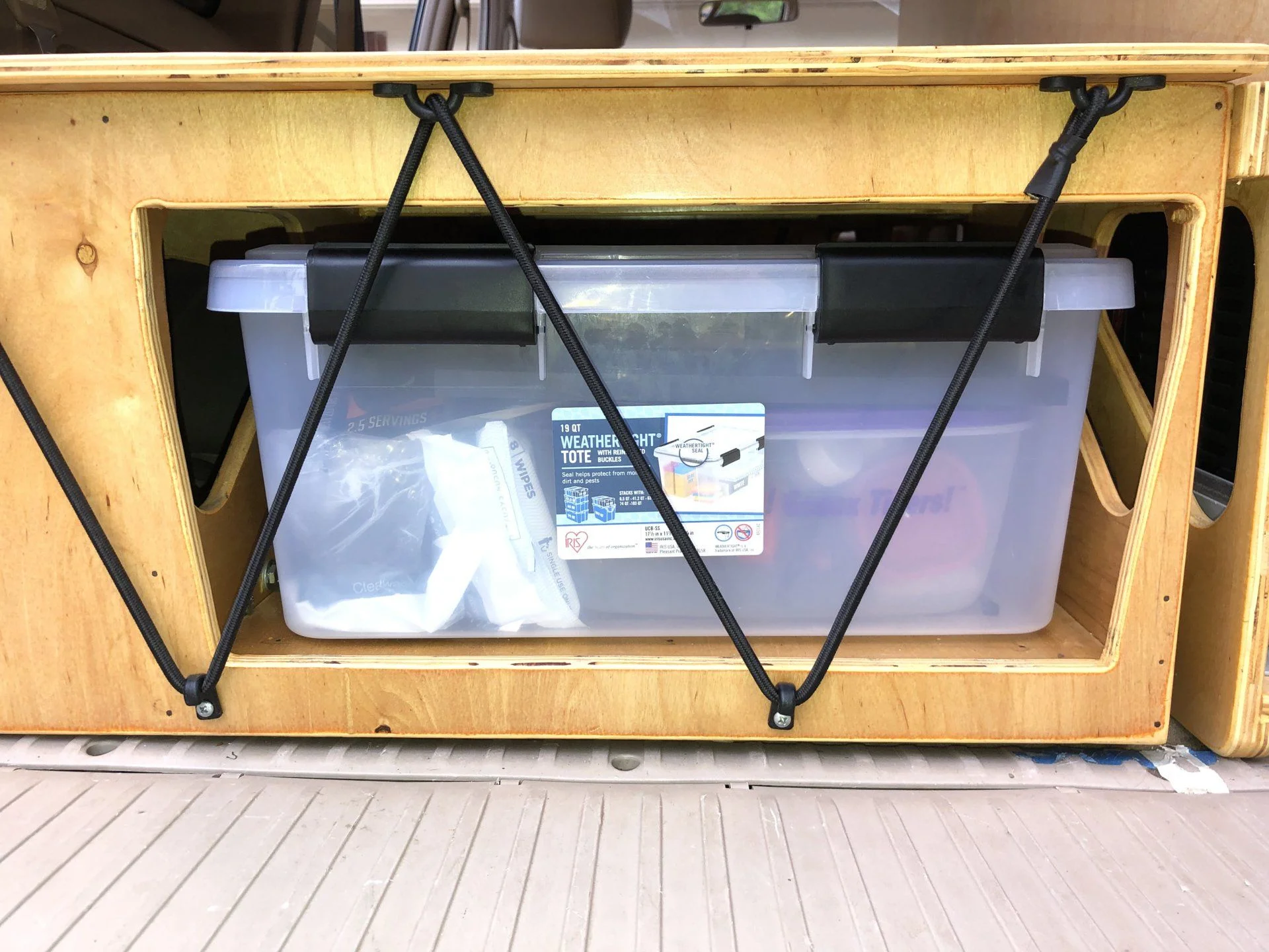

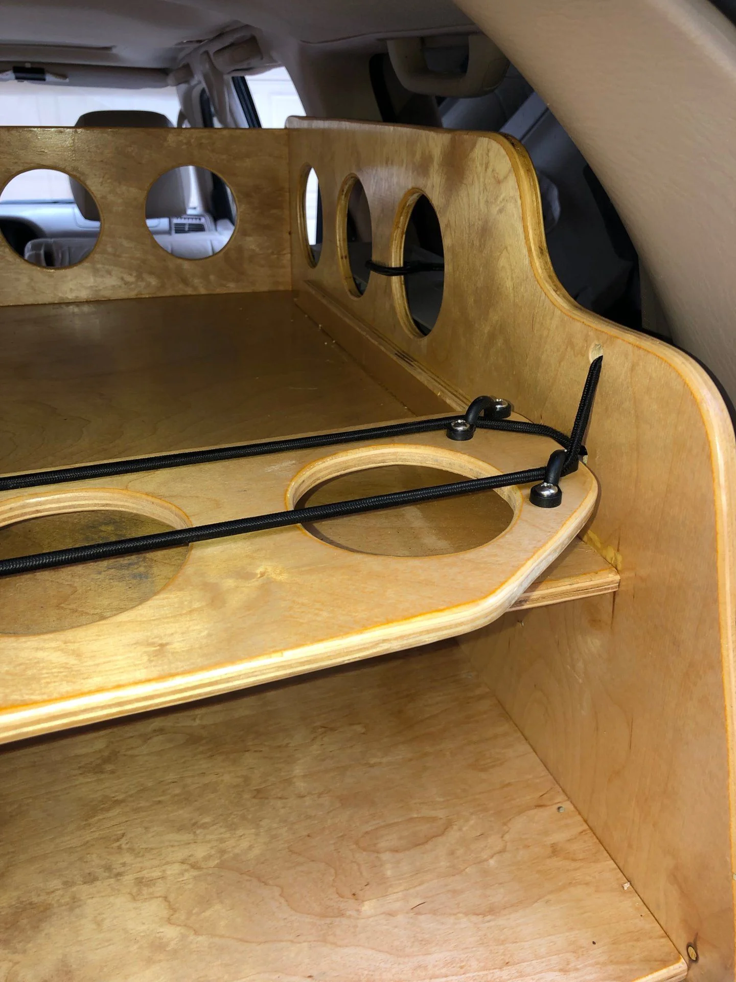

The sleeping platform was designed to hold three storage containers. The idea is to have these three boxes fully packed at all times. I am all about packing quickly. I also need to keep the bulk of my stuff inside. I am south of Houston and the humidity is off the chart. The space to the left of the boxes can be accessed by lifting the top of the platform. Seldom used items are stored there. The base platform is short enough to have the second row passenger seat usable at any time. A single sheet of plywood is then laid across the folded seat to make the full sleeping platform. You can see my goal was to make it as light as possible. I did this to make it easy to move/remove.

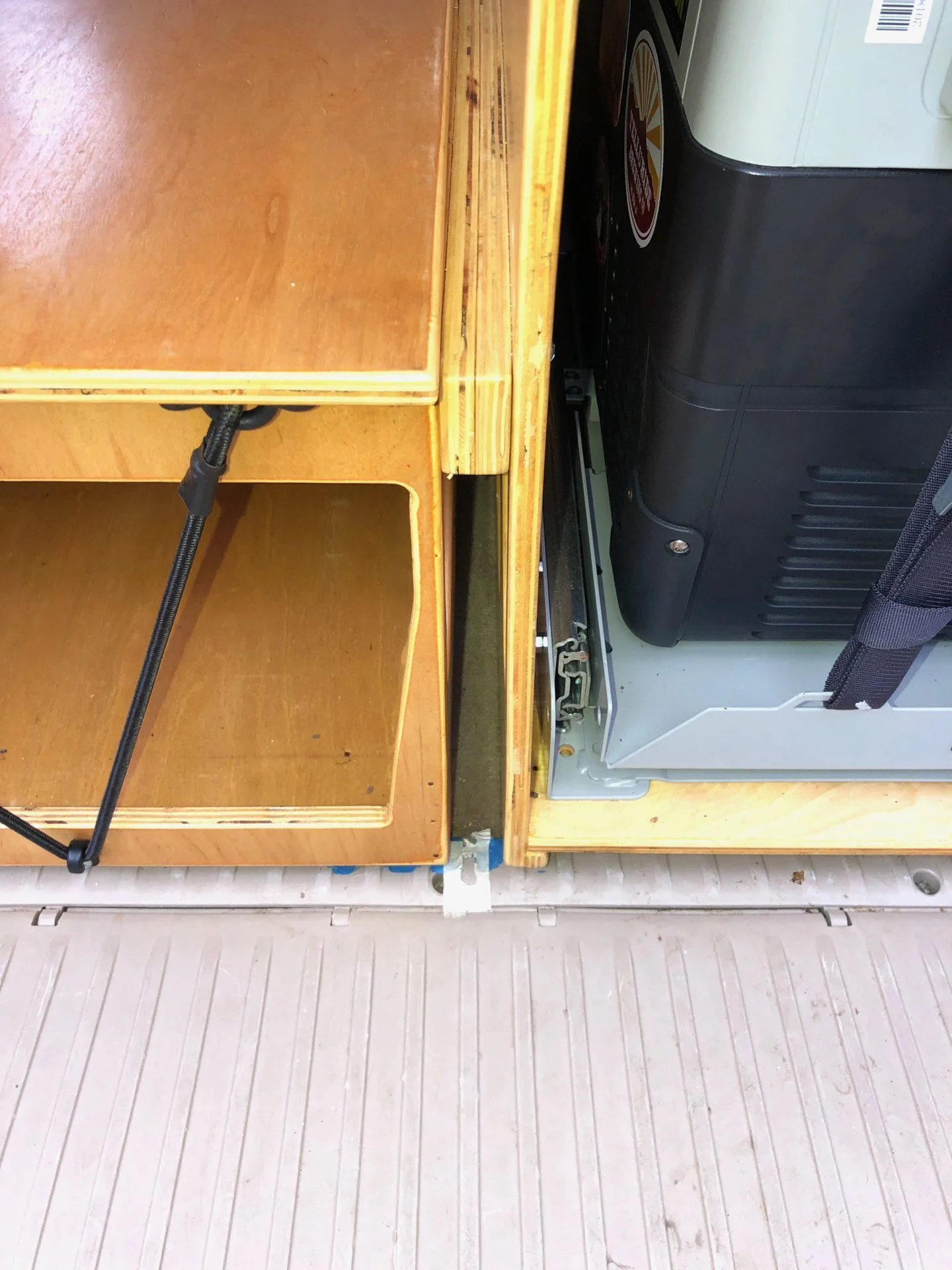

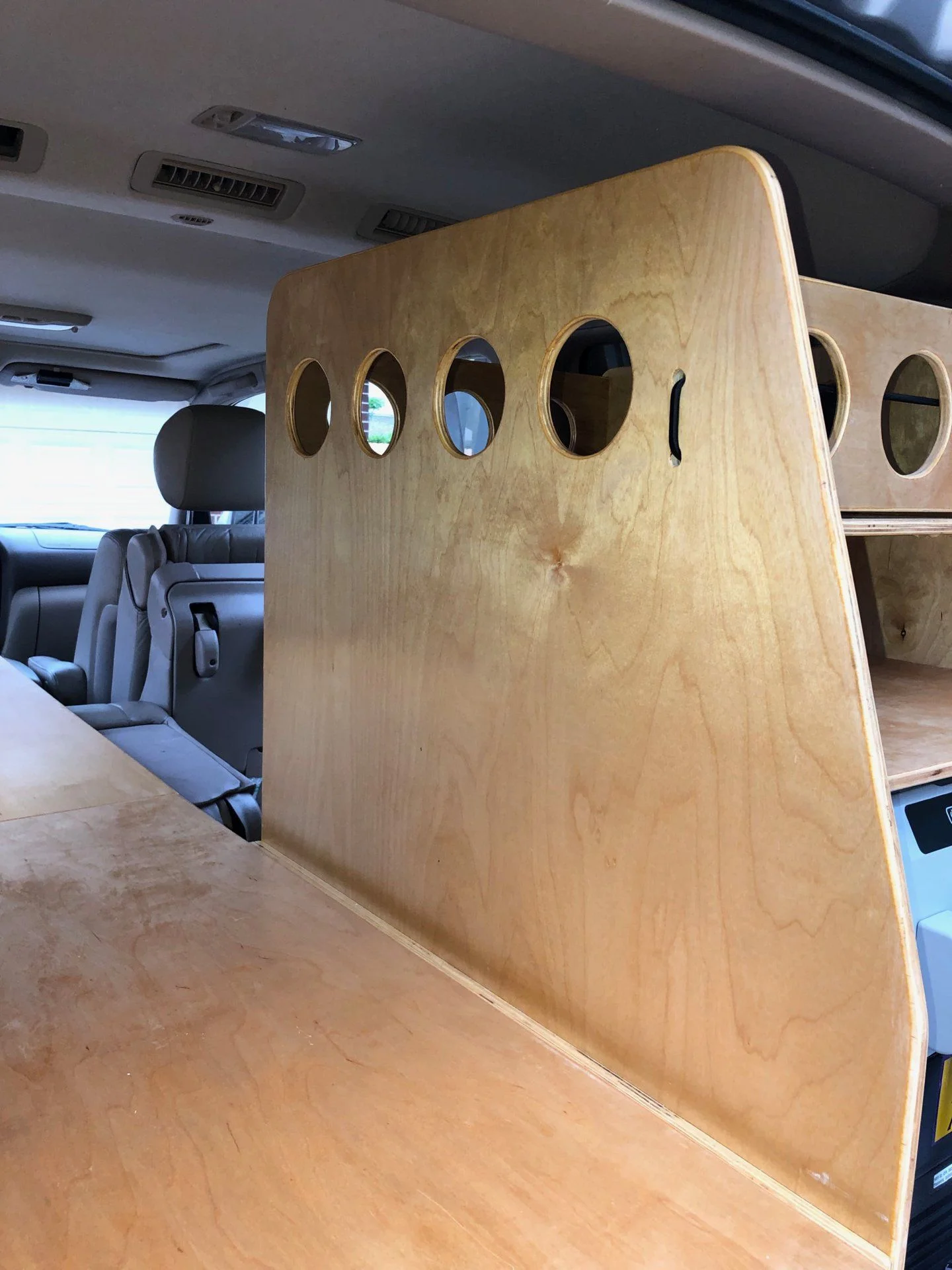

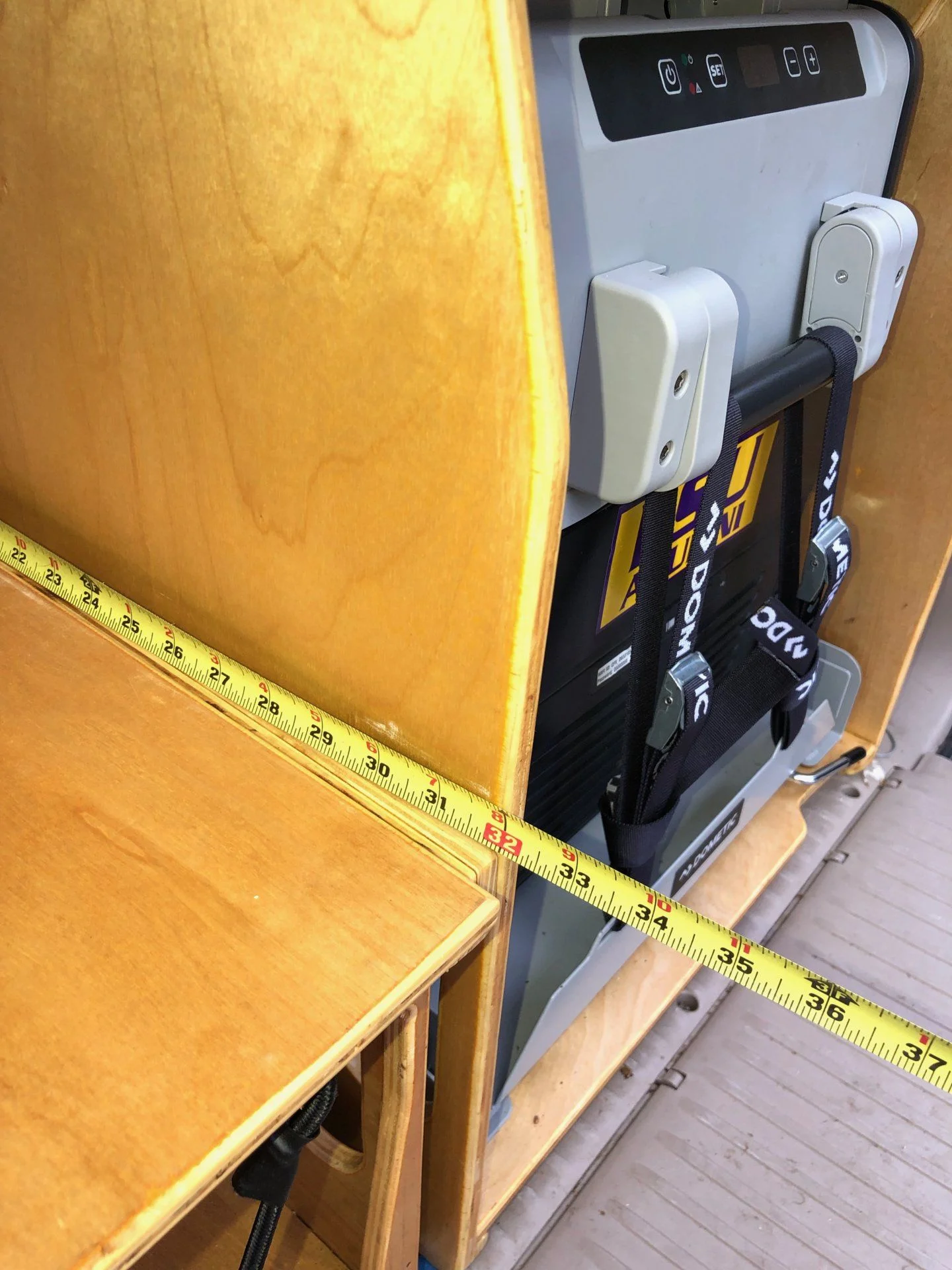

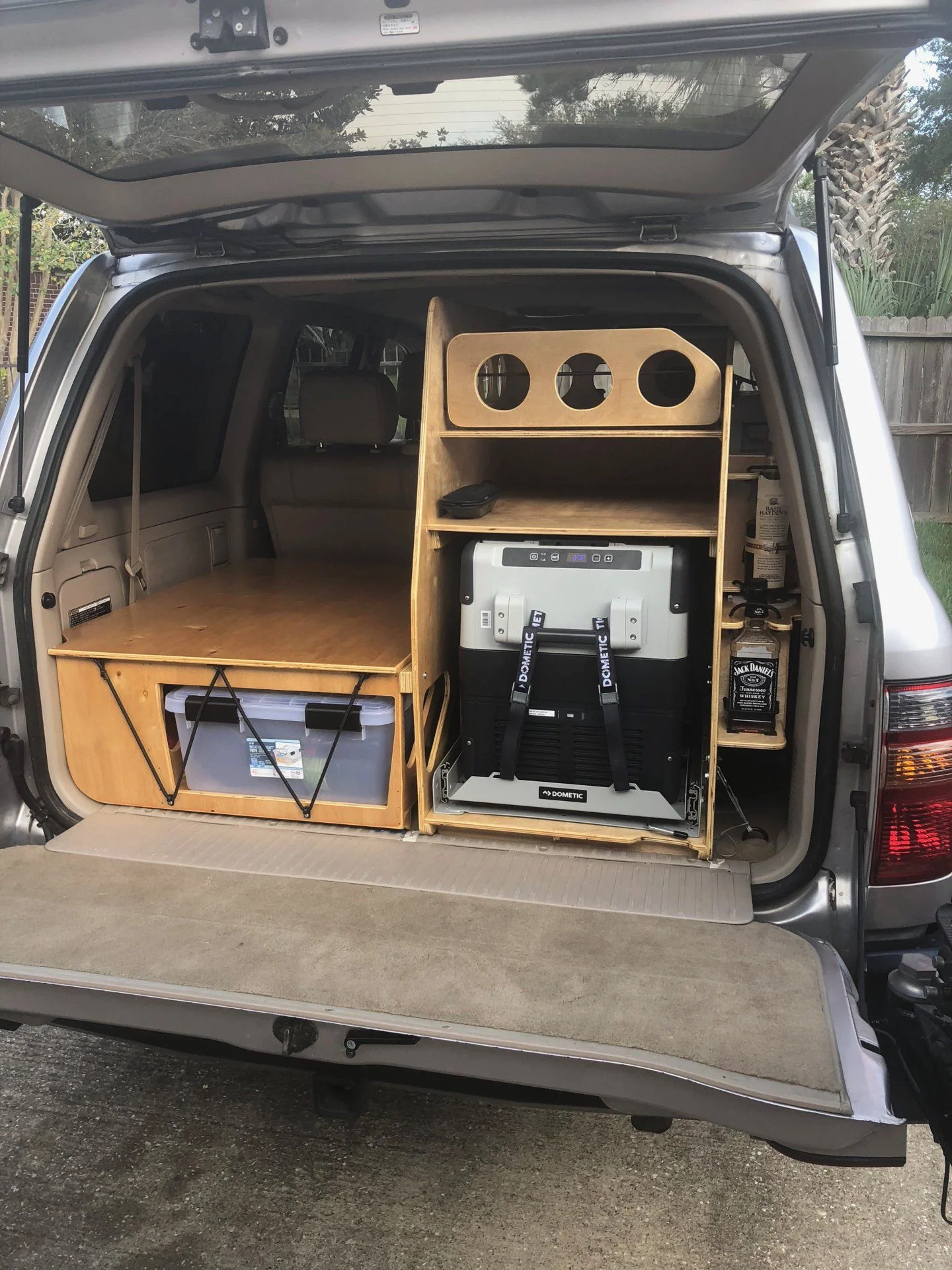

Here is the box the platform was designed around. The platform and storage tower divide the truck at the centerline and are connected with a piece of 3/4" stock and three bolts/Tnuts

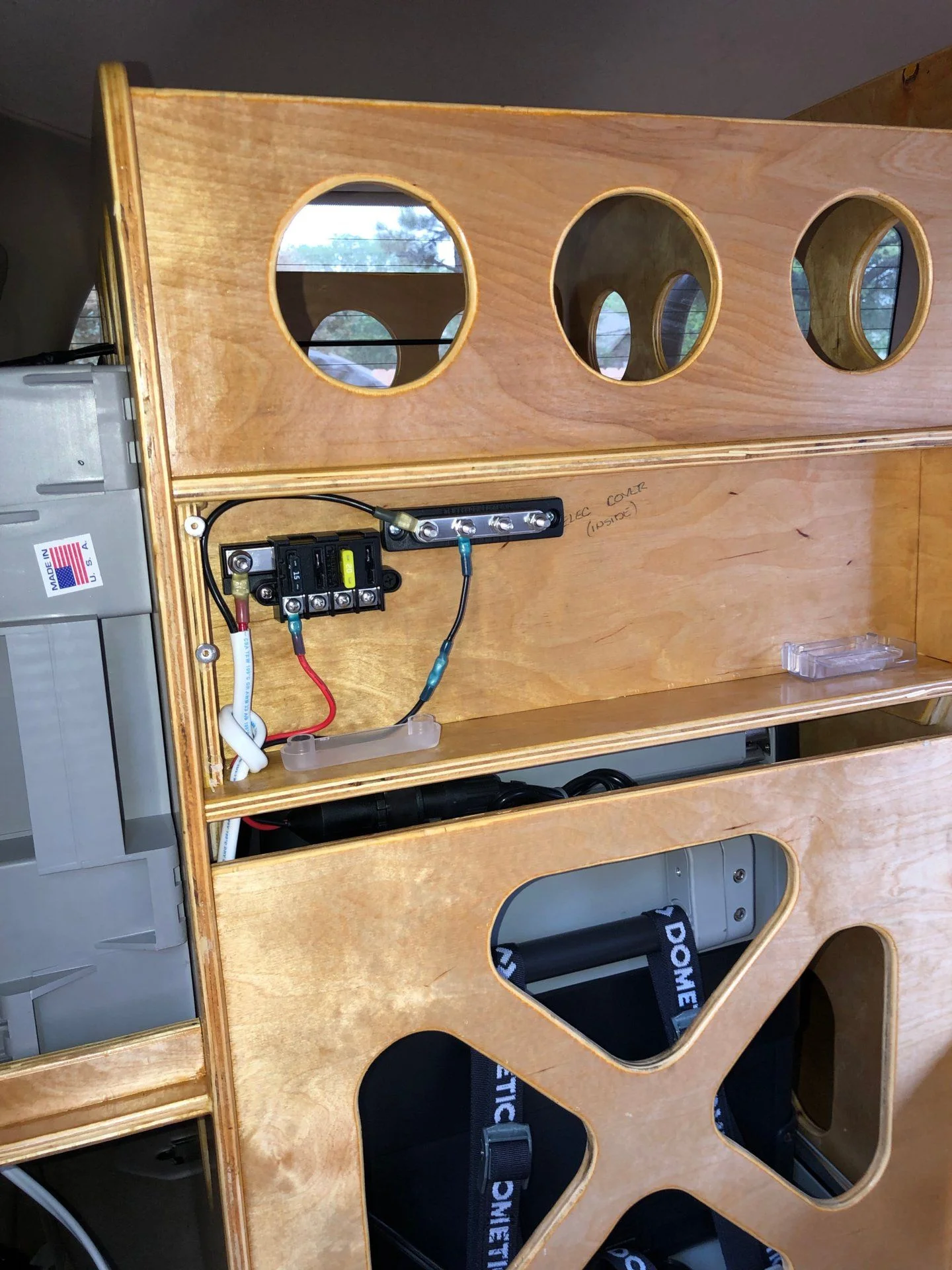

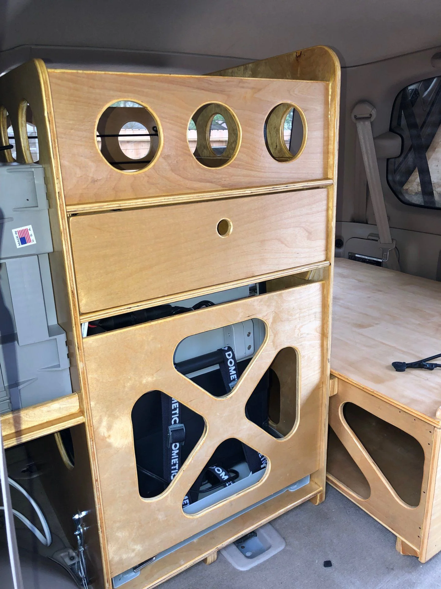

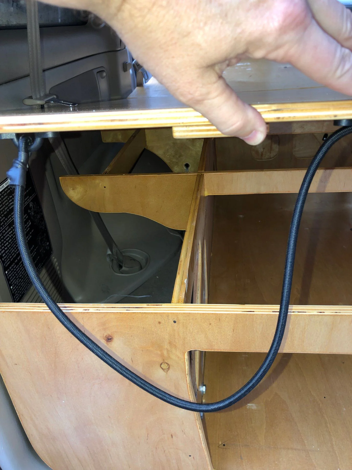

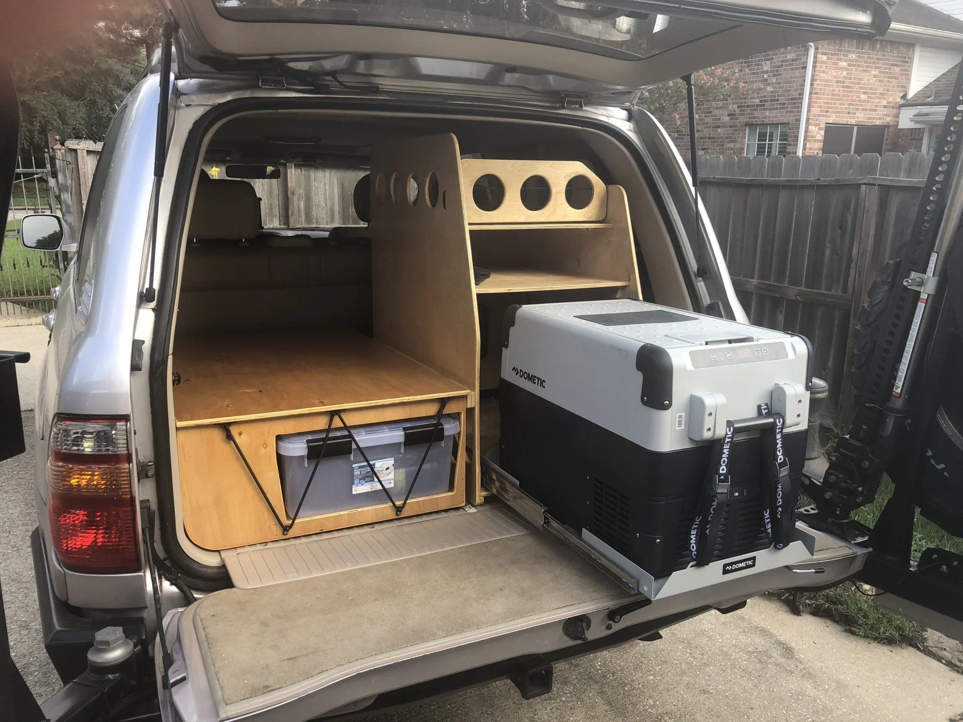

I have always hated dealing with ice. I also hate my bread, chips and other stuff floating around the truck and getting smashed. So I deigned a storage tower that would be powered off of my second battery. It has been pretty good. I have a space in the middle that I cannot decide if I am going to add a drawer. In the last two trips that has been where I keep all of my clothes. The tower was built as light as possible. All of the weight of the fridge slide and the fridge itself is carried on the floor of the tower. There for the tower carries no load. The entire unit is bolted to the sleeping platform and then lashed at the four corners with dynema twine. This has worked well.
It survived Black Bear pass last year and never moved around. When I got to Telluride I notice that I had not even noticed all of this in the back of the rig. Good enough for me.
